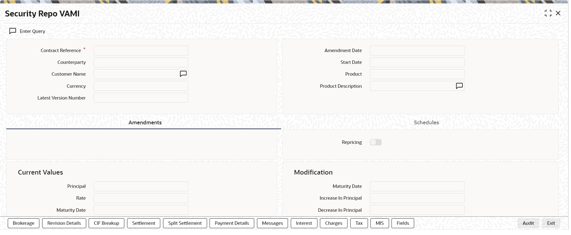

- On Homescreen, specify SRDXVMND in the text box, and click the next arrow.
Security Repo Vami screen is displayed.
- On the Security Repo VAMI screen, specify the details as required.

Current Values Specify the Current Values.
Principal
The Principal details are displayed.
Rate
The rate is displayed.
Modification Specify the modification details.

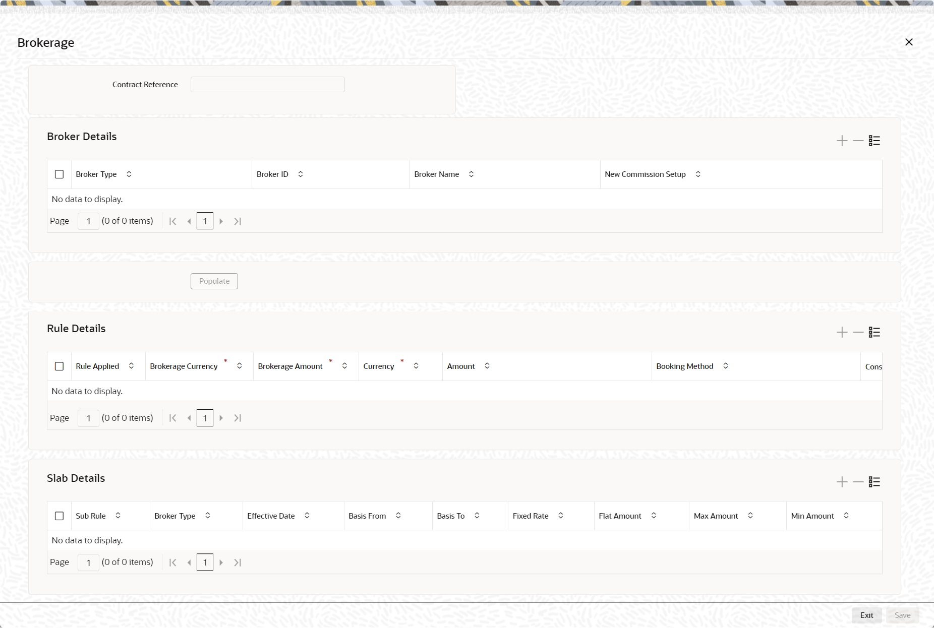

- On the Security Repo VAMI screen, click Brokerage.
The Brokerage screen is displayed.
- On Brokerage screen, specify the details as required.
For information on fields, see the section: Step 21. Brokerage

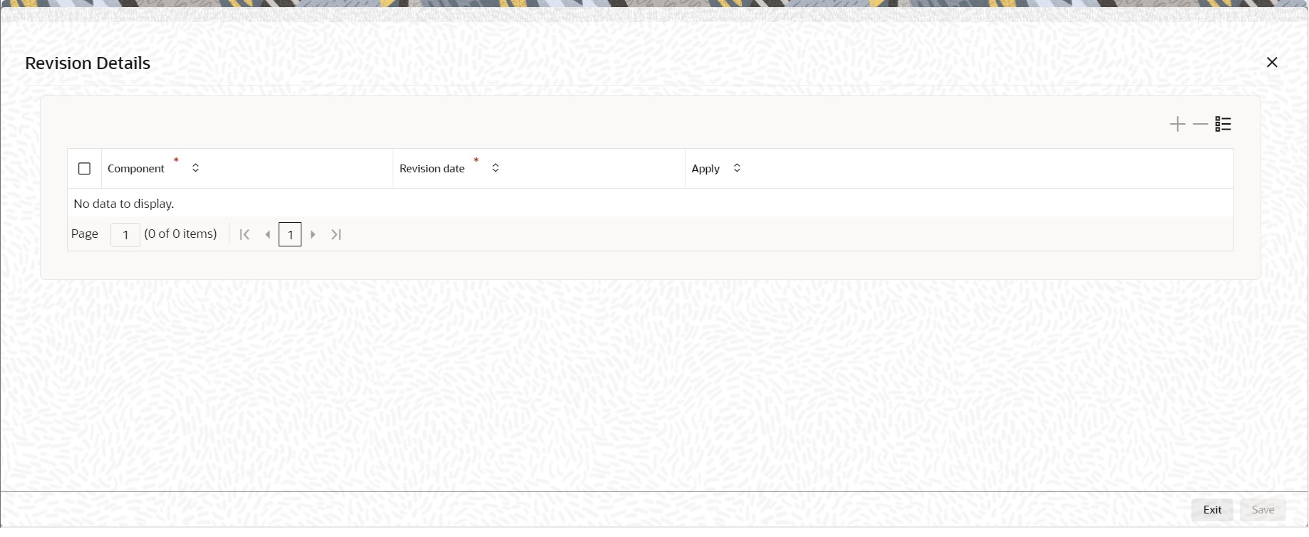

- On the Security Repo VAMI screen, click Revision Details.
Revision Schedule Details screen is displayed.
- On the Revision Schedule Details screen, specify the details as required.
For information on fields, see the below table:
Table 2-66 Revision Schedule Details - Field Description
Field Description Component
Displays Interest component
Revision Date
This is a mandatory field.
Displays Rate revision date
Apply
Displays whether revision is applied or not

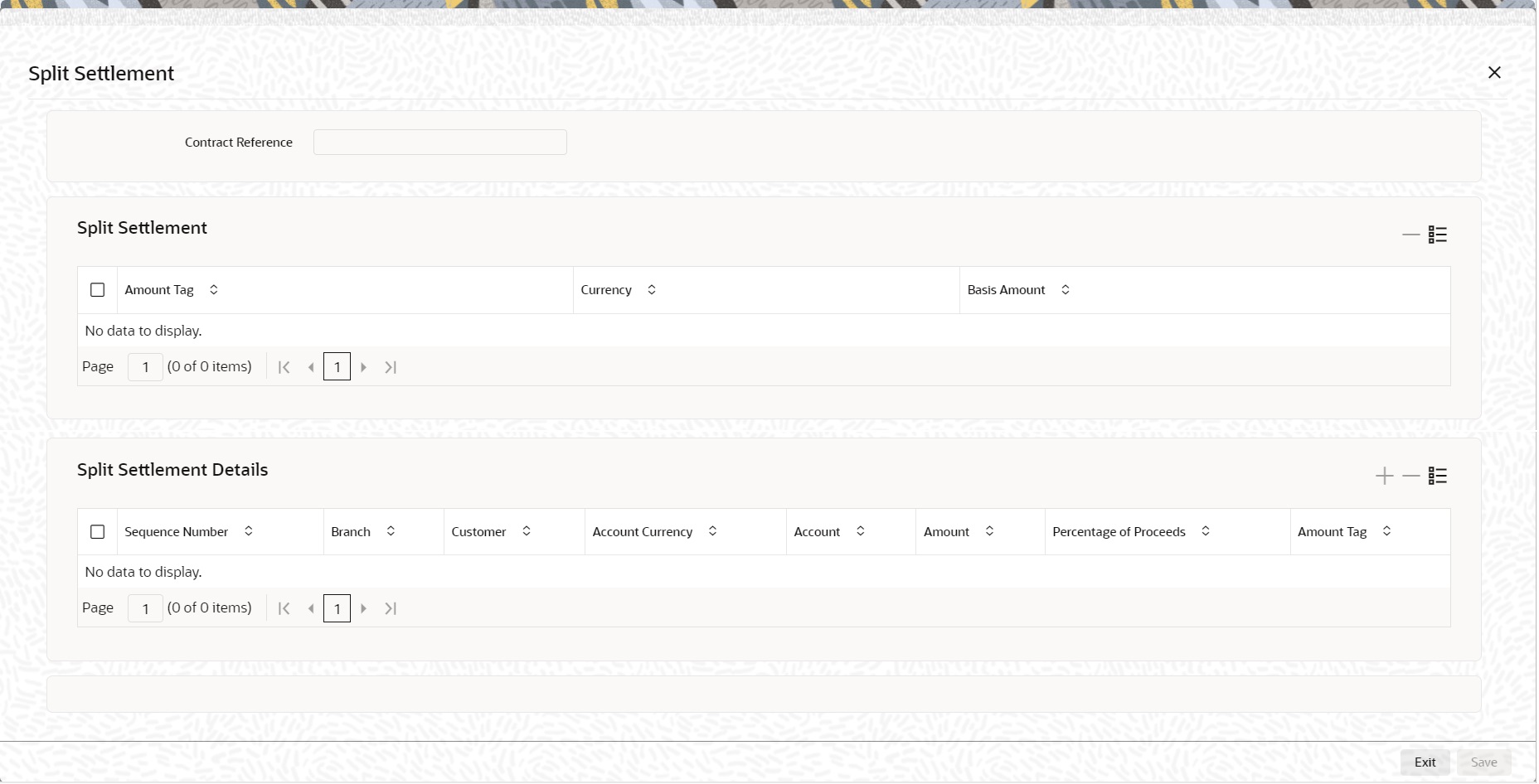

- On the Security Repo VAMI screen, click Split Settlement.
Split Settlement Screen is displayed.
- On the Split Settlement screen, specify the details as required.
- On the Split Settlement screen, select a contract.
- On the Split Settlement screen, under the Split Settlement Details, click the + Icon.
Split Settlement screen with New arrow is displayed.
Figure 2-70 Split Settlement with a new row added
Description of "Figure 2-70 Split Settlement with a new row added"Note:
This process of splitting the settlements for a contract is allowed on the principal, Interest (Anticipated Interest for new contracts), and charges. - On the Split Settlement screen, specify the details as required.

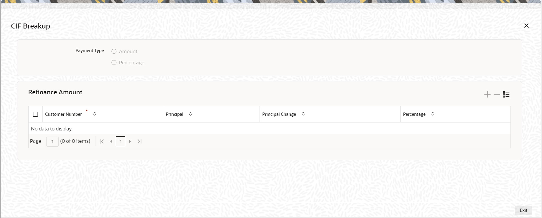

- On Security Repo VAMI screen click CIF Breakup.
The CIF Breakup screen is displayed.
- On CIF Breakup screen, specify the fields.
For more information on fields, see the below table:
Table 2-68 CIF Breakup - Field Description
Field Description Payment Type
Displays the payment type
Customer Number
Displays the customer number
Principal
Displays the principal amount
Principal Change
Displays the principal change
Percentage
Displays the percentage

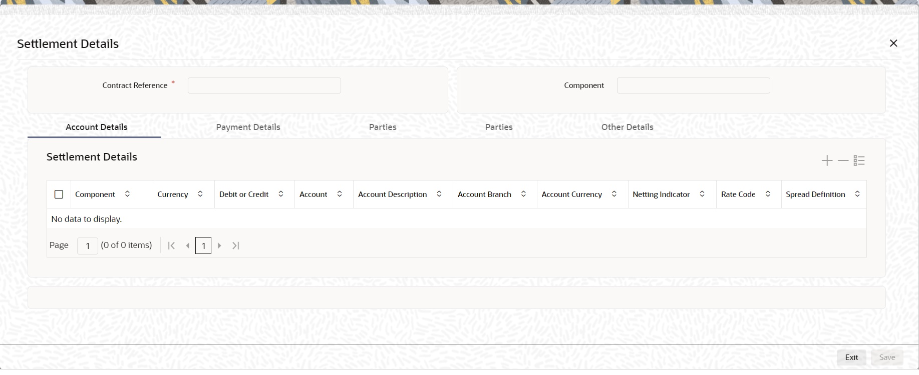

- On Security Repo VAMI screen click Settlement.
The Settlement screen is displayed.
- On the Settlement Details screen, specify the details as required.
For information on fields, refer to the Settlement User Guide.
- On the Security Repo Vami Screen, click Payment Details.
Table 2-69 Settlement - Field Description
Displays Component details
Due Date
Displays Payment due date
Amount Due
Displays Payment Due amount
Amount Settled
Displays Payment amount which is already settled
Amount Adjusted
Displays Adjustment amount

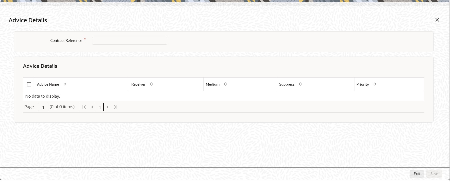

- On the Security Repo Vami Screen, click Messages
Advice Details screen is displayed.
- On the Advice Details screen, specify the details as required.
Table 2-70 Advice Details - Field Description
Field Description Contract Reference
Displays Contract reference number
Advice Name
Displays the Advice name applicable for the contract
Receiver
Displays the Receiver ID
Medium
Displays the Message medium
Suppress
Displays whether message must be suppressed or not
Priority
Displays the message priority

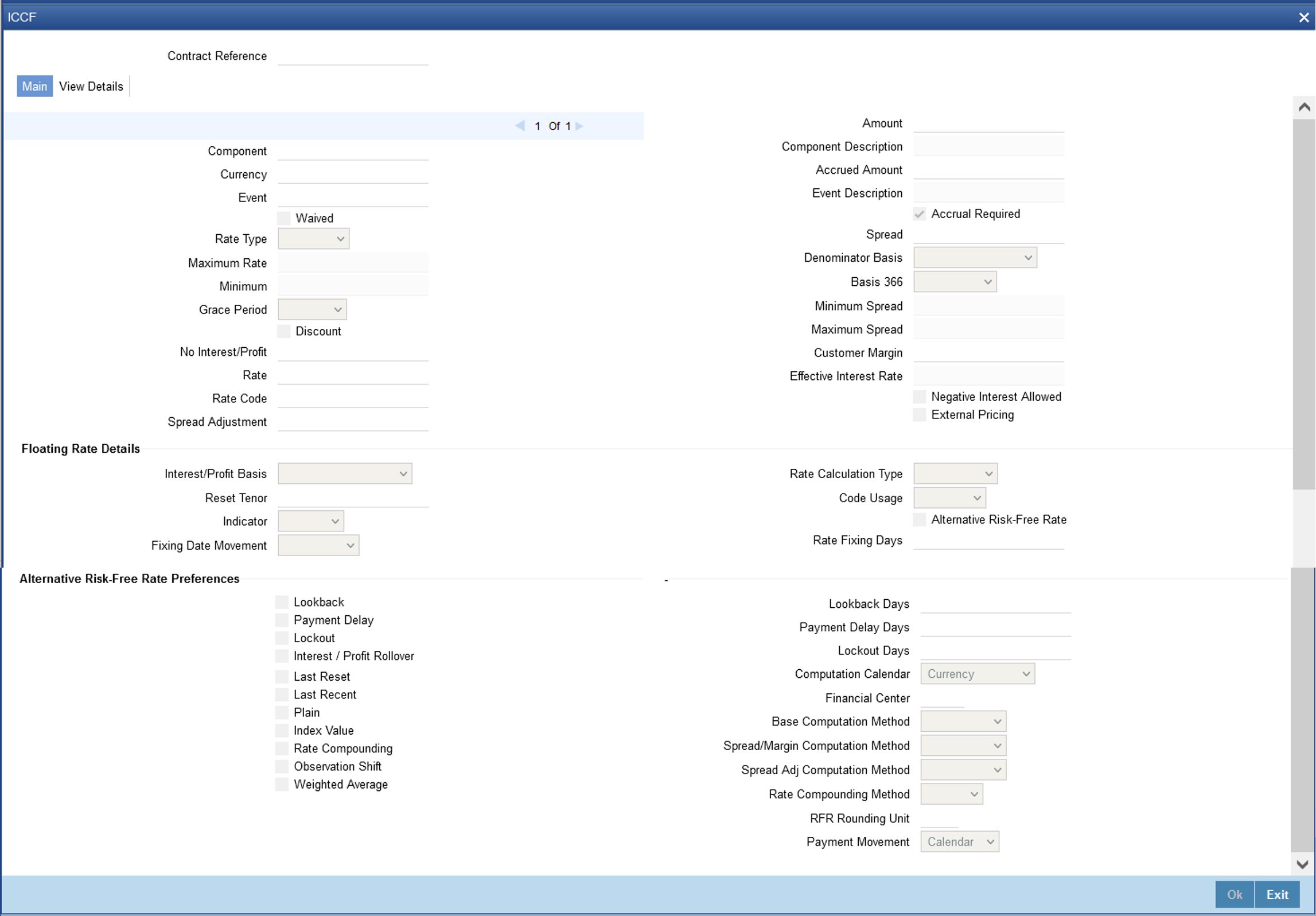

- On Security Repo VAMI screen, click Interest.
ICCF screen is displayed.
- On Interest Details screen, specify the fields.
Table 2-71 Interest Details - Field Description
Field Description Interest Basis
The method in which the number of days are to be calculated for interest, charge, commission or fee components and whether their application is tenor based is displayed here based on the specification the user made at the product level. The user can choose to change it. The following are the options available:
- 30(Euro)/360
- 30(US)/ 360
- Actual/360
- 30(Euro)/365
- 30(US)/365
- Actual/365
- 30(Euro)/Actual
- 30(US)/Actual
- Actual/Actual
- 30(Euro)/364
- 30(US)/ 364
- Actual/364
Fixing Date Movement
Select the movements from the drop-down list.
The available movements are:- Forward
- Backward
- None
Rate Fixing Days
Specified the rate fixing days, If rate fixing days is greater than zero, movement is selected either as forward or backward. If rate fixing days is zero, then fixing date movement will remain blank.
- The system performs the following validations:
- It allows you to amend the interest rate from main interest component only.
- Based on whether effective interest rate is positive or negative, the system assigns the rate to main component/negative component.
- Back dated amendments are allowed with value date as last payment/amendment date whichever is later.

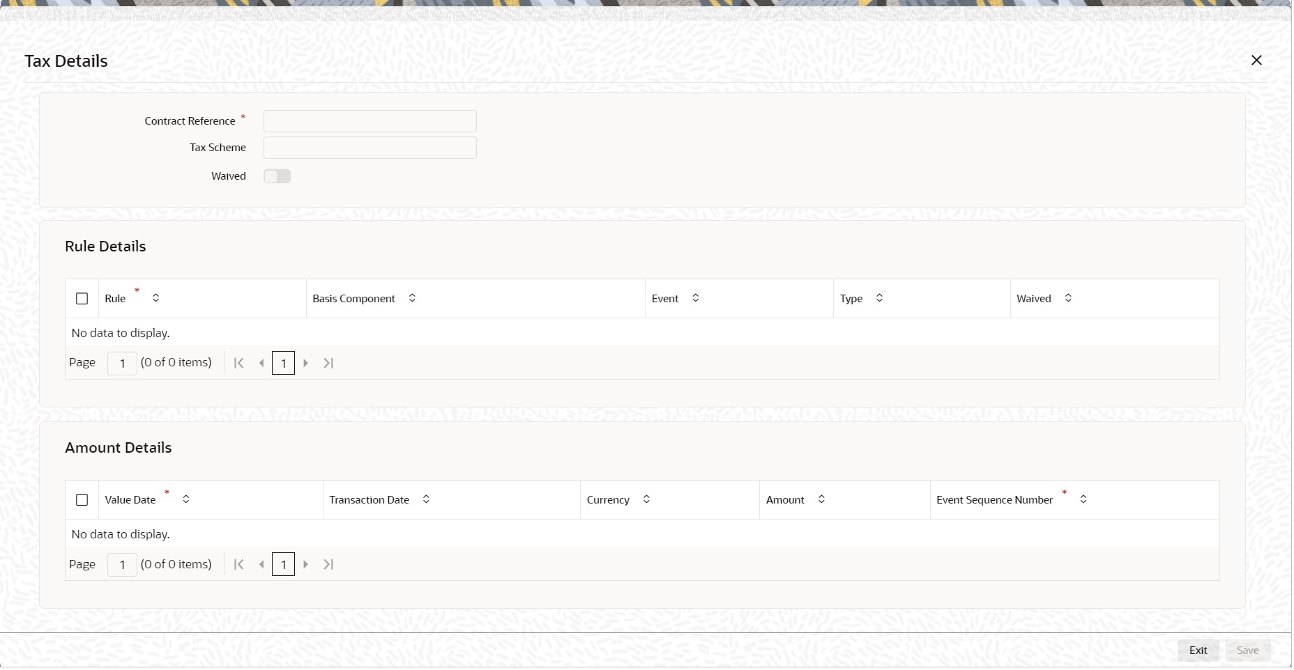

- On the Securities Repo VAMI screen, click Tax.
The Tax Details screen is displayed.
Figure 2-77 Tax Details
Description of the illustration srdtronl__cvs_tax.png - On the Tax Details screen, specify the details as required.
For information on fields, refer to: Step 31. Tax
