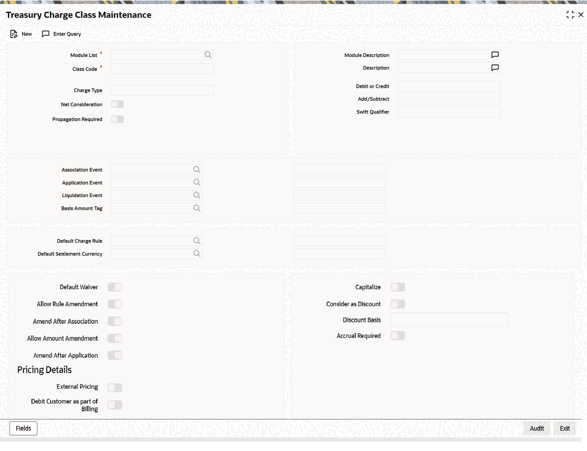

1.3.1 Define a Charge Class
This topic provides the systematic instructions to define a charge class.
Once such a rule is built, you can define attributes like what should be the basis amount on which the charge rule is applied, when the charge should be associated to the contract and when the charge should be calculated and collected. A class is a specific type of component that you can build with certain attributes. You can build a charge class, for instance, with the attributes of a specific type of charge, such as ‘Charges for amending the terms of a transaction’, or ‘Charges for provision of services’. To recall, a charge rule is built to calculate a specific type of charge component.
  1. On the Homepage, enter CFDTRCCM in the text field and then click the next arrow.
    The Treasury Charge Class Maintenance screen is displayed.
    Figure 1-3 Treasury Charge Class Maintenance
    Description of Figure 1-3 follows
    Description of "Figure 1-3 Treasury Charge Class Maintenance"
  2. On the Treasury Charge Class Maintenance screen, specify the fields.
    For field details and description, refer to the below table.
    Table 1-4 Field Description
