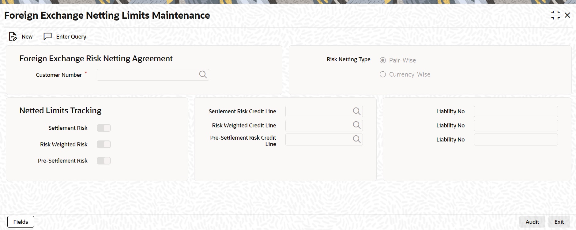

2.7.3.1 Foreign Exchange Netting Limits Maintenance
Track the limit using the Foreign Exchange Netting Limits Maintenance screen.
  1. On the Home page, type FXDLMNET in the text box, and click next arrow.
    The Foreign Exchange Netting Limits Maintenance screen is displayed.
    Figure 2-9 Foreign Exchange Netting Limits Maintenance Description of fxdlmnet__cvs_main.png follows
  2. On the Foreign Exchange Netting Agreement Maintenance screen, click New.
  3. On the Foreign Exchange Netting Agreement Maintenance - New screen, specify the details as required.
  4. Click Save to save the details OR Cancel to close the screen.
