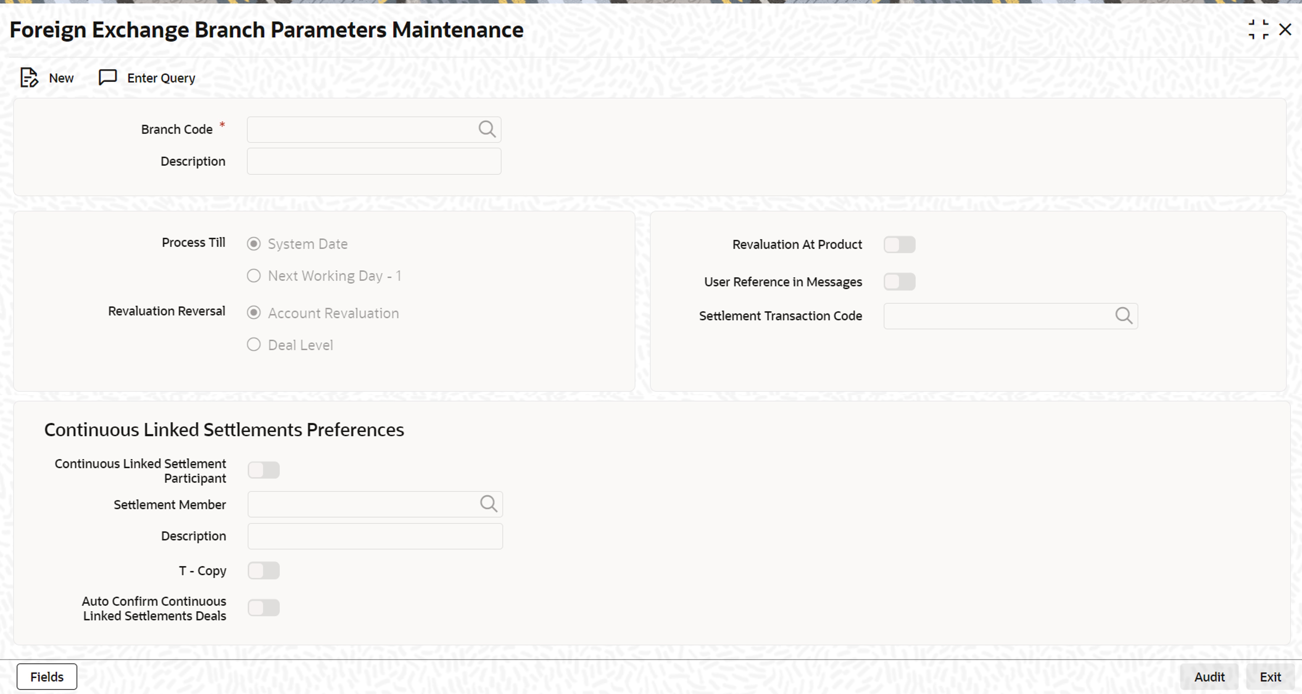

- On the Homepage, type FXDBRMNT  in the text box, and click the next arrow.Foreign Exchange Branch Parameters Maintenance screen is displayed. Figure 6-1 Foreign Exchange Branch Parameters Maintenance
- On the Foreign Exchange Branch Parameters Maintenance screen, specify the details as required.The branch code, with the name of the branch for which the preferences are maintained, is defaulted in the screen. For information on fields, refer to the below table. Table 6-1 Foreign Exchange Branch Parameters Maintenance - Field Description Field Description Branch Code Specify the branch code. Alternatively, you can select the branch code from the option list. The list displays all valid options. Branch Description The system displays the branch description. Process Till Select the date up to which FX deals are processed in the branch. The options are: - System Date
