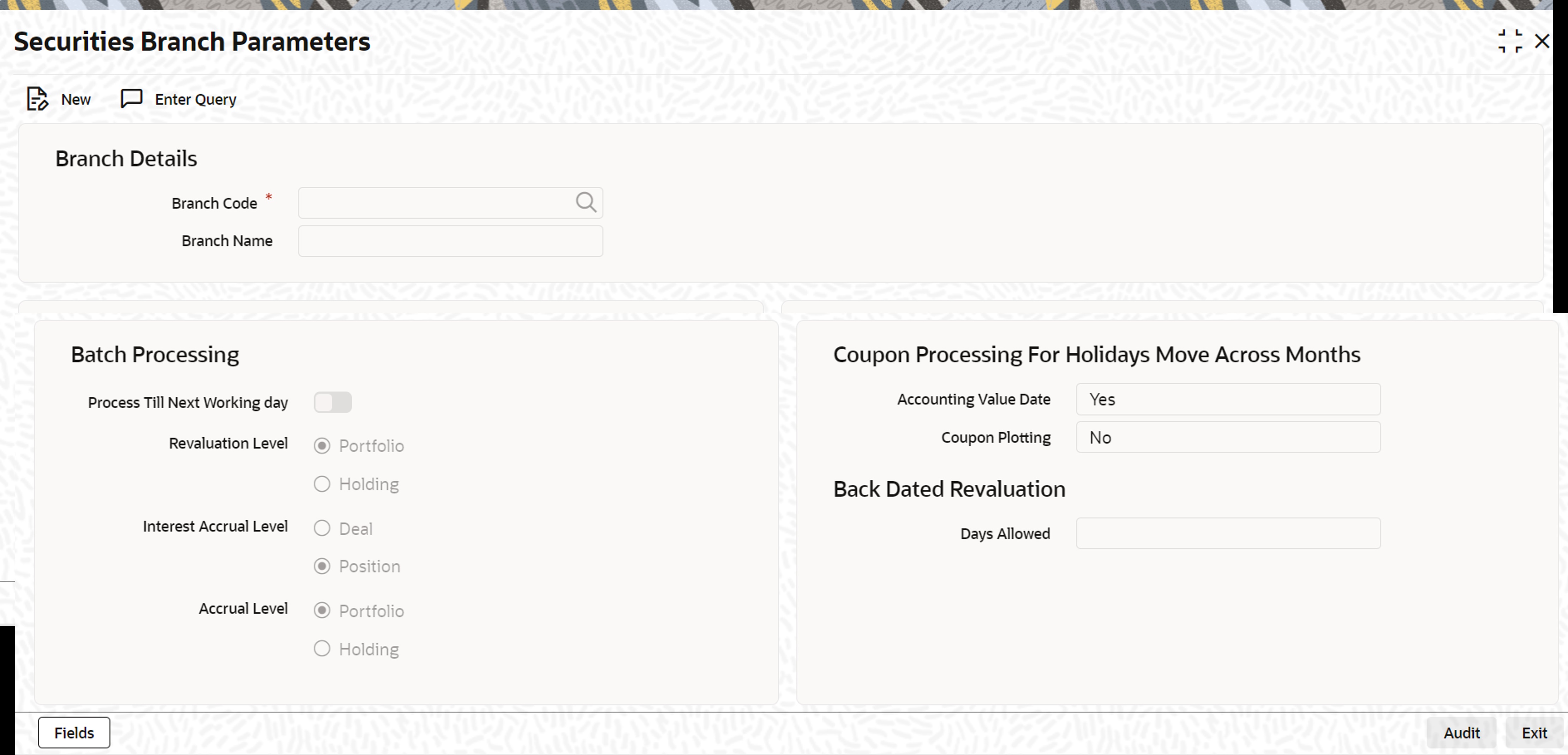

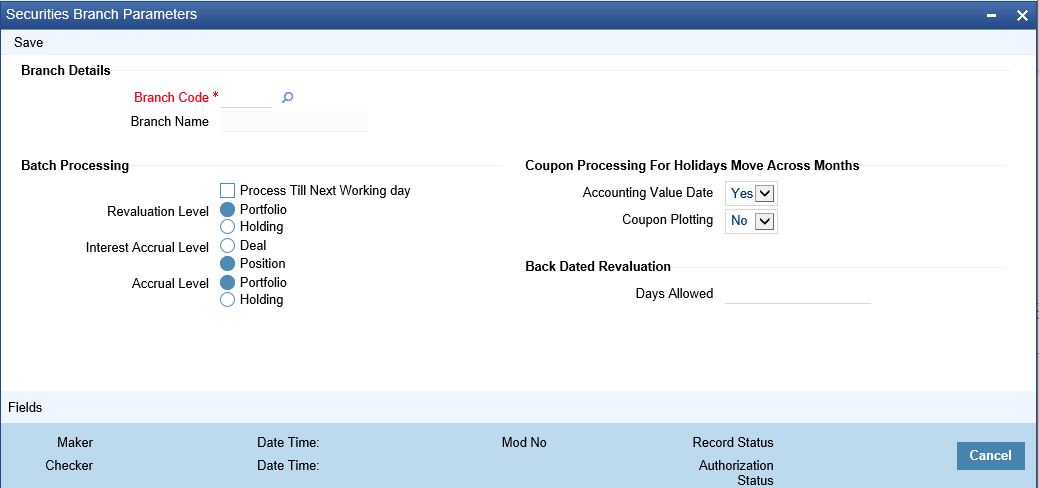

- On the Home page, specify SEDXBRPM in the text box, and click the arrow next t.
The Securities Branch Parameters screen is displayed.
 - On the Securities Branch Parameters screen and specify the fields.
For more information on fields, refer to the below table.
