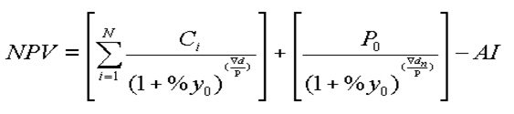

If the revaluation method for unrealized revaluation is set to ‘MTM-EIM’, the unrealized revaluation for the unsettled buy and sell deals will be done as of the revaluation date. The revaluation date is actually the Processing Date + Spot Days (this is arrived on the basis of the market for revaluation defined in the Security Online screen).
Revaluation profit/loss is found out per unit of security and scaled up to find out the profit/loss for the deal quantity. The coupon cash flows and the forward price between the revaluation date and the deal settlement date is discounted to the revaluation date. The YTM with effective date of the deal settlement date is used to compute the net present value.
The interest accrued for the period between the coupon date or the security start date and the revaluation date is excluded from the NPV obtained and the clean price is obtained. The NPV is computed on the basis of the following formula:
Case 1 – Revaluation Date <= Deal Settlement Date
Where,
Table 28-2 Values
| Term | Definition |
N |
Total number of Coupon cash flows between the deal settlement date and the revaluation date. |
Ci |
ith coupon |
y0 |
Periodic Deal YTM |
„¤d |
Coupon Date – Revaluation Date |
pi |
Reinvestment Period |
Ci |
Forward Flat Purchase Price |
Ci |
Deal Settlement Date – Revaluation Date |
Ci |
Accrued Interest as of the revaluation date |
Case 2 – CUM Deal or Revaluation date and settlement date are in different coupon periods
Table 28-3 Case 2 tables
| NPV | Net Present Value of the deal |
N |
Total number of Coupons between the revaluation date and the Redemption date excluding the first cash flow from the deal settlement date. |
Ci |
with coupon |
y0 |
Periodic Deal YTM |
Ñd |
P |
RP |
Redemption Price |
Ñdn |
Redemption Date – Revaluation Date |
AI |
