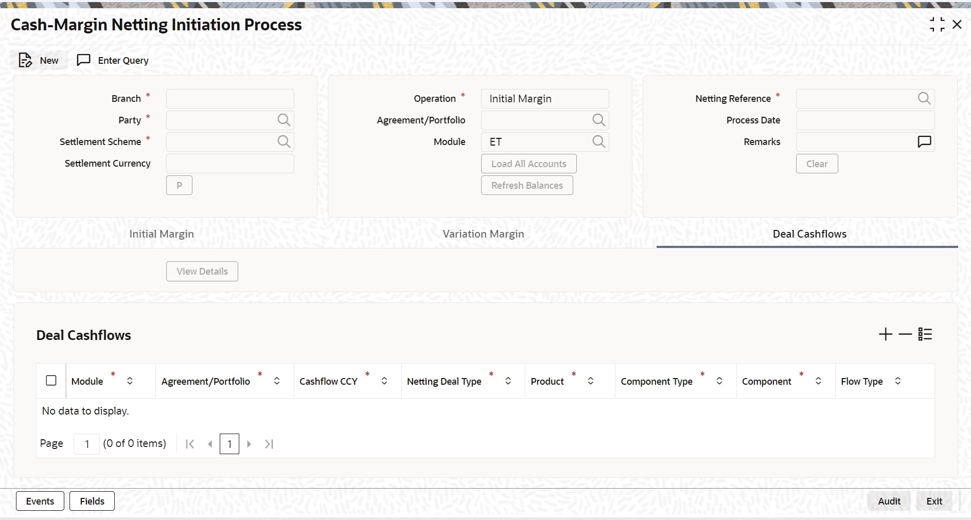

On click of Load All Accounts button, all cashflow Components marked for net settled for the deals linked to the selected Scheme and Agreement or Portfolio are automatically identified. The details for the net amount to be settled would be automatically populated in Deal Cashflows tab.
- User can choose to remove the Components for which pre-netting need not be initiated as part of this transaction
- Can edit the Settlement Amount for each record
Click the Deal Cashflows tab of the Cash-Margin Netting Initiation Process (MGDCMINI) function to open this screen.
Figure 5-6 Cash-Margin Netting Initiation Process - Deal Cashflows
