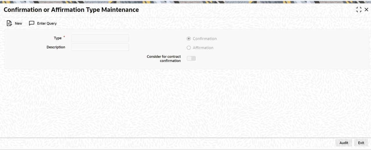

  1. On the Home page, specify STDCNTYP in the text box, and click next arrow.
    The Confirmation/Affirmation Type Maintenance screen is displayed.
    Figure 1-39 Confirmation/Affirmation Type Maintenance
    Description of Figure 1-39 follows
    Description of "Figure 1-39 Confirmation/Affirmation Type Maintenance"
  2. On the Confirmation/Affirmation Type Maintenance screen, specify the fields.
    For more information on fields, refer to the below table.
    Table 1-37 Confirmation/Affirmation Type Maintenance
    Field Description
    Type
    Specify the confirmation or affirmation type.
    Type Description
    Specify the description for the selected type.
    Select the type of contract. The options are as follows:
    • Confirmation
    • Affirmation
    Consider for Contract Confirmation
    Select the Consider for Contract Confirmation check box for affirmation type of contract. If this field is checked for an affirmation type and an affirmation is done for the contract with this affirmation type, then the contract is considered as ‘Confirmed’.
