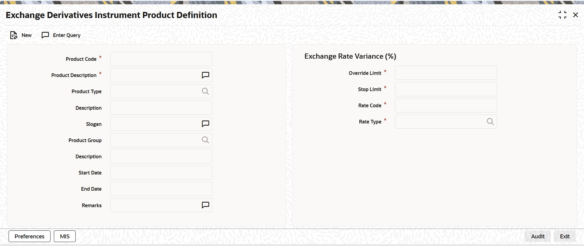

You can create and maintain an instrument product through the Exchange Derivatives Instrument Product Definition screen.
- On Homepage, type ENDINPRO in the text box, and then click next arrow.
The Exchange Derivatives Instrument Product Definition screen is displayed.
Figure 3-1 Exchange Derivatives Instrument Product Definition
Description of "Figure 3-1 Exchange Derivatives Instrument Product Definition" - On the Exchange Derivatives Instrument Product Definition screen, click New.
- On the Exchange Derivatives Instrument Product Definition screen, specify the fields, and then click Enter Query.
For more information on the fields, refer to the below Field Description table.
Table 3-1 Exchange Derivatives Instrument Product Definition Field Description
Field Description Product Code Type a four-character product code for your product. Every product that you create is identified by its unique product code.
This field is mandatory.
Product Description Type a short description for identifying the instrument product quickly. The short description cannot exceed 35 characters. It is meant for information purposes only and will not be printed on any customer correspondence.
Product Type Select the appropriate product type by selecting it from the adjoining list of options.
An important detail in defining a product is to specify the nature of the product you are creating. The product type identifies the basic nature of a product. An ETD Instrument product that you create can be of the following types:
- Options (O)
- Futures (F)
Indicate the appropriate product type by selecting it from the adjoining list of options.
Product Group Specify each product under a specific group. The different groups are defined in the Product Group Definition screen. Indicate the group to which a product belongs by selecting the group code from the adjoining list of options.
Product Slogan Type a marketing punch line to be associated with the product. This slogan is printed on all the advices that are sent to the customers of instruments associated with this product.
Product Start Date and End Date For using a product over a specific period, you can define a Start Date and an End Date. The settlement date of an instrument involving a product should be:
- Same as or later than the Start Date
- Same as or earlier than the End Date of the product
The Start and End Date of a product is useful when you are defining a product that is applicable for a specific period.
If you do not specify an End Date, the product can be used until it is closed.

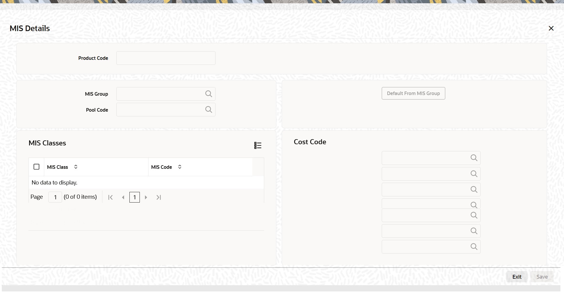

- On the Exchange Derivatives Instrument Product Definition screen, click MIS.
The MIS Details screen is displayed.
You can define the Management Information Details (MIS) details for the instrument product that you are creating through the MIS Details screen. Through the MIS product details screen you can link the product to transaction MIS codes. The transaction codes linked to the product are defaulted to the instrument.
For more details on MIS Details screen, refer to MIS user manual.
