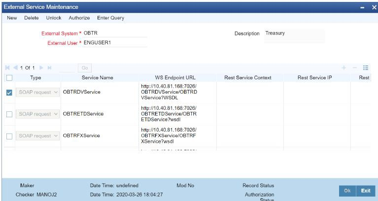

For the service name “OBTRCoreService” with respective WS Endpoint URL, perform the Treasury External Service Maintenance for the External system “FCUBS” to send the FATCA obligation and FATCA referral information to FCUBS.
  1. On the Home page, enter the IFDEXSER in the text box and then click the next arrow.
    The External Service Maintenance screen is displayed.
    Figure 1-14 External Service Maintenance
    Description of Figure 1-14 follows
    Description of "Figure 1-14 External Service Maintenance"
  2. On the External Service Maintenance screen, specify the fields.
