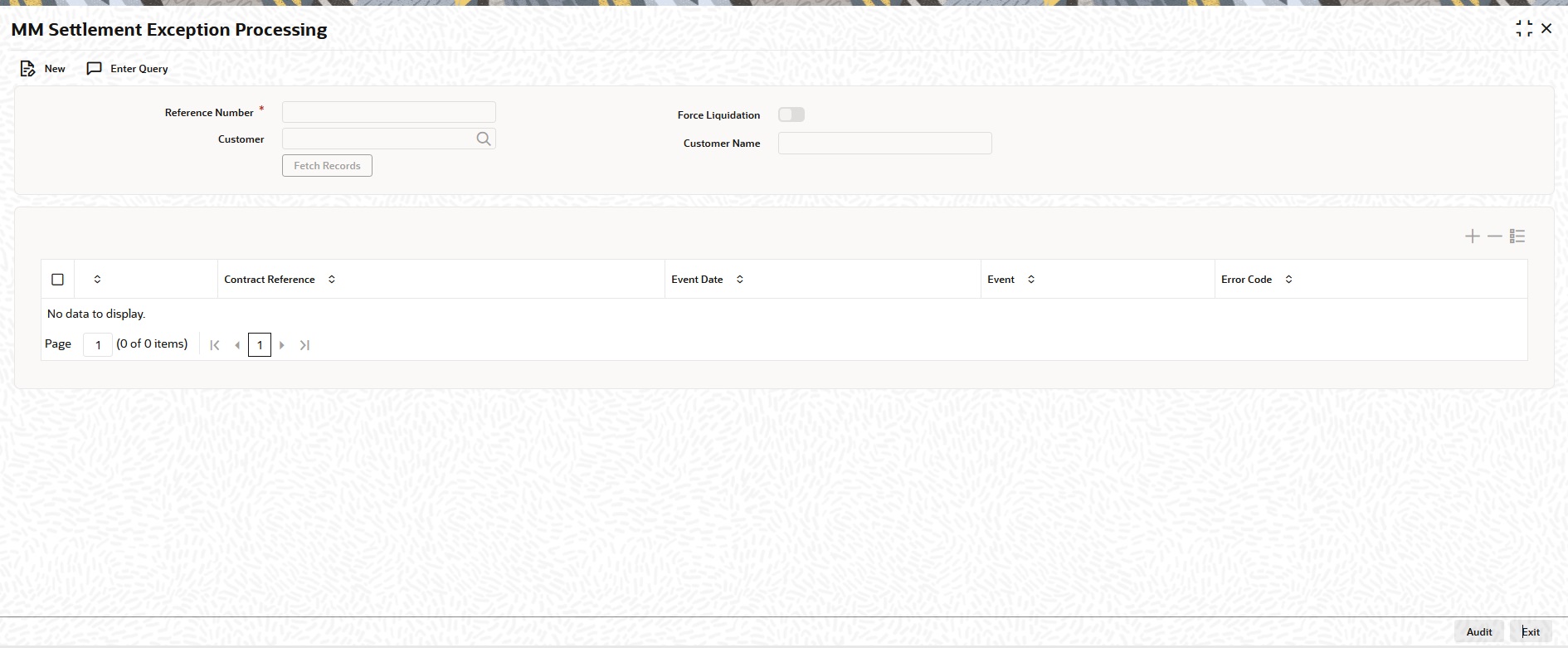

  1. On the Homepage, type MMDEXCEP in the text box, and click the next arrow.
    MM Settlement Exception Processing screen is displayed.
    Figure 3-29 MM Settlement Exception Processing
    MM Exception
  2. On the MM Settlement Exception Processing screen, specify the details as required.
    For information on fields, refer to the below table.
    Table 3-17 MM Settlement Exception Processing - Field Description
    Field Description
    Reference Number
    This is a Mandatory field
    The system displays the reference number.
    Customer
    Specify the customer number. Alternatively, you can select the customer number from the option list. The list displays all valid customer numbers.
    Force Liquidate
    Check this box if the customer account should be force debited.
    Click Fetch Records. The system displays the following information:
    • Contract Reference
    • Event Date
    • Event
    • Error Code
