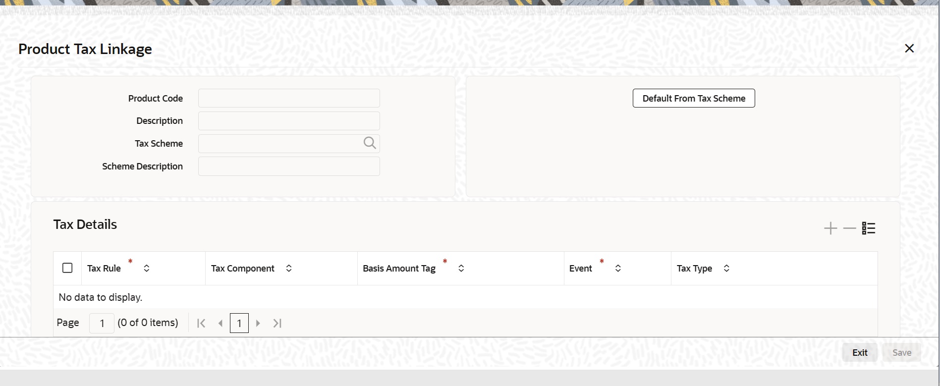

A Tax Scheme is applicable on a product by linking the two rates mentioned above. Once the Tax Scheme is specified for linkage, you should indicate the component on which the two rules are applicable, the event when the tax should be liquidated and the type of tax - withholding or expense.
To specify the linkage of a tax scheme to a product you have to invoke the Product-Tax Linkage Definition screen from the LD/MM Product Definition screen.
  1. Click Tax button in the respective Product Definition screen.
    Tax Details screen displays.
  2. On Tax Details screen, specify the details.
    The fields which are marked in red asterisk are mandatory.
    Table 1-19 Tax Details - Field Description
    Field Description
    Product Code This is defaulted from the Product Definition screen.
    Product Description This is defaulted from the Product Definition screen.
    Tax Scheme Select the tax scheme from the option list.
    Scheme Description The system displays the description.
  3. Click the Ok button to close the screen.
