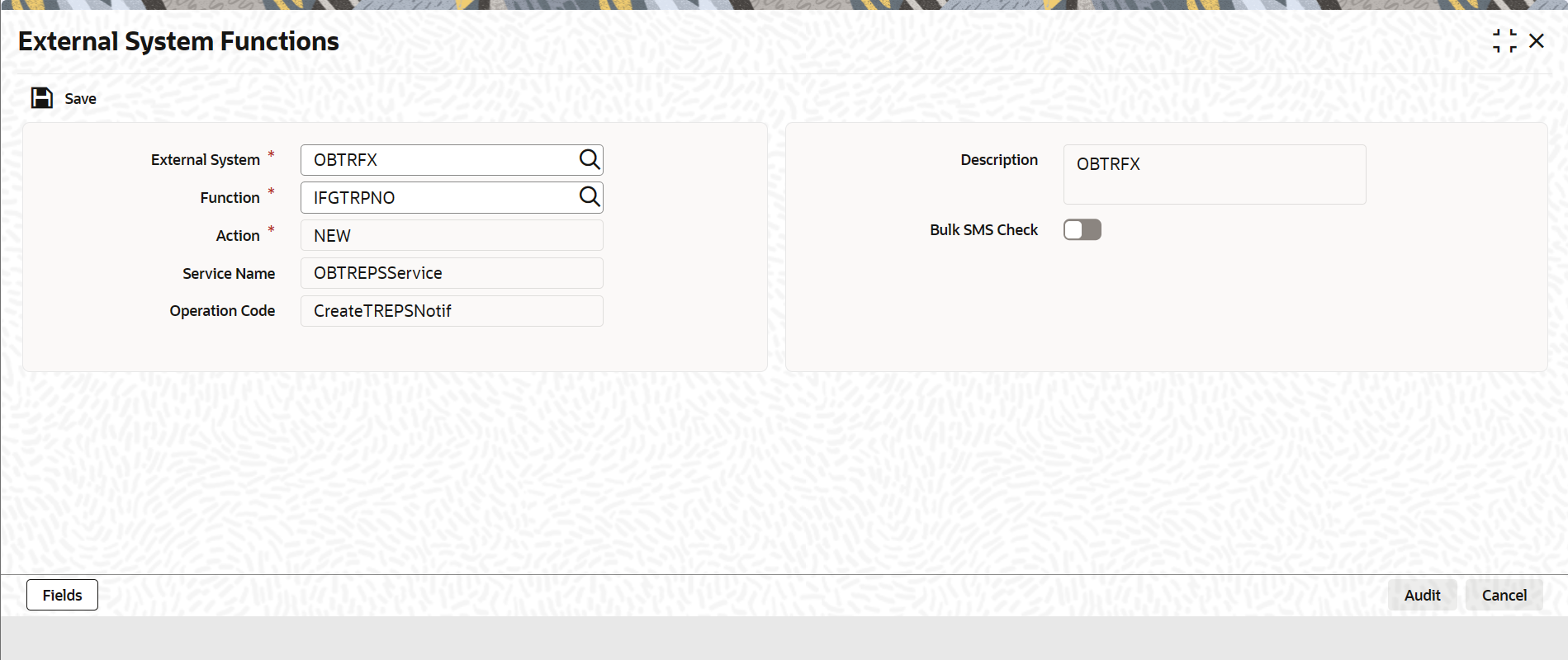

1.1.2 External System Functions Maintenance
The systematic instructions to perform the External System Functions Maintenance.
For the below Source codes with the service name OBTREPSService and the operation code CreateTREPSNotif, maintain the External System Functions to receive the notifications from OBPM.
For all OBTR modules when outgoing payment or receive notice is initiated, the source code is “OBTR<Module-ID>”. For example, the source code for the FX module is “OBTRFX.”
