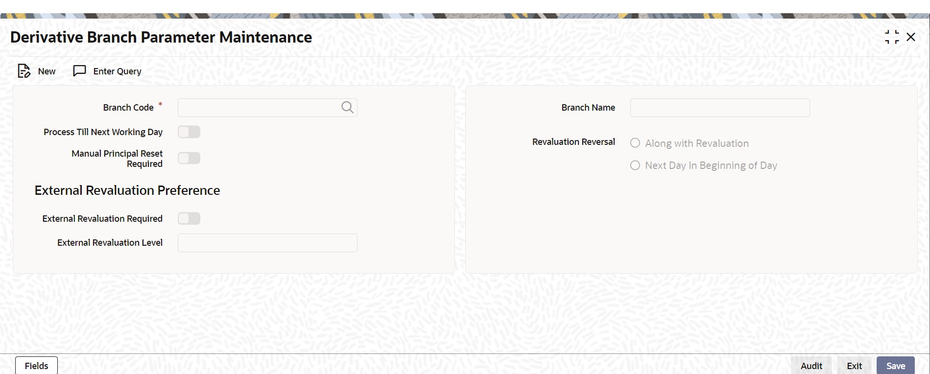

Maintain branch level parameters that govern the processing of derivatives in a particular branch of your bank through the Derivatives Branch Parameters Maintenance screen.
  1. On the Home page, type DVDBRNPM in the text box, and click next arrow.
    The Derivatives Branch Parameter Maintenance screen is displayed.
    Figure 2-3 Derivatives Branch Parameter Maintenance
    Description of Figure 2-3 follows
    Description of "Figure 2-3 Derivatives Branch Parameter Maintenance"
  2. On the Derivative Branch Parameters screen, specify the fields.
    For more information about fields, refer to the below table.

    Table 2-2 Derivatives Branch Parameters Maintenance- Field Description
    Field Description
    Process till Next Working Day
    You have the option to specify whether the batch process should process automatic events falling due on a holiday either
    • as part of the EOD process on the last working date before the holiday; or
    • as part of the BOD process on the next working day after the holiday.

    Revaluation Reversal
    As a branch level parameter, you can indicate how the deal level reversal of Unrealized Revaluation with Previous Year Adjustment should be processed. The available options are:
    • Along with Revaluation - reversals of entries for a particular revaluation will be performed at the time of the next revaluation.
    • Next-Day in BOD – select this option to indicate that any revaluation gain/loss should be reversed the very next day during the BOD process. If the BOD processing date happens to be the first day of the financial year, revaluation reversal will be done from the Previous Year Adjustment GL maintained in the Chart of Accounts.

    External Revaluation Required
    Select the check box next to the External Revaluation Required, for the revaluation to be done externally.
    If this field is checked, ensure to set the external revaluation level to either branch level or product level in Derivative Branch Parameter Maintenance screen.
    External Revaluation Level
    Choose the external revaluation level as required.
    There are two options for external revaluations, one at the branch level and the other product level.
    If External revaluation is enabled, external revaluation level is mandatory.
    Manual Principal Reset Required
    Select this check box for the Principal reset EOD processing on resettable Swaps.
