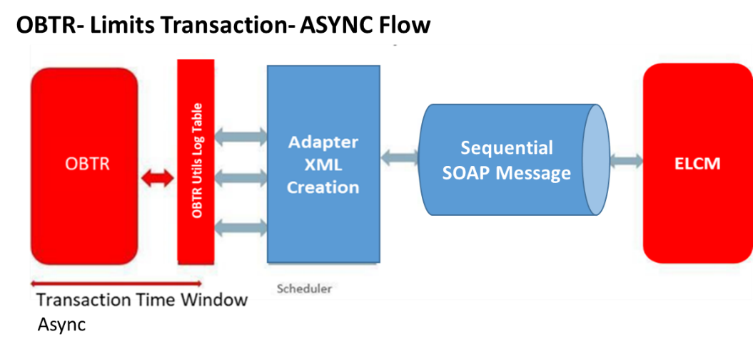

Figure 1-1 OBTR- Limits Transaction- Sync Flow
During EOD, ELCM request is processed in the SYNC mode for the modules: MM, DV, OT, SE, SR, and FX. The rest of the modules are processed in the ASYNC mode using the scheduler job- TREXT_ASYNCCALL.

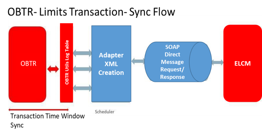

Figure 1-2 OBTR- Limits Transaction- Async Flow
