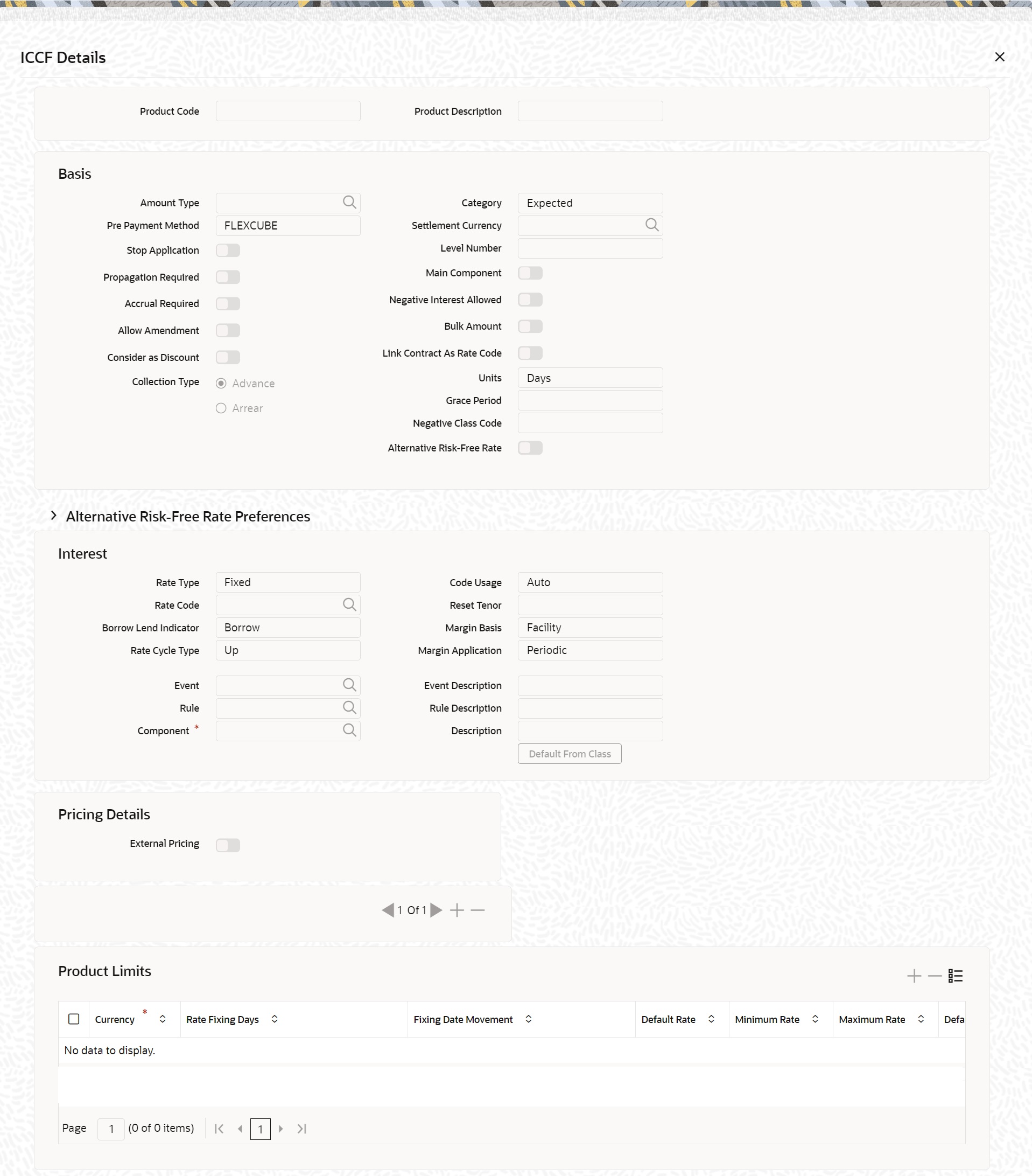

  1. Click Interest in the Product Definition screen.
    The ICCF Details screen is displayed.
  2. In the ICCF Details screen, specify the fields.
    The system dynamically adds a list of suffixes to the main interest component. Each of these suffixes stand for:

    For detailed explanation on the fields, refer to the below table.
    Table 1-15 ICCF - Field Description
    Field Description
    Amount Type
    Specify the basis on which interest has to be calculated. By default, the principal will be taken as the basis.

    Pricing Details Specify the Pricing Details
    External Pricing
    Check this box for external pricing of interest component.
    Product Limits Specify the Product Limits details.
    Currency
    Specify the currency for which limits are maintained
    Rate Fixing Days
    Defaults fixing days from Rate fixing maintenance screen. User will be able to modify the same.
    Fixing Date Movement
    Defaults fixing date movement from Rate fixing maintenance screen. User will be able to modify the same
    Default Rate
    Specify the default rate on contract creation. User will be able to modify the same.
    Minimum Rate
    Specify the minimum rate on contract creation. If the interest rate specified for a contract is less than this minimum rate, the minimum rate is applied on the contract
    Maximum Rate
    Specify the maximum rate on contract creation. If the interest rate specified for a contract is greater than this maximum rate, this rate will be applied on the contract.
    Default Spread
    Specify the default spread for a Floating rate type on contract creation
    Minimum spread
    Specify the minimum spread for a floating rate type product. If the spread specified during contract processing is less than the value specified as the minimum spread, this value will be picked up as the spread.
    Maximum Spread
    Specify the maximum spread for a floating rate type product. if the spread specified during contract processing is more than the value specified as maximum spread, this value will be picked up as the spread.
    Interest Basis
    This field indicates how the system must consider the tenor basis upon which interest is computed over a schedule or interest period, in respect of the interest component being associated with the product.
    Denominator Basis
    This field indicates the interest methods which have their interest basis set to ACTUAL i.e. 30(EURO)/ACTUAL, 30(US)/ACTUAL and ACTUAL/ACTUAL. Denominator Basis is used to specify how the month of February is treated when the denominator is 'Actual'. There are two types of denominator basis methods:
    • Per Interest Basis – Here the computation would be done based on ACT/ACT–ISMA Interest Method. In this case, the '366 Basis' field will not be applicable.
    • Per Annum (A) – Here the interest calculation will depend on the value the user specify for 366 Basis
    366 Basis
    This is applicable only if the Denominator Basis is set to 'Per Annum'. The user can select one of the following values here:
    • Leap Year
    • Leap Date - computation would be done based on ACT/ACT - FRF Interest Method
    No of Interest Period
    This is applicable if the Denominator Basis is 'Per Interest Period'. Here the user can specify the number of Interest periods (Schedules) in the financial year.
