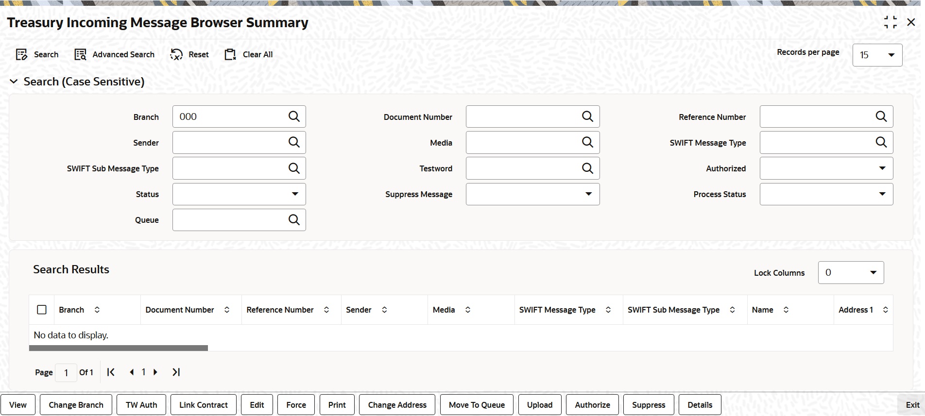

               - On Homescreen, specify MSSTRIBR
                        in the
                    text box, and click Next.Treasury Incoming Message Browser Summary screen displays.
Figure 7-1 Treasury Incoming Message Browser Summary
Description of "Figure 7-1 Treasury Incoming Message Browser Summary" - On Treasury Incoming Message Browser Summary screen,

 - Click the Search button to view the details.The system identifies all incoming messages satisfying the specified criteria and displays the following details for each incoming message:

 - Check the box against the message(s) for which needs to perform an operation
                    and then click the corresponding operation.
Table 7-2 Operations
Operation Description View To view the message, highlight the message and click the View button on the browser. The contents of the message will be displayed in a separate screen. Change Branch Select the message for which Branch has to be changed and click on Change Branch button. The details of the message will be displayed with only the Branch field enabled. Select the new branch from the list of values provided and save the message. TW Auth A telex message for which a testword is entered should be authorized before it can be routed to a user queue (if it is specified in the Messaging Branch Parameters Maintenance screen). To authorize a test word that was entered for a telex message, click the TW Auth button from the browser on this screen. During the authorization of a testword the authorizer will be required to re-enter the testword. Link Contract In the browser, select the message with which a contract to be associated and click the Link Contract button. The Reference Number option list is enabled for the selected message. Select the appropriate contract from the list. The message will be subsequently associated with the contract selected here. Edit Click the Edit button to make changes to the SWIFT message, especially the messages marked for repair. The message is displayed in edit mode (Edit Message screen) and only a user with requisite rights for editing can edit an incoming message. If editing is possible for the user, the message is available for amendment. The list of fields which can be modified are maintained through back-end database tables appropriately during implementation of Oracle FLEXCUBE Universal Banking . Mostly fields like Amount, Currency are maintained as non-modifiable whereas fields such as Value Date is maintained as modifiable. Based on the maintenance in these tables, the appropriate fields are enabled for amendment. On saving the amendment of the message, a new version is created and must be authorized. Two versions of an incoming message are displayed on the screen. If the verifier needs to reject the change for any reason the same can be mentioned in the Reject Reason field. Note:
In the case of incoming messages with a PDE trailer, the PDE Flag check box in the Incoming Message Browser Summary screen will be checked. In the Edit Message screen, check Remove Trailer option to remove the PDE trailer (message contains the text PDE) and save the message.Force Use Force button to forcibly release all Payment Message Transactions with Funding Exception status and insufficient funds. In other words, the system will post the required accounting entries for such transactions regardless of insufficient funds in the accounts. However, an override will be displayed. The system will also maintain a detailed audit trail for such transactions. A user with appropriate rights can perform this function. Print To print the details of an incoming message, highlight the message and click the Print button on the browser. The screen prompts the option to spool or directly print the message. The SWIFT tag description can also be viewed. Change Address To change the address, highlight the message and click the Change Address button on the browser. Move To Queue After the necessary checks for the media through which a message is transmitted, route the message to a user queue. To change the queue in which an incoming message should be stored, select the message, click the Move To Queue button and select a queue from the adjoining option list. The message will be automatically moved to the queue that is specified. The final destination of an incoming message is the end-user queue. These queues represent departments or printers responsible for acting on the received messages. Once a message is lodged into an end-user queue, it can be viewed on-screen or printed by the users who have access to the queue. It is possible to move messages from one end user queue to another as well. For a message that was transmitted through Telex, enter the testword and have it authorized before routing it to the relevant end-user queue. Upload If the background process for incoming messages is not running, upload the messages that have come into the bank from the incoming directory on the node to which the branch is connected. To upload messages from the incoming directory (specified in the Message Media Control Maintenance screen) click the Upload button. All messages that were stored in the incoming directory will be uploaded to Oracle FLEXCUBE Universal Banking and displayed in the Incoming Message Browser. Authorize Use the Authorize button to authorize the message. All the amendments made to a SWIFT payment message have to be authorized by a user with appropriate authorization rights. At the time of authorization, Oracle FLEXCUBE Universal Banking will display the earlier version of the SWIFT payment message along with the amended version, in the same window. A list of all the errors due to which the message was marked for repair is also displayed. The authorizer can view all the errors and also verify the changes that were made to correct them. After verification, if all the details are found to be appropriate, the message is authorized. Oracle FLEXCUBE Universal Banking maintains a detailed audit log of all amended SWIFT Payment Messages. The following details are captured for each authorized message: - User ID of the person who authorized the amendments
