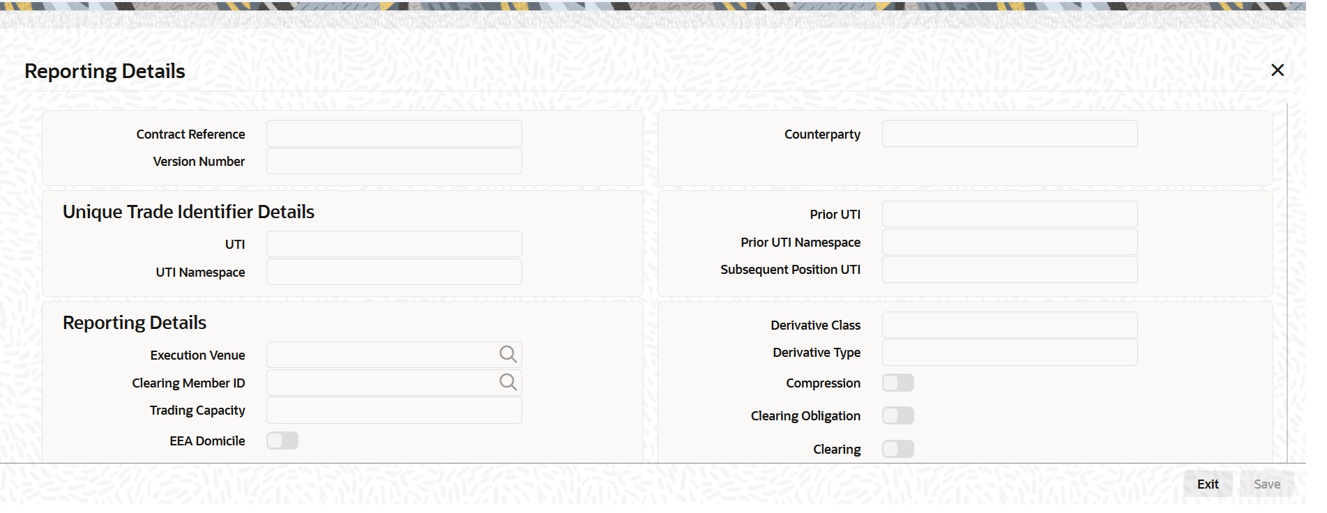

- On the Contract Input screen, click the Reporting Details tab.
The Reporting Details screen is displayed.
- On the Reporting Details screen, specify the details as required, and click Ok.For more information on the fields, refer to the below table.
