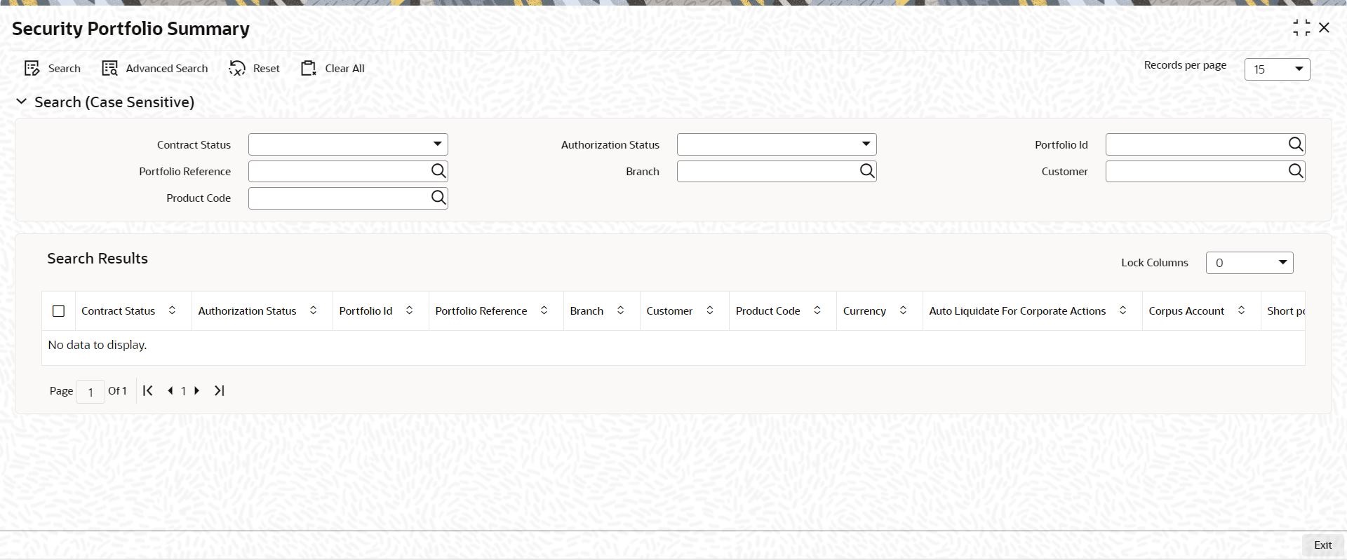

  1. On the Home page, specify SESXPFNL in the text box, and click next arrow.
    Security Portfolio Summary screen is displayed.
    Figure 20-3 Security Portfolio Summary
    Description of Figure 20-3 follows
    Description of "Figure 20-3 Security Portfolio Summary"
  2. On the Security Portfolio Summary screen, specify the fields.
    Click the Search button to view all the pending functions. However, you can to filter your search based on any of the following criteria:

    Click Search button the records matching the specified search criteria are displayed. For each record fetched by the system based on your query criteria, the following details are displayed:
