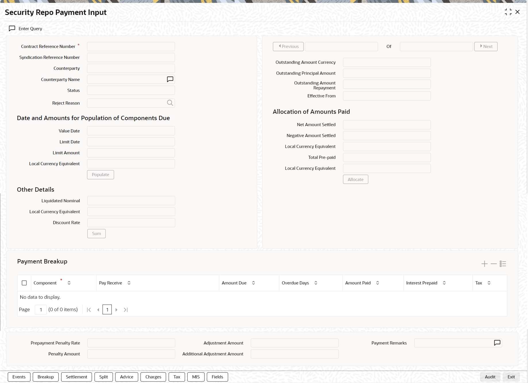

2.20 Securities Repo Payment Input
Use the Securities Repo Payment Input to process the payment method.
  1. On the Home page, type SRDPAMIN in the text box, and click the next arrow.
    The Securities Repo Payment Input screen is displayed.
    Figure 3-72 Securities Repo Payment Input
    Description of Figure 3-72 follows
    Description of "Figure 3-72 Securities Repo Payment Input"
  2. On the Securities Repo Payment Input screen, specify the details as required.
    For RFR contract on payment delay method, no penalty is charged for payment after actual due date and within payment delay days.
    For information on fields, see the below table
    Table 3-65 Securities Repo Payment Input - Field Description
    Field Description
    Contract Reference Number
    Specify Contract reference number
    Syndication Reference Number
    Displays syndication reference number
    Counterparty
    Displays contract counterparty ID
    Counterparty Name
    Displays counterparty name
    Status
    Displays status of payment
    Reject Reason
    Specify the Reject reason Code for payment reversal message. The option list displays all valid code maintained in the system. Choose the appropriate one.
    Outstanding Amount Currency
    Displays outstanding amount currency
    Outstanding Principal Amount
    Displays the outstanding balance amount.
    Outstanding Amount Repayment
    Displays the outstanding amount repayment.
    Effective From
    Enter the date for which the rate must become applicable. Each rate that is defined for a Rate Code and Currency combination must have an Effective Date associated with it. This is the date on which the rate comes into effect. Once a rate comes into effect, it will be applicable till a rate with another Effective Date is given for the same Rate Code and Currency combination
    Date and Amounts for Population of Components Due Specify the below fields.
    Value Date
    Specify the value date.
    Limit Date
    Enter here the Limit Date for prepayments. If the user has given a payment limit date, the system shows all the components, which are due till the limit date.
    Limit Amount
    Enter the Limit amount for prepayment. If the user has given the amount limit in the Amount field, it shows all the schedules for the limit amount.
    Local Currency Equivalent
    Specify the local currency equivalent for the limit amount. The local currency equivalent is calculated using the standard rate in case of cross currency transactions.
    Net Amount Settled
    Enter the amount being paid for a particular component. This must be less than or equal to the total amount due for the component.
    If there are both positive and negative amounts are to be settled, then specify the net amount in this field.
    Negative Amount Settled
    The system displays the total negative amount that should be settled. Partial settlement of negative amount is restricted.
    Back dated payment of interest amount is allowed till last payment or amendment date whichever is later.
    Specify the local currency equivalent for the total paid amount. The local currency equivalent is calculated using the standard rate in case of cross currency transactions.
    Total Pre-paid
    Specify the prepaid amount.
    Specify the local currency equivalent for the total prepaid amount. The local currency equivalent is calculated using the standard rate in case of cross currency transactions.
    Liquidated Nominal
    Specify the Liquidated Nominal amount which is the amount that the user receives, when the user redeem a T-Bill on the maturity date.
    This is also known as the face value of the T-Bill. The discount rate is used to calculate the Net Present Value (NPV) of a T-Bill when it is liquidated before the liquidation date i.e. the actual value obtained on the T-Bill when the user redeem it prior to the maturity date.
    Specify the local currency equivalent for the liquidated nominal value of the amount. The local currency equivalent is calculated using the standard rate in case of cross currency transactions.
    Discount Rate
    Enter the discount rate.
    If the discount rate basis is Direct Input then the user has to enter the rate at which interest is to be discounted in this field.
    Component
    Displays the Component for which payment is done
    Amount Due
    Displays the amount due for the component that the user has to repay
    Overdue Days
    Displays the overdue days
    Amount Paid
    Specify the paid amount.
    Interest
    Specify the interest prepaid for the component.
    Tax
    Specify the amount paid in tax.
    Prepayment Penalty Rate
    Displays the Prepayment penalty rate
    Penalty Amount
    Displays the penalty amount
    Adjustment Amount
    Displays the Adjustment amount
    Additional Adjustment Amount
    Displays the additional adjustment amount
    Payment Remarks
    Specify the payment remarks
  3. The system validates that ,if there are outstanding positive or negative interest amounts related to multiple schedules, earlier schedules are fully paid before settling subsequent schedules.

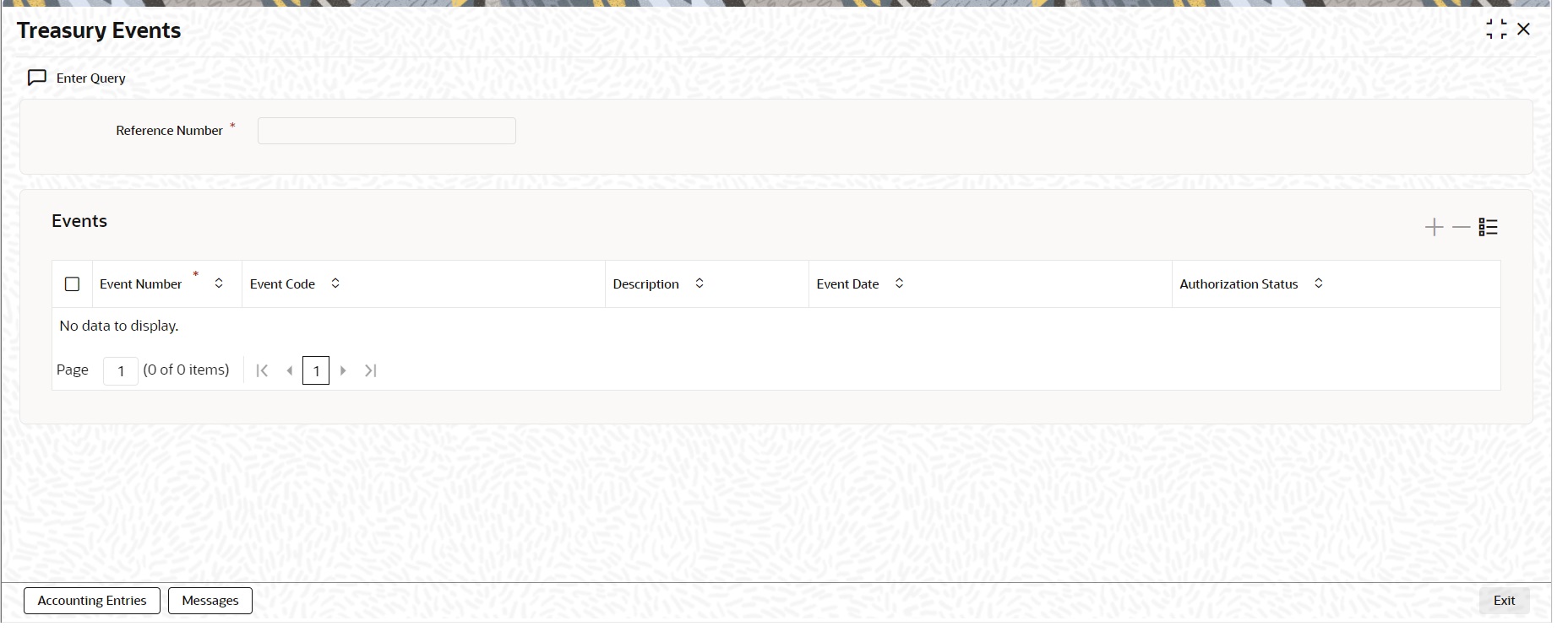

  4. On the Securities Repo Payment Input screen, click Events.
    The Treasury Events screen is displayed.
    Figure 3-73 Treasury Events
    Events
  5. On the Treasury Events screen, specify the details as required.
    For information on fields, see the below table:
    Table 3-66 Treasury Events - Field Description
    Field Description
    Reference Number
    Payment reference number automatically gets defaulted for the current payment.
    Events Displays the event
    Event Number
    This is a Mandatory field.
    Displays the event sequence number
    Event Code
    Displays the event code
    Description
    Displays the event code description
    Event Date
    Displays the event date
    Authorization Status
    Displays the event authorization status
    Maker Id
    Displays the payment marker ID
    Checker Id
    Displays the payment checker ID

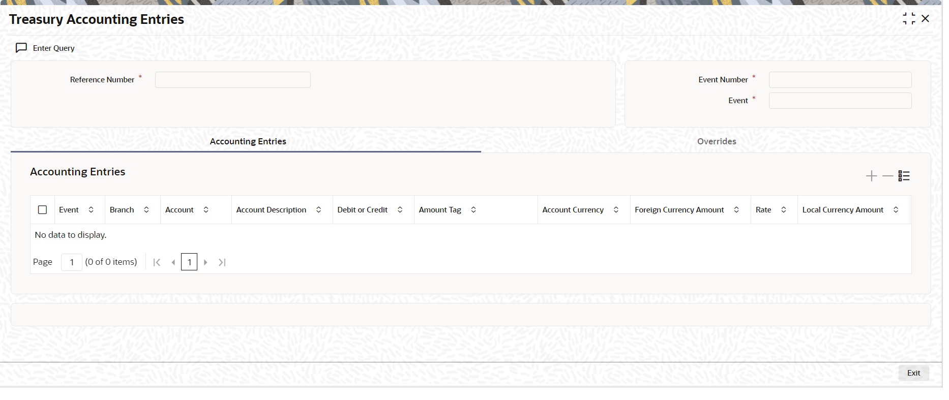

  6. On the Treasury Events screen, click Accounting Entries.
    The Treasury Accounting Entries screen is displayed.
    Figure 3-74 Treasury Accounting Entries
    Accounting entries
  7. On the Treasury Accounting Entries screen, specify the details as required.
    Table 3-67 Treasury Accounting Entries - Field Description
    Field Description
    Reference Number
    Displays the contract reference number
    Event Number
    Displays the event number
    Event
    Displays the event
    Accounting Entries
    Specidy the Accounting Entries fields.
    Event
    Displays the event
    Branch
    Displays the account branch
    Account
    Displays the account number
    Account Description
    Displays the account description
    Debit or Credit
    Displays whether account is debited or credited
    Amount Tag
    Displays the related amount tag
    Account Currency
    Displays the account currency
    Foreign Currency Amount
    Displays the FCY amount
    Rate
    Displays the exchange rate
    Local Currency Amount
    Displays the local currency equivalent amount for a foreign currency payment
    Date
    Value Date
    Displays the event value date
    Txn Code
    Displays the transaction code

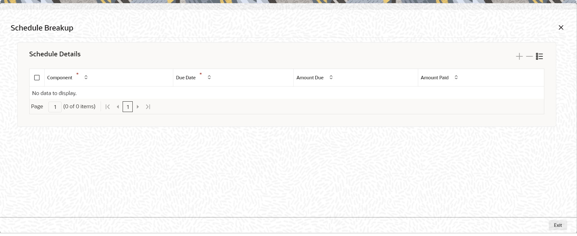

  8. On the Securities Repo Payment Input screen, Click Breakup
    The Schedule Breakup screen is displayed.
  9. On the Schedule Breakup screen, specify the details as required.
    Table 3-68 Schedule Breakup - Field Description
    Field Description
    Component
    The component getting paid is displayed.
    Due Date
    The due date of the component liquidated is displayed.
    Amount Due
    The amount outstanding for the liquidated component is displayed here.
    Amount Paid
    The user can see here the amount paid for the component as of the value date (the current system date).

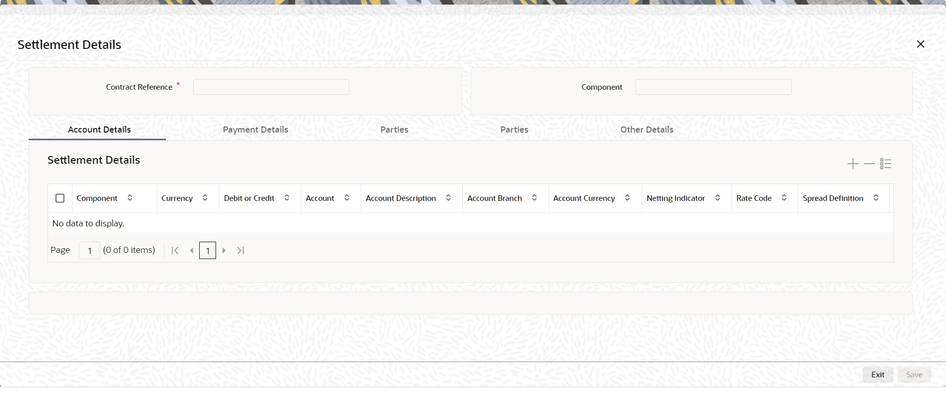

  10. On the Securities Repo Payment Input screen, click Settlement.
    The Settlement Details screen is displayed.
    Figure 3-76 Settlement Details
    Settlement details
  11. On the Settlement Details screen, specify the details as required.
    For more information, refer settlement guide for settlement processing.

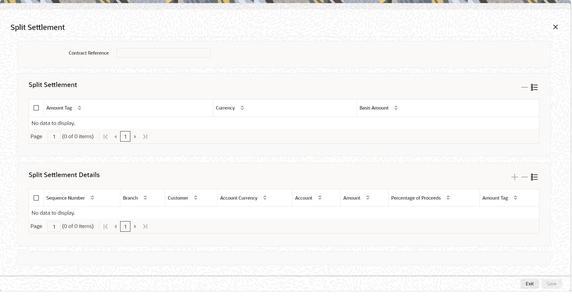

  12. On the Security Repo Payment Input screen, click Split Settlement.
    The Split Settlement screen is displayed.
    Figure 3-77 Split Settlement
    Split settlement
  13. On the Split Settlement screen, specify the details as required.

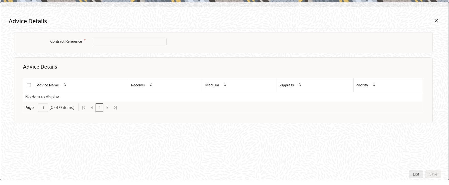

  14. On the Security Repo Payment Input screen, click Advice.
    The Advice Details screen is displayed.
    Figure 3-78 Advice Details
    Advice details
  15. On the Advices screen, specify the details as required.
    Table 3-69 Advices- Field Description
    Field Description
    Contract Reference
    Displays contract reference number
    Advice Name
    Displays the advice name
    Receiver
    Displays the receiver name
    Medium
    Displays the medium details
    Suppress
    Displays the suppress details
    Priority
    Displays the Priority details

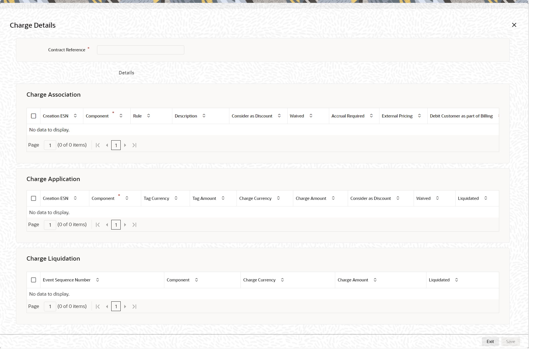

  16. On the Security Repo Payment Input screen, click Charges.
    The Charge Details screen is displayed.
    Figure 3-79 Charge Details
    Charge DEtails
  17. On the Charge Details screen, specify the details as required.
    For more information on fields, see the below table:
    Table 3-70 Charges Details- Field Description
    Field Description
    Contract Reference
    Charge Association
    Creation ESN
    Displays the Event Sequence number
    Component
    Displays the charge component
    Rule
    Displays the Charge Rule ID
    Description
    Displays the Charge Rule description
    Consider as Discount
    Displays whether Charge component must be considered for IRR calculation
    Waived
    Specify if user wants to waive the charge associated to the event
    Accrual Required
    Displays if charge must be accrued or not
    External Pricing
    Displays if charge is priced externally
    Debit Customer as part of Billing
    Displays if charge id debited from customer
    Charge Application
    Creation ESN
    Displays Event sequence number
    Component
    Displays Charge component
    Tag Currency
    Displays tag currency
    Tag Amount
    Displays tag amount
    Charge Currency
    Displays charge currency
    Charge Amount
    Displays charge amount
    Displays if charge component is considered for IRR calculation
    Waived
    Specify if the charge applied for the contract must be waived
    Liquidated
    Displays if charge is liquidated
    Charge Liquidation Specify the below fields.
    Event Sequence Number
    Displays event sequence number.
    Component
    Displays charge component
    Charge Currency
    Charge Amount
    Displays the charge amount
    Liquidated
    Displays if charge is liquidate for the contract

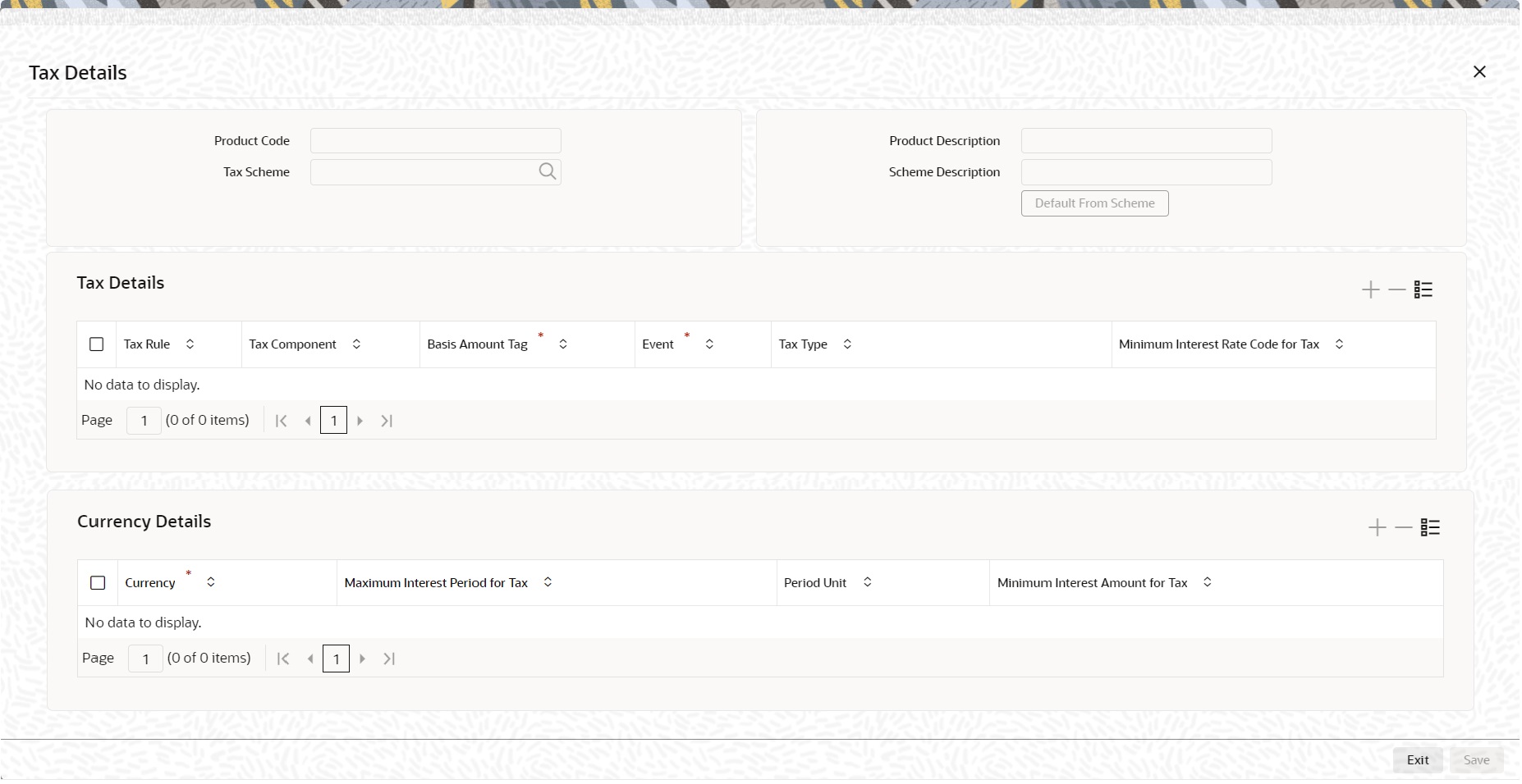

  18. On the Security Payment Repo Input screen, click Tax.
    The Tax Details screen is displayed.
    Figure 3-80 Tax Details
    Tax details
  19. On the Tax Details screen, specify the details as required.
    Table 3-71 Tax Details - Description
    Field Description
    Tax Scheme
    Choose A Tax Scheme from the Option list
    Product Description
    Add Product code and its description like other sub system
    Scheme Description
    System defaults scheme description
    Tax Details Specify the below fields.
    Tax Rule
    System defaults the Tax Rule mapped to the scheme for Tax computation
    Tax Component
    The method of tax application defined for the Tax Rule will be applied on this component
    Basis Amount Tag
    Amount tag on which Tax is computed
    Event
    Specify the event for which the tax is applicable.
    Tax type
    The type of tax, decides the bearer the tax. It could be the bank or the customer.
    A customer bears withholding type of tax and the tax component is debited to the customer’s account. The bank bears an expense type of tax and the tax component is booked to a tax expense account.
    Minimum Interest Rate Code for Tax
    Specify the rate code for Tax
    Currency Details
    Currency
    Specify the currency from the list of option
    Maximum Interest Period for Tax
    Specify the maximum interest period for the tax
    Period Unit
    Specify the period as
    • Days
    • Months
    • Year
    Minimum Interest Amount for Tax
    Specify the minimum Interest amount for the tax

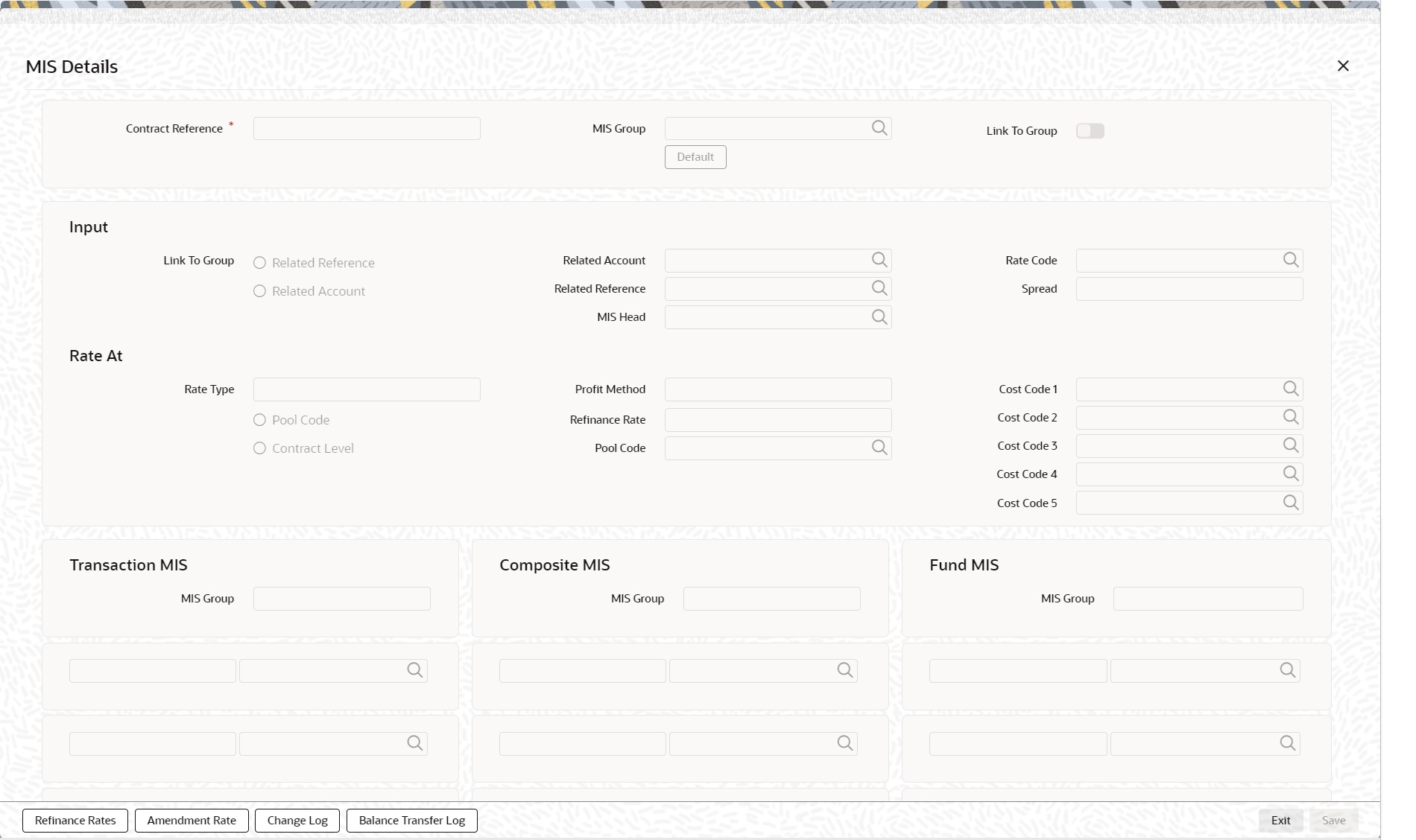

  20. On the Securities Repo Payment Input screen, click MIS.
    The MIS Details screen is displayed.
    Figure 3-81 MIS Details
    Mis details
  21. On the MIS Details screen, specify the details as required.

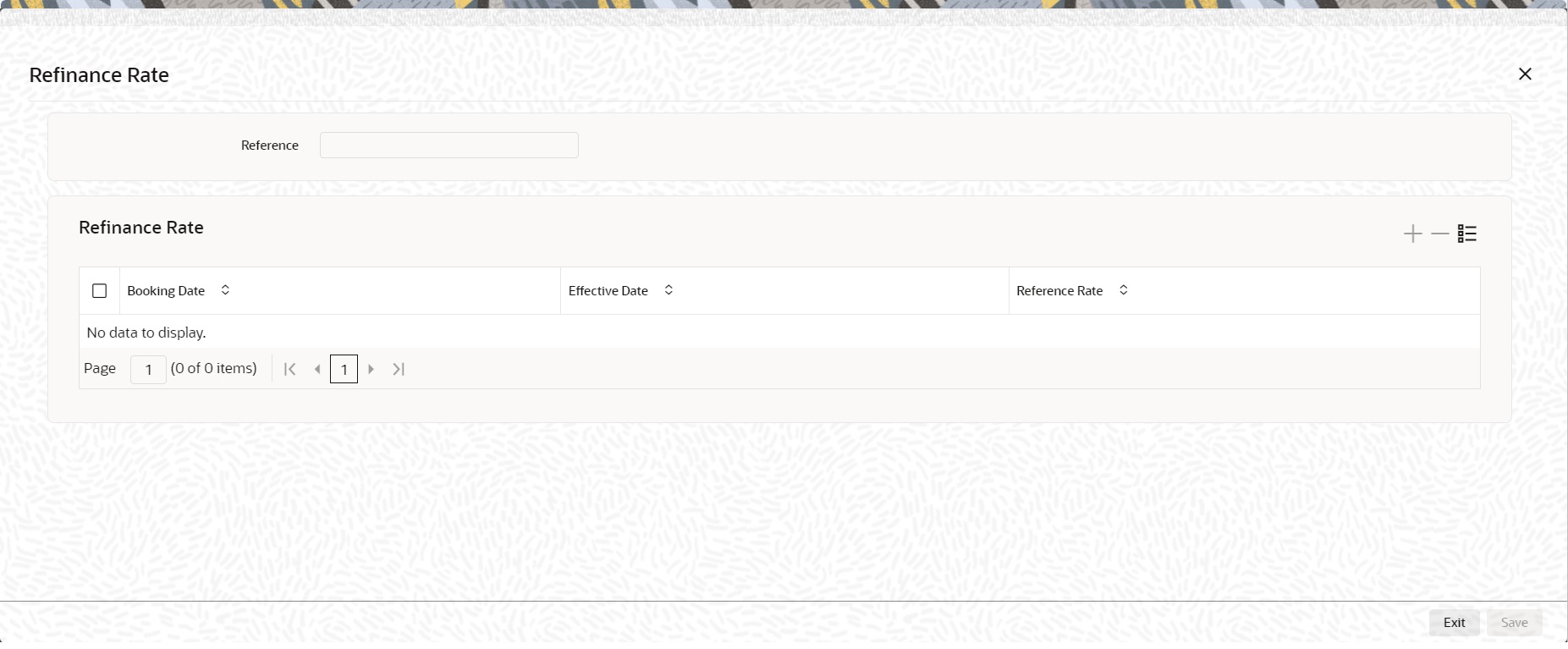

  22. On the MIS Details screen, click Refinance Rate.
    The Refinance Rate screen is displayed.
    Figure 3-82 Refinance Rate
    refinance rate
  23. On the Refinance Rate screen, specify the details as required.

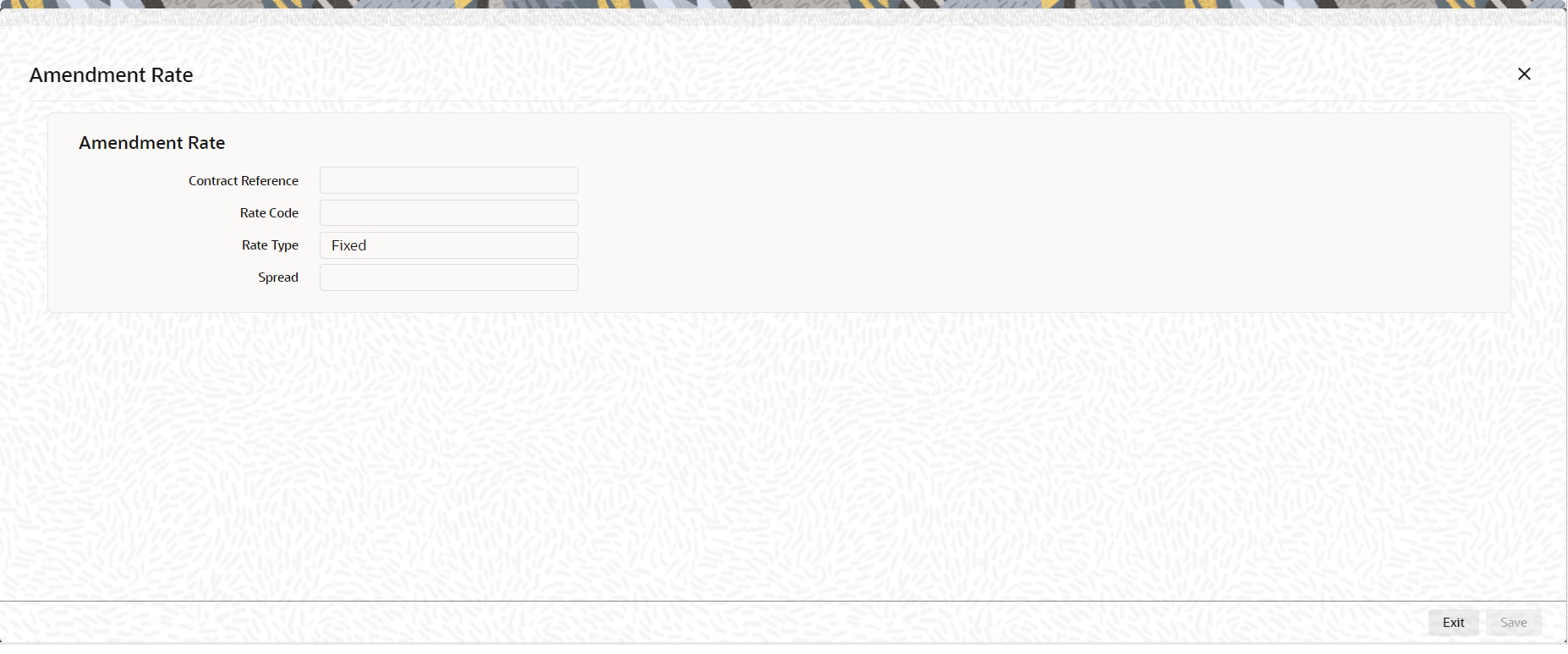

  24. On the MIS Details screen, click Amendment Rate.
    The Amendment Rate screen is displayed.
    Figure 3-83 Amendment Rate
    amendment rate

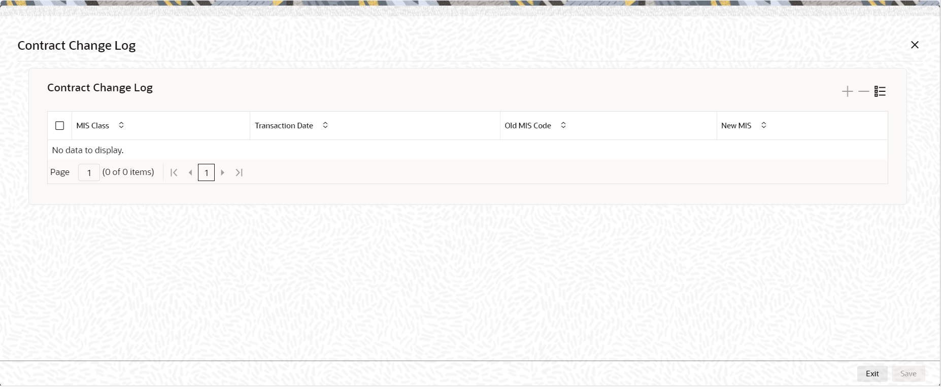

  25. On the MIS Details screen, click Change Log.
    The Change Log screen is displayed.
    Figure 3-84 Change Log
    Change log
  26. On the Change Log screen, specify the details as required.

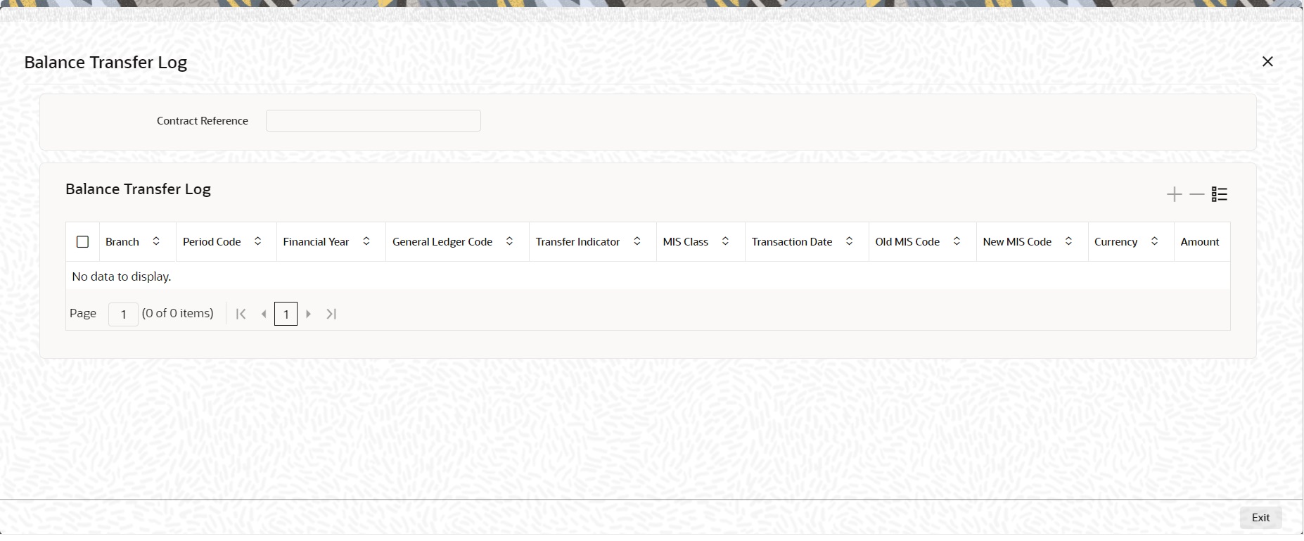

  27. On the MIS Details screen, click Balance Transfer Log.
    The Balance Transfer Log screen is displayed.
    Figure 3-85 Balance Transfer Log
    balance transfer log
  28. On the Balance Transfer Log screen, specify the details as required.

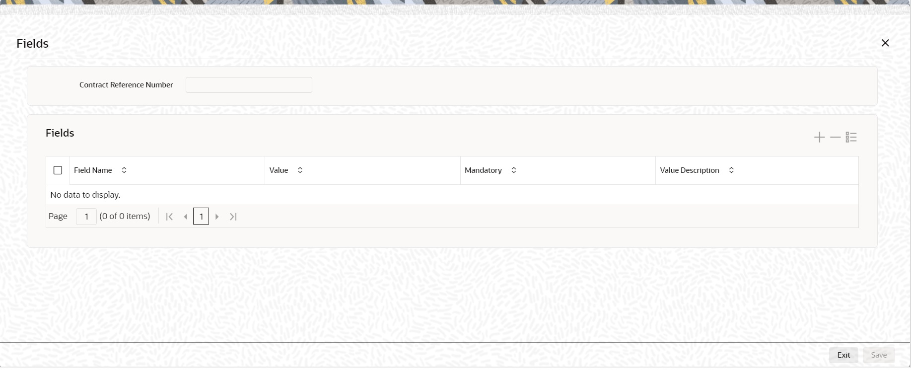

  29. On the Securities Repo Payment Input screen, click Fields.
    The Fields screen is displayed.
    Figure 3-86 Fields
    fields
  30. On the Fields screen, specify the details as required.
    Table 3-72 Fields - Field Description
    Field Description
    Field Name
    Defaults user defined field name mapped to the product
    Value
    Specify the UDF value
    Mandatory
    Defaults the mandatory flag from user defined maintenance screen
    Value Description
    Displays the user defined value description
