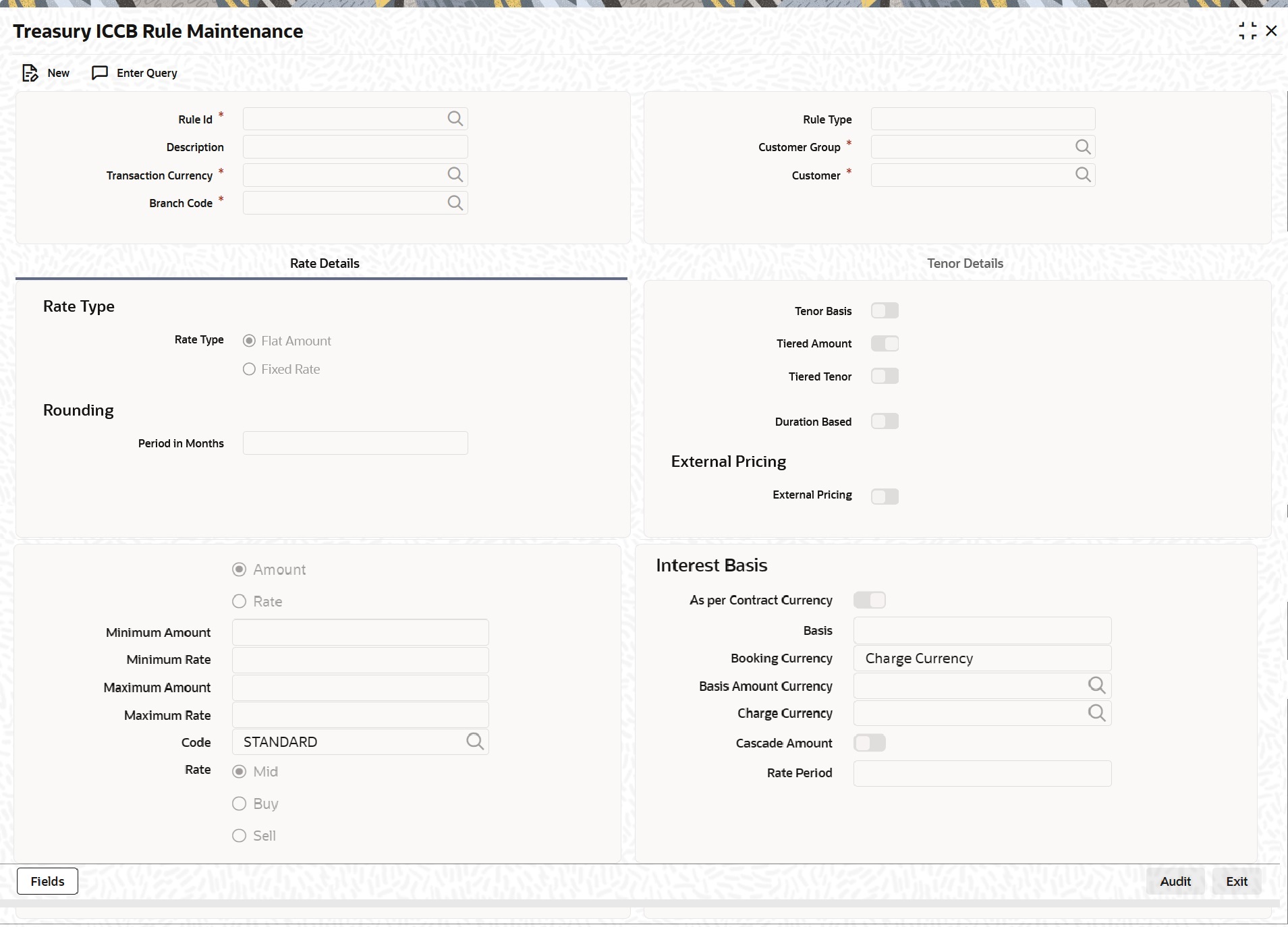

- On the Homepage, enter CFDTRRLM in the text field and then click the next arrow.The Treasury ICCB Rule Maintenance screen is displayed.
Figure 1-2 Treasury ICCB Rule Availability Maintenance
Description of "Figure 1-2 Treasury ICCB Rule Availability Maintenance" - On the Treasury ICCB Rule Maintenance screen, specify the fields.For field details and description, refer to the below table.
