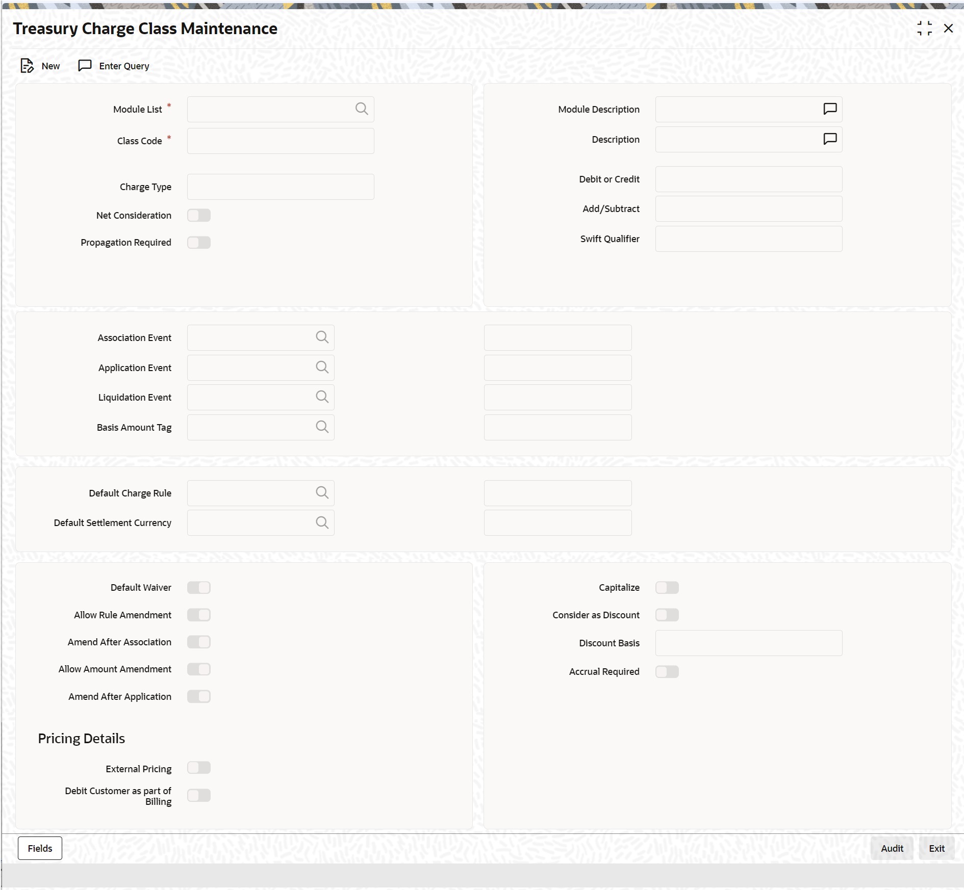

- On the Homepage, enter CFDTRCCM in the text field and then click the next arrow.The Treasury Charge Class Maintenance screen is displayed.
Figure 1-6 Treasury Charge Class Maintenance
Description of "Figure 1-6 Treasury Charge Class Maintenance" - On the Treasury Charge Class Definition screen, specify the fields.For field details and description, refer to the below table.

Field Description Class Code Before defining the attributes of a charge class, you should assign the class a unique identifier, called the Class Code and briefly describe the class. A description would help you easily identify the class.
