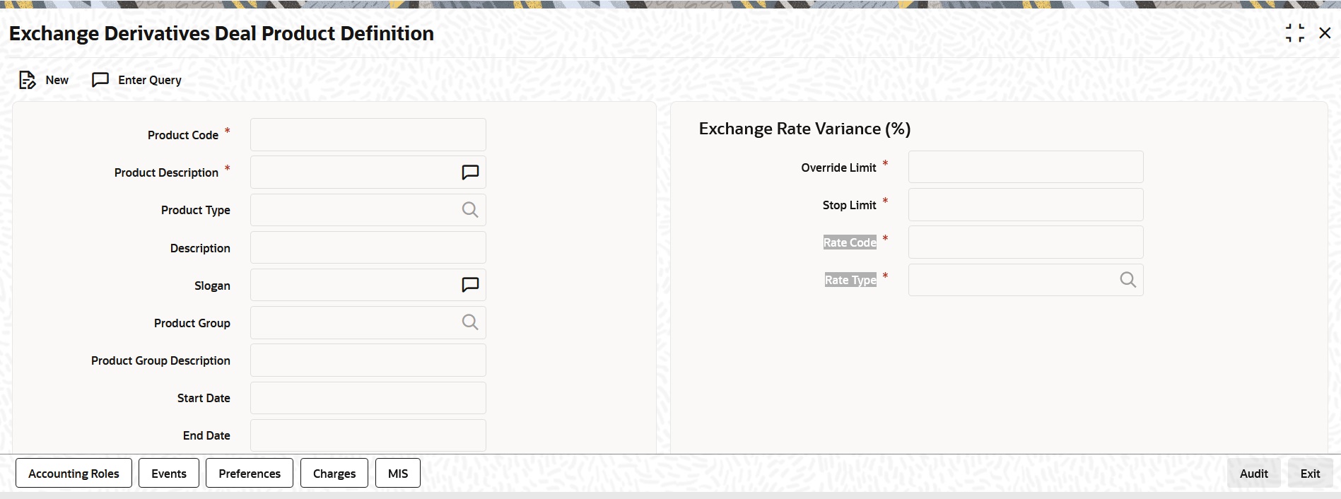

    Figure 6-1 Exchange Derivatives Deal Product Definition
    Description of Figure 6-1 follows
    Description of "Figure 6-1 Exchange Derivatives Deal Product Definition"
  2. On the Instrument Definition screen, click New.
  3. On the Instrument Definition screen, specify the following details, and then click Enter Query.
    The basic details about the product are common for every product that you capture in the ETD module of Oracle Banking Treasury Management. However, while defining a deal product you need to specifically indicate the exchange rate variance that is to be associated with the product.
    Table 6-1 Instrument Definition- Field Description
    Field Description
    Product Code and Product Description
    Specify the product code and product description.
    Product Type
    Specify the product code.
    Product Slogan
    Type a slogan for the product that you are creating.
    Product Group
    Grouping products according to the common features they share helps you organize information relating to the services you provide. This helps you retrieve information easily.
    Product Start Date and End Date
    When you create a product, you must also specify a date from which it can be offered. You may also specify the date up to which you would like to offer the product. Enter these dates in the Start Date and End Date fields.
    Note: You cannot offer a product beyond the specified end date. If you do not specify an end date for a product, you can offer it for an indefinite period.
    Remarks
    If you want to enter any remarks regarding the product, do so in the Remarks field.
    Exchange Rate Variance
    For a special customer, or in special cases, you may want to use an exchange rate (a special rate) that is greater than the exchange rate maintained for a currency pair. The variance is referred to as the Exchange Rate Variance.
    When creating a product, you can express an Exchange Rate Variance Limit in terms of a percentage. This variance limit would apply to all deals associated with the deal product.
    Override Limit
    If the variance between the default rate and the rate input varies by a percentage between the Rate Override Limit and the Rate Stop Limit, you can save the deal by providing an override.
    Stop Limit
    If the variance between the defaulted rate and the rate that is entered varies by a percentage greater than or equal to the Rate Stop Limit, you cannot save the deal.
    Rate Code
    While settling charges for cross-currency settlements, you can choose to debit the customer by applying the mid-rate or by using the buy/sell spread over the mid-rate.
    Rate Type
    Indicate the Rate Type which should be picked up for exchange rate conversions involving settlement of charges for cross currency deals. You can maintain any one of the following as the Rate Type:
    • Cash Rate
    • TT Rates
    • Bill Rates
    Note: Information about specific attributes of a product has to be defined in the sub-screens within the Product Definition Main screen.

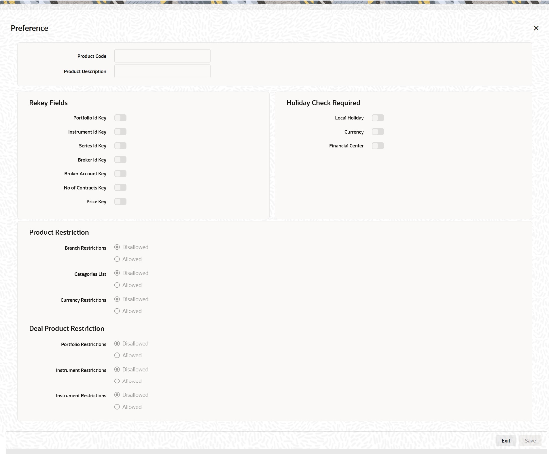

  4. On the Exchange Derivatives Deal Product Definition screen, click the Preferences tab.
    The Preference screen is displayed.
  5. Specify the fields in the Preferences screen.
    Table 6-2 Preference - Field Description
    Field Description
    Product Code
    System displays the product code.
    Product Description
    System displays the product code description.
    Rey-key Fields
    In Oracle Banking Treasury Management, all operations on a deal (input, amendment, modification, etc.) have to be authorized by a user other than the one who entered the deal details. These operations have to be carried out before the end-of-day activities have begun. Authorization is a way of checking the entries made by a user.
    Indicate that details of certain fields should be re-entered when a deal is invoked for authorization. The complete details of the deal is displayed only after the values to these fields are entered. The fields for which the values have to be given are called the Re-key fields.
    You can specify any or all of the following as re-key fields:
    • Broker Account
    • Instrument ID
    • Portfolio ID
    • Series ID
    • Broker ID
    • Number of Contracts
    • Price
    If no re-key fields are defined, the details of the deal involving the product will be displayed immediately when the authorizer calls the deal for authorization. The re-key option also serves as a means of ensuring the accuracy of inputs.
    Currency Restrictions
    Indicate whether you want to create a list of allowed currencies or disallowed currencies by selecting one of the following options:
    • Allowed
    • Disallowed
    Categories List
    Indicate whether you want to create a list of allowed customers or disallowed customers by choosing one of the following options:
    • Allowed
    • Disallowed
    • Allowed
    • Disallowed
    You can specify the authorization re-key fields through the Deal Product Preferences screen.
    Local Holiday
    Select this check box, to execute the local holiday validation of the date and movement of schedules.
    Currency
    Select this check box, to execute the currency holiday calendar validation of the dates and movement of schedules.
    Financial Center
    Select this check box, to execute the financial center holiday calendar validation of the dates and movement of schedules.
