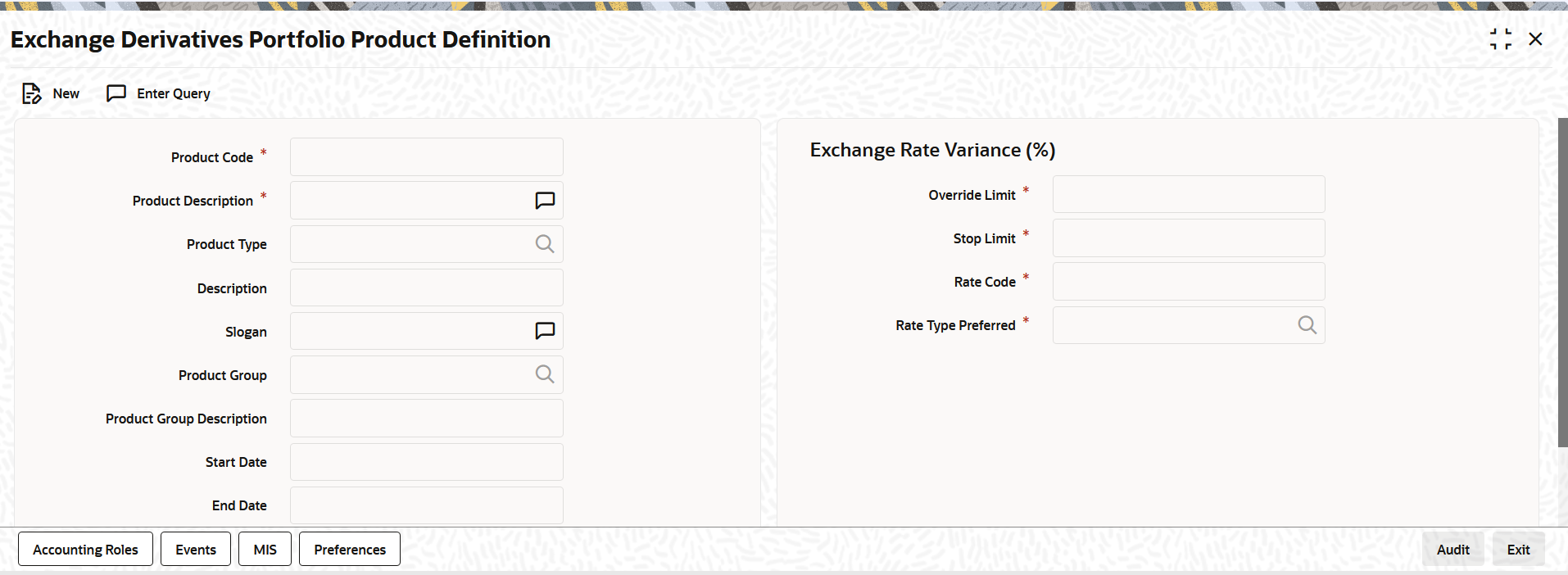

- On the Home page, enter EDDPFPRD
in the text box, and then click next arrow.
The Exchange Derivatives Portfolio Product Definition screen is displayed.
Figure 5-1 Exchange Derivatives Portfolio Product Definition
Description of "Figure 5-1 Exchange Derivatives Portfolio Product Definition" - On the Instrument Definition screen, click New.
- On Instrument Definition screen, specify the following
Instrument Details, and then click Enter Query.
For more information on the fields, refer to the below Field Description table.
Table 5-1 Instrument Definition - Field Description
Field Description Product Code and Product Description You can identify a product that you maintain with a unique Product Code, and a brief description.
In the Product Code field, you must assign the product a unique code (which is unique across all the modules of Oracle Banking Treasury Management). This code helps in identifying the product. You can briefly describe a product that you create in the Description field.
Product Module The services that you offer in a module will be specific to the module. For example, a portfolio maintenance scheme is specific to the ETD (Portfolio) module. To view the module in which you are creating a product in the Product Module field.
Product Type The first attribute that you define for a portfolio product is its type. You can broadly classify portfolio products into two types:
- Customer Portfolio (C) – the definition and maintenance of customer portfolio products help you manage your customer’s trades and investments.
- Own Portfolio (O) – the definition and maintenance of Own portfolio products help you manage your banks own trades and investments.
Under each type you can create multiple portfolio products.
Product Slogan Type a slogan for the product that you are creating. In the Slogan field enter a slogan that suitably announces the product to your customers.
If you are creating your own portfolio, you can identify it with an appropriate slogan for your bank’s internal reference purposes.
Product Group Grouping products according to the common features they share, helps you organize information relating to the services you provide. This helps you retrieve information easily.
You can invoke a list of all the product groups that you have maintained in your bank. Choose the product group to which the product you are creating belongs.
Product Start Date and End Date When you create a product, you must also specify a date from which it can be offered. You may also specify the date up to which you would like to offer the product. Enter these dates in the Start Date and End Date fields.
Note: You cannot offer a product beyond the specified end date. If you do not specify an end date for a product, you can offer it for an indefinite period.
Remarks If you want to enter any remarks regarding the product, do so in the Remarks field.
- On the Exchange Derivatives Portfolio Product Definition
screen, specify the other Details for the Portfolio Product

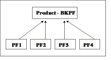

Let us assume that your bank has maintained a portfolio product titled BKPF. Since a product can have multiple portfolios, you have maintained several portfolios within BKPF. Each of these portfolios will cater to specific instrument types.
Figure 5-2 Portfolio Product – Portfolio Relationship Diagram
The portfolio PF1 is meant for deals involving Currency and Index Options
As per the preferential hierarchy method, the role to head mappings specified for this product is as follows:

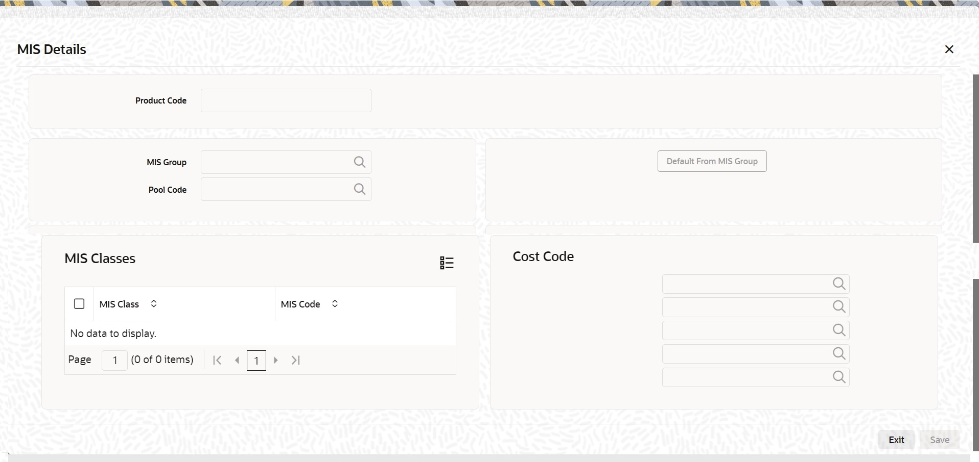

- On Exchange Derivatives Portfolio Product Definition
screen, click the MIS tab.
The MIS Details screen is displayed.
Through the MIS product details screen you can link the product to transaction MIS codes. The transaction codes linked to the portfolio product are defaulted to all the portfolios involving the product.
For more details on MIS Details screen, refer MIS User Manual.

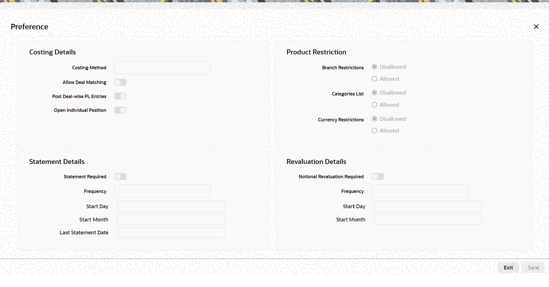

screen, click the Preferences tab.The Preferences screen is displayed.
Table 5-14 Preferences - Field Description
Field Description Costing Method costing method is used to determine your holding cost in a portfolio. Based on the preference of your bank you can select an option from the option list: The costing methods are as given below:- Weighted Average Cost (WAC)
- Last in first out (LIFO)
- First in first out (FIFO)
- Deal matching (DMAT)
Allow Deal Matching Select this box to indicate that intra-day manual matching should be allowed, even though the costing method selected is FIFO or LIFO.
This check box is enabled only when costing method selected is ‘FIFO/LIFO’. For any other costing method, this is disabled.
Open Individual Position Select this box to indicate that accounting entries for opening and closing of positions should be posted individually for each deal, when the costing method is DMAT.
This checkbox is enabled only when costing method selected is ‘DMAT’. For any other costing method, this is disabled.
Post Deal -wise PL Entries Select this box to indicate that accounting entries for realized PL should be posted individually for each pair of deals matched, when the costing method is FIFO, LIFO or DMAT.
This checkbox is enabled only when costing method selected is ‘FIFO/LIFO/DMAT’.
