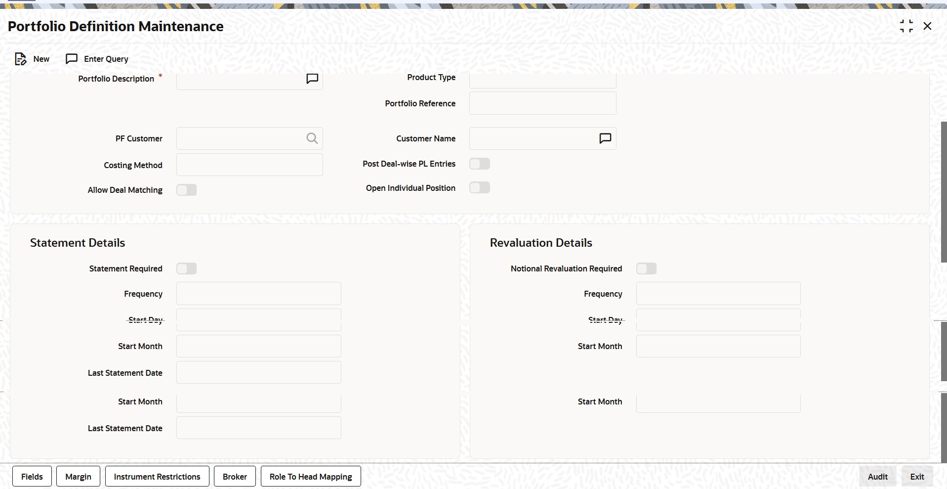

- On the Home page, type EDDPFMNT in the text box, and then click next arrow.
The Portfolio Definition Maintenance screen is displayed.
Figure 5-9 Portfolio Definition Maintenance
Description of "Figure 5-9 Portfolio Definition Maintenance" - On the Portfolio Definition Maintenance screen, click New.
- On the Portfolio Definition Maintenance screen, specify the following details, and then click Enter Query.
For more information on the fields, refer to the below Field Description table.

Notional Revaluation required Check the box Notional Reval Reqd. to indicate the portfolio has to be revalued notionally.
Frequency If you have indicated that the portfolio has to be revalued notionally, you have to specify the frequency at which it has to be revalued. The options available are as follows:
- Daily
- Monthly
- Yearly
In the case of monthly, quarterly, half yearly or yearly revaluation, you should specify the date on which the revaluation should be done during the month. For example, if you specify the date as ‘30’, revaluation will be carried out on that day of the month, depending on the frequency.
If you want to fix the revaluation date for the last working day of the month, you should specify the date as ‘31’ and indicate the frequency. If you indicate the frequency as monthly, the revaluation will be done at the end of every month -- that is, on 31st for months with 31 days, on 30th for months with 30 days and on 28th or 29th, as the case may be, for February.
If you specify the frequency as quarterly and fix the revaluation date as 31, the revaluation will be done on the last day of the month at the end of every quarter. It works in a similar fashion for half-yearly and yearly revaluation frequency.
If you set the revaluation frequency as quarterly, half yearly or yearly, you have to specify the month in which the first revaluation has to begin, besides the date on which the revaluation should be done.
For example, let us assume that the revaluation date falls due on 31 June, which happens to be a holiday. The system completes the revaluation on the 30 June, which happens to be a working day.
Statement Details Specify the Statement Details. Frequency
If you have indicated that a Statement of holdings and transaction should be generated for the customer portfolio, you have to indicate the frequency with which a statement should be generated.
The frequency that you specify can be:
- Daily
- Monthly
- Quarterly
- Half-yearly
- Yearly
Based on the frequency that you specify you can also indicate the start date and month for the generation of the statement. The system generates a statement of holding and transactions automatically, as part of the end of cycle processing based on the preferences that you specified here.
When the statement generation date falls on a holiday, the statement is generated on the next working day after the holiday.
You have selected the half-yearly option and specified the start date as 31 and the start month as June.
The first revaluation will be done on 30 June for the period from January 1 to June 30, and the second one on 31 December for the period from 1 July to 31 December.
If the revaluation date falls on a holiday, the system does the revaluation on the previous working day before the holiday.

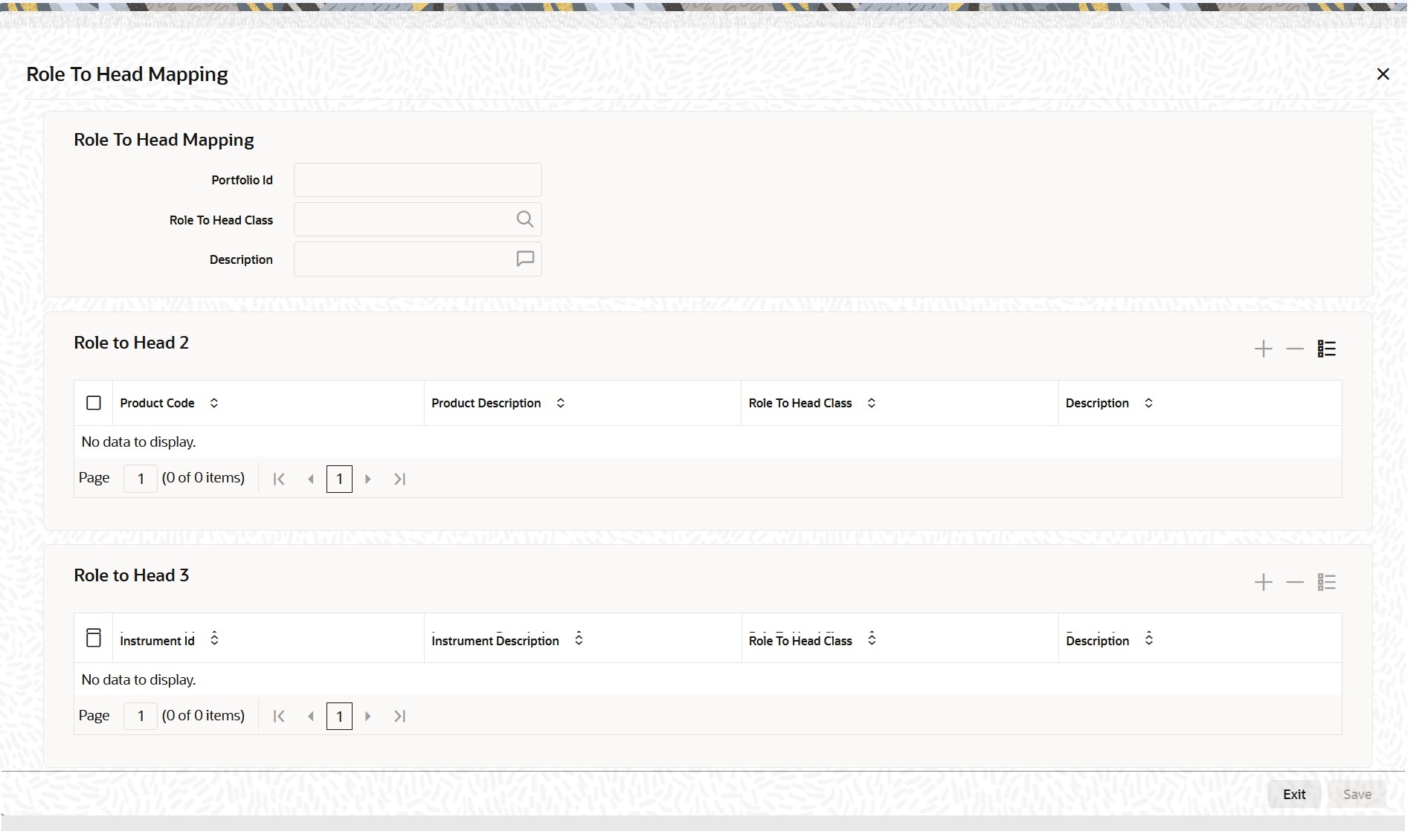

- On the Portfolio Definition Maintenance screen, click the Role to Head tab.
The Role to Head Mapping screen is displayed.
In the Portfolio Role to Head Mapping screen, you can link accounting Role to Head mapping classes with any of the following:
- Portfolio and an Instrument ID
- Portfolio and an Instrument Product
- Portfolio ID
For a detailed procedure on:
- How to map Accounting Roles to Account Heads, or
- How to link an accounting class with any of the three levels.
Refer to the Common Procedures User Manual of Oracle Banking Treasury Management.

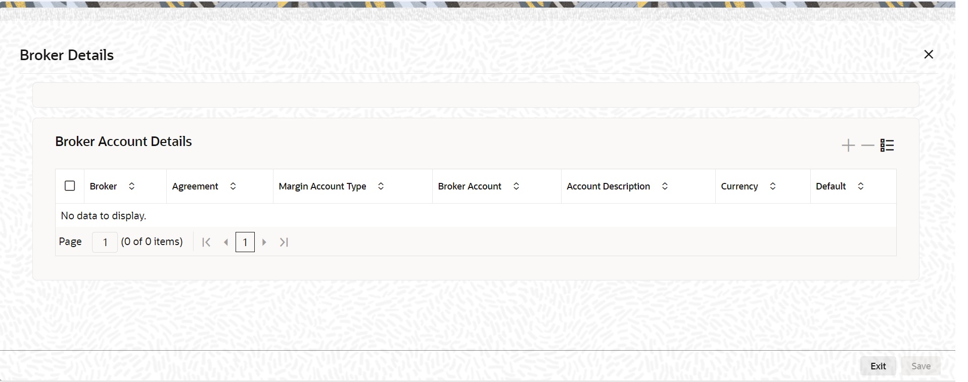

- On the Portfolio Definition Maintenance screen, click the Broker tab.
The Broker Details screen is displayed.
Annexure A lists all the possible accounting entries for your banks and customer portfolios.
Through the Portfolio Broker Account Linkage screen you can:
- Identify the brokers that are to be associated with the portfolio.
- Identify broker accounts and map them to relevant Broker codes.
