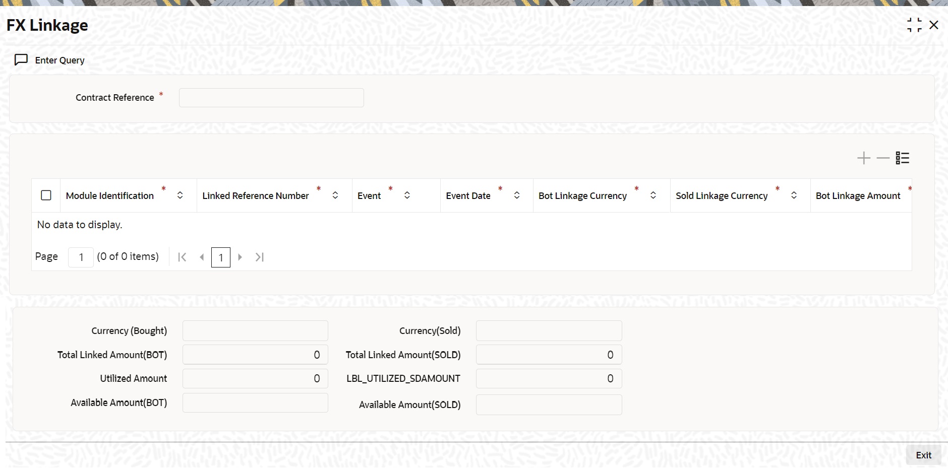

  1. On the Foreign Exchange Contract Online screen, click FX Linkages button.
    FX Linkage screen is displayed.
  2. Following details will be defaulted by the system:
    For more information on the fields, refer to the below table.
    Table 5-11 FX Linkage - Field Description
    Field Description
    Module Identification
    The system displays the external module id.
    Linked Reference Number
    The system displays the external reference number for which you are maintaining the linkage.
    Event
    The system displays the event. It can be any of the following:
    • Linkage
    • De-linkage
    • Utilization
    • De-Utilization event
    Event Date
    The system defaults the date of the event
    Bot Linkage Currency
    The system defaults the bought linkage currency
    Bot Linkage Amount
    The system defaults the bought linkage amount
    Sold Linkage Currency
    The system defaults the sold linkage currency.
    Sold Linkage Amount
    The system defaults the sold linkage amount
    Utilization Amount
    The system defaults the bought or sold amount liquidated for the contract linked.
    Reject Reason
    The system defaults the reject reason for payment reversal during DUTL operation
    Total Linked Amount (BOT)
    The system derives the total bought linked amount
    Total Linked Amount (SOLD)
    The system derives the total sold linked amount
    Total Utilized Amount (BOT)
    The system defaults the total bought amount liquidated for the contract linked.
    Total Utilized Amount (SOLD)
    The system defaults the total sold amount liquidated for the contract linked.
    Available Amount (BOT)
    The system derives and defaults this amount as the difference between FX transaction bought amount and the amount already linked to any external application contract.
    Available Amount (SOLD)
    The system derives and defaults this amount as the difference between FX transaction sold amount and the amount already linked to any external application contract.
