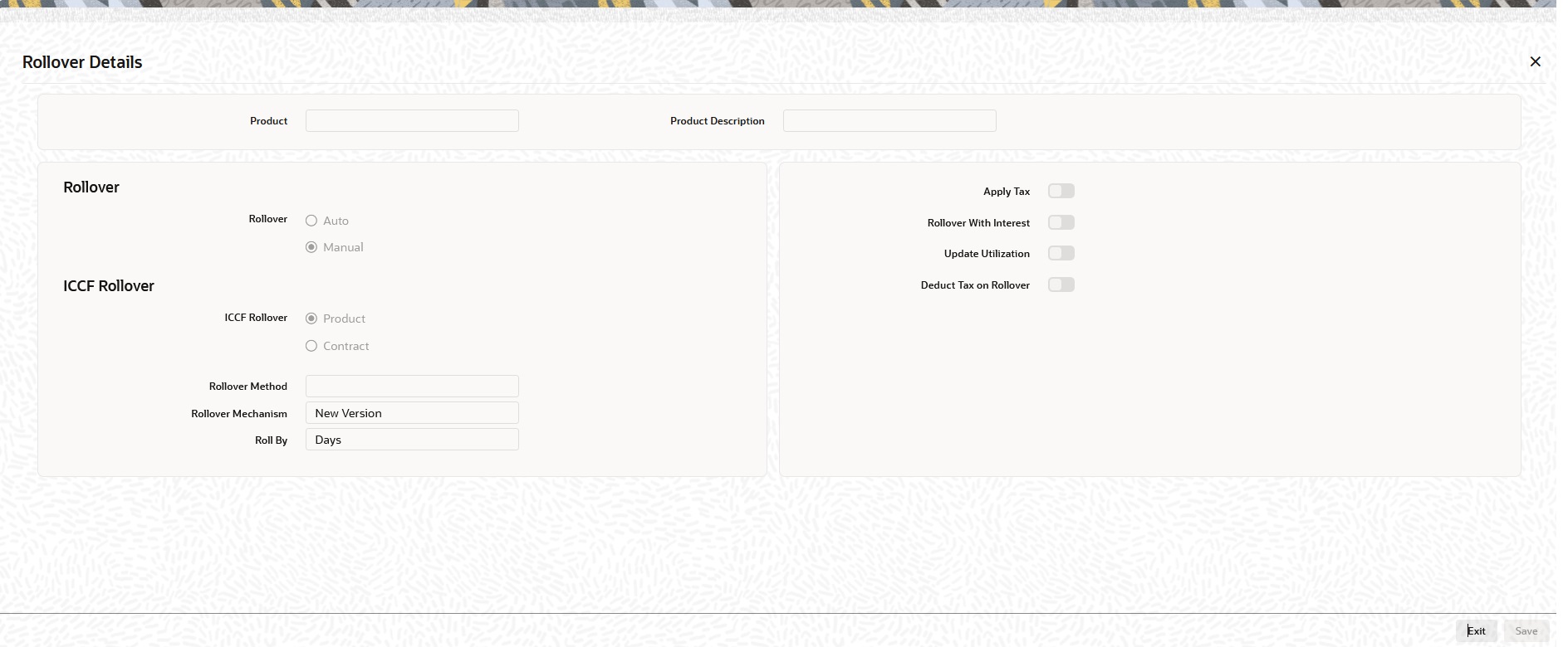

- On the Product Preferences screen, click Rollover.
Rollover details screen is displayed.
- On the Rollover details screen, specify the details as required.
- Click Ok to save the details or click Exit to close the screen.
For information on the fields, refer to the below table.
Table 6-2 Rollover details - Field Description
Field Description Mode of Rollover
For deals involving a product for which a rollover is allowed, you should specify the mode of rollover - automatic or manual - during processing.
A deal is automatically rollover on the maturity date if ‘Auto’ is selected at the product level.
If you choose ‘Manual’, on the maturity of a deal, you will need to indicate for rollover manually.
ICCB Rollover

Roll By
Indicate the tenor basis upon which the maturity days specified for the rolled-over contract is reckoned. The options are Days, Months, Quarters, Semi-annuals and Years.
If you specify the ‘days’ maturity basis, and do not specify the maturity days, the system ‘rounds’ the tenor of the original contract to the nearest maturity days basis. The rounded tenor is considered as the new tenor of the rolled-over contract.
Rollover Mechanism
This indicates whether rolling over a contract using the product must create a new version of the existing contract, a new contract or a chills contract that is linked to the parent contract. You can choose from the following options:
- New Version - A new version will get created in existing MM deal as part of a rollover, with the same details specified in the contract ‘Rollover Details’ screen.
- Spawn Contract - In this mechanism, the existing contract will get liquidated, and the system will book a new contract as part of a rollover, with the details specified in the contract ‘Rollover Details’ screen. Booking of the new contract happens through the MMAUTDLY batch.
- Linked Contract - In this mechanism, a new MM deal is created manually and linked to the parent deal. On the maturity date of the parent contract, the contract will get liquidated into a rollover wash GL, and the new contract that was input will get initiated automatically.
You can select ‘Linked Contract’ only in case you have checked the option ‘Auto’ for rollover.
Rollover Method
If you have indicated the rollover mechanism applicable for contracts using the product in the Rollover Mechanism field as ‘Spawn Contract’, use this field to indicate whether a single new contract must be created for the rolled over amount, or whether the original contract must be split into multiple contracts, or consolidated with other contracts into a single new contract, when rolled over using the rollover operation. Accordingly, select any of the options, ‘Normal’, ‘Split’ or ‘Consolidated’, in this field, as applicable.
