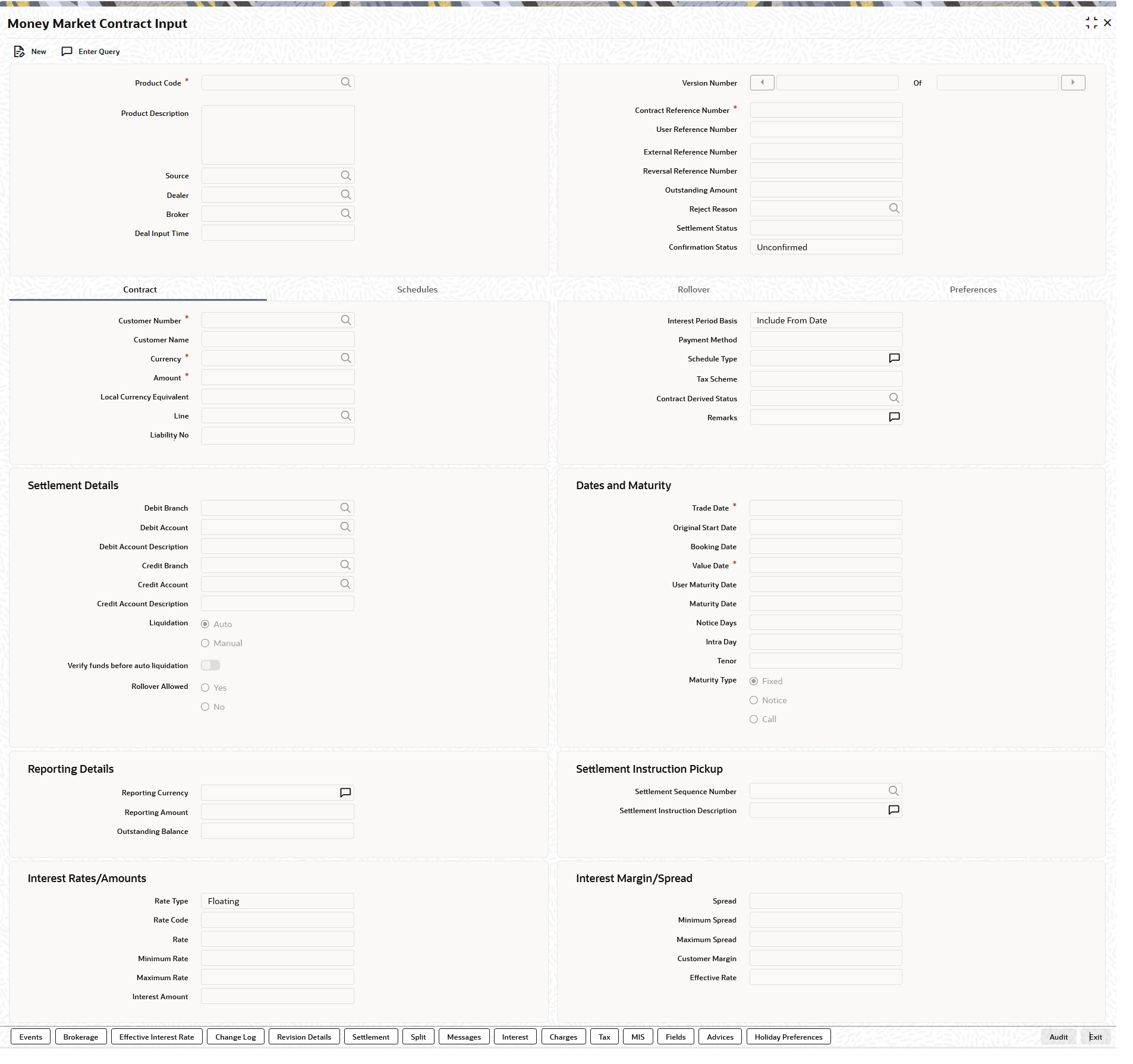

This topic provides the instructions to capture the details of Money Market Contract Input.
- On the Home page, type
MMDTRONL in the text box, and click the next arrow.
Money Market Contract Input screen is displayed.
- On the Money Market Contract Input screen, specify the
following information:

For information on fields, refer to the below table.
Table 3-2 Contract Details - Field Description
Field Description Product Code
This is a Mandatory field.
Every deal that you enter into would involve a specific service that you offer (which you have defined as a product). When processing a deal that you enter into, you should specify the product that it involves.
All the attributes of the product that you specify will apply to the deal. However, you can change some of these attributes while entering the details of the contract. When you specify the product, the product type - placement or borrowing - is displayed.

If you have specified auto liquidation for the deal, liquidation will be done automatically on that date. If manual liquidation has been specified, you will have to manually liquidate the deal through the Manual Liquidation function.
For a deal with Fixed Maturity Type, this date can either be extended or brought backward through the Value Dated Changes function, once the deal has been initiated.
Reporting Currency
Select the reporting currency from the option list.
Reporting Amount
The system displays the amount.
Outstanding Balance
The system displays the total amount due as of the value date.
Settlement Sequence Number
Choose a settlement instruction by specifying a settlement sequence number. You can skip this field if any default settlement instruction is already specified.
Note: At the time of specifying settlement instructions, it is now possible to choose from multiple instructions that are maintained for the same branch, customer, currency, module and product combinations. You can choose any settlement instruction from a list of values. The list of values displays the Settlement Sequence Number and Settlement Instruction Description.
Specifies the description of the selected settlement instruction.
Rate Type
The rate type applicable for the selected product will be displayed. It can be one of the following:
Fixed: a fixed interest rate
Floating rate: an interest rate that changes periodically or automatically as per your specifications in the Floating Rate Table
Special: an amount instead of a rate. You cannot modify the displayed value.
Rate Code
For Floating Rate, the rate code will be displayed. You cannot modify it.
Rate
The Rate applicable for the selected product will be displayed. You cannot modify it.
Max Rate & Minimum Rate
The maximum and minimum rate allowed for the selected product will be displayed. You cannot modify it.
Customer Margin
The margin specified at customer level will be displayed here. You cannot modify it.
Interest Amount
The interest amount for the selected product will be displayed. You cannot modify it.
Interest Margin/Spread
The following are Interest Margin/spread details:
Spread
The spread value for the selected product is displayed as specified in the product level. You can modify it.
Minimum Spread & Maximum Spread
The maximum and minimum spread that is applied for the selected product is displayed. You cannot modify it.
Note: This spread should be greater than or equal to the Minimum Spread and less than or equal to the Maximum Spread defined for the product involved in the deal. If the spread you apply happens to be greater than the Maximum Spread, then the Maximum Spread is applied on the rate. On the other hand, if it is less than the Minimum Spread defined for the product, the Minimum Spread is picked up. For a floating rate, the spread is applied over the market rate applicable for the day.
Negative Interest Rates
Negative fixed rates or resolved rates is allowed in the MM contract or amendment only if negative interest is allowed for the main interest component. You can maintain the contract interest rate (negative or positive) against main interest component only.
If the effective interest rate is negative, then it is internally assigned to negative interest component, and you have to set up accrual and liquidation entries for the negative interest component. Special interest amount and negative interest amount will not be allowed in Interest Amount and Acquired Amount fields of ICCB screen respectively.
If negative interest is not allowed for a product and if the effective rate becomes negative during batch rate revision, then the rate revision is skipped for the contract and exception will be logged.
