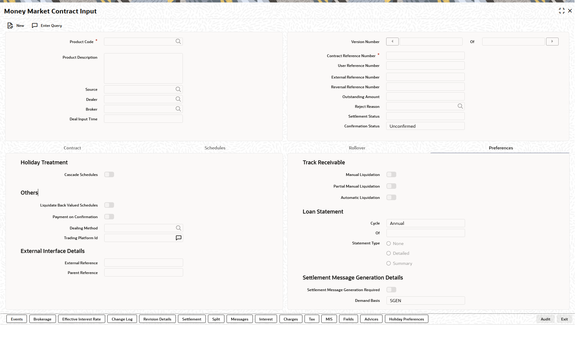

- On the Money Market Contract Input screen, click Preferences.
Money Market Contract Input with Preferences details are displayed.
Figure 3-6 Money Market Contract Input - Preferences
Description of "Figure 3-6 Money Market Contract Input - Preferences" - On the Money Market Contract Input screen with Preferences details, specify the details as required.
The contract inherits preferences from the associated product.
Refer to the topic for detailed explanations on the preferences.
The preferences that are available at the time of entering the contract details are explained in
