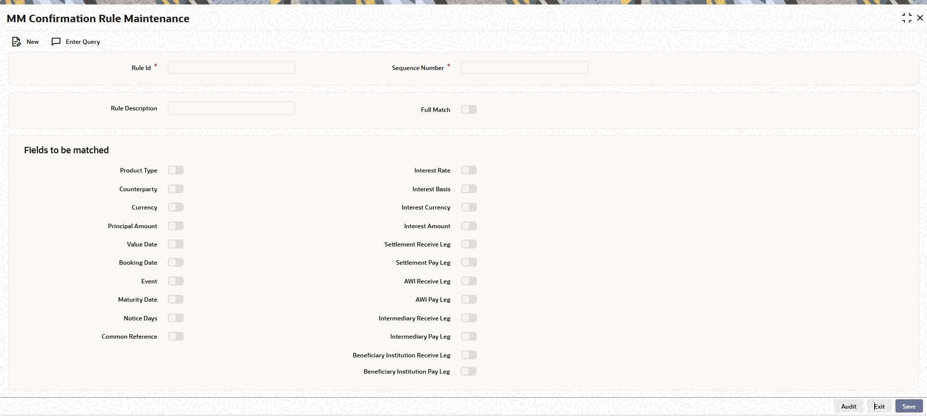

Maintain confirmation rules for MM deals in MM Confirmation Rule Maintenance screen. The auto-matching of confirmation messages is based on these confirmation rules maintained in this screen.
  1. On the Home page, type MMDCNFMTin the text box, and click the next arrow.
    MM confirmation Rule Maintenance screen is displayed.
    Figure 3-17 MM Confirmation Rule Maintenance
    Description of Figure 3-17 follows
    Description of "Figure 3-17 MM Confirmation Rule Maintenance "
  2. On the MM Confirmation Rule Maintenance screen, specify the details as required.

    Specify the sequence number for the rule. If there are multiple rules, then auto matching of the messages are processed based on the sequence number in an ascending order.
    Full Match
    Check this box to indicate that the confirmation rule maintained is a full match rule.

    Fields to be Matched
    You can enable the following fields to match the details of an incoming SWIFT confirmation message MT320/ MT330 with an existing deal in Oracle Banking Treasury Management.

    If multiple contracts are matched then the message is marked as Partially Matched.
