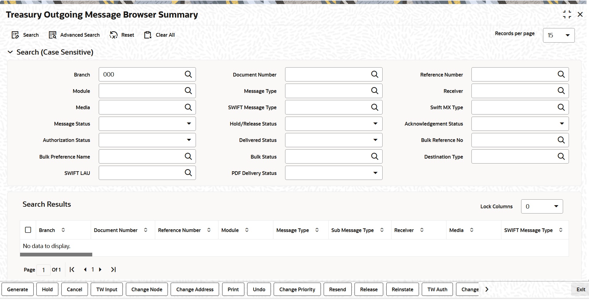

This topic provides systematic instructions for generating messages from an outgoing browser.
- On Homescreen, specify MSSTROBR in the text box, and click Next.Treasury Outgoing Message Browser Summary screen displays.
Figure 5-1 Treasury Outgoing Message Browser Summary
Description of "Figure 5-1 Treasury Outgoing Message Browser Summary" - On Treasury Outgoing Message Browser Summary screen, specify the details.

Bulk Preference Name Specify bulk preference name. SWIFT LAU Specify the SWIFT LAU details. - Click the Search button.The system identifies all outgoing messages satisfying the specified criteria and displays the following details for each outgoing message:

- Check the box against the message(s) for which needs to perform an operation and then click the corresponding operation. The operations that can be performed on an outgoing message are determined by the rights that are assigned with at Security Management System (SMS) level. If a function in the Outgoing Browser is disabled, then the function is not allowed for the record. The action performed will require authorization, if maintained at the Messaging Branch Preferences level. The system allows only Print, View and Detail actions for messages generated by External Payment system. The following operations can be performed on the outgoing messages:
