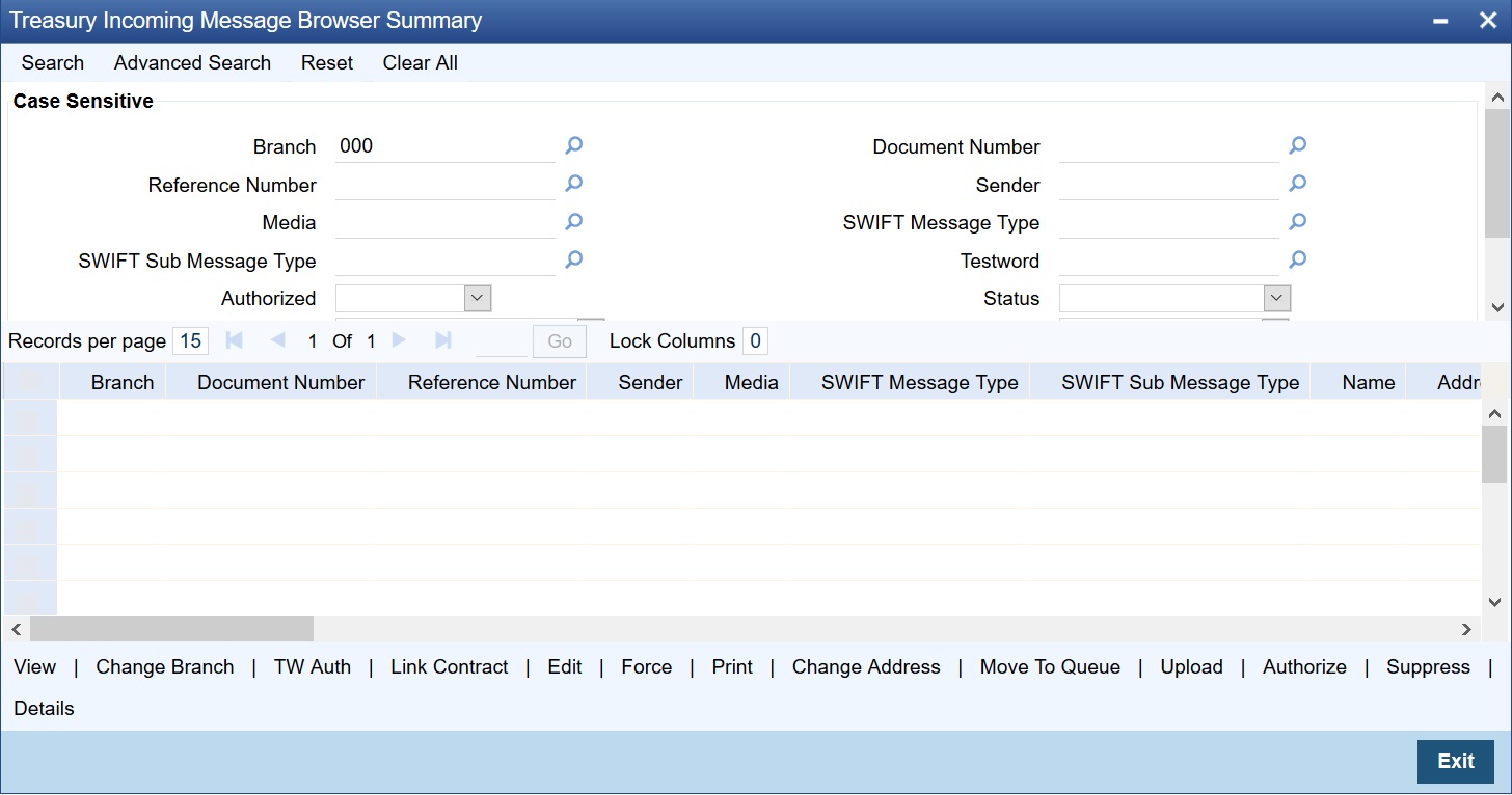

  1. On Homescreen, specify MSSTRIBR in the text box, and click Next.
    Treasury Incoming Message Browser Summary screen displays.
    Figure 7-1 Treasury Incoming Message Browser Summary
    Description of Figure 7-1 follows
    Description of "Figure 7-1 Treasury Incoming Message Browser Summary"

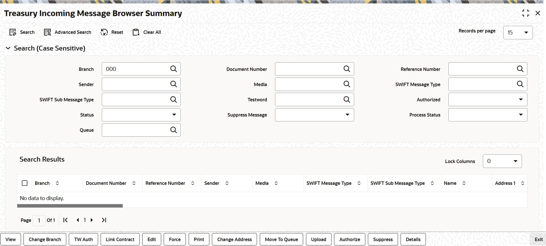

  2. On Treasury Incoming Message Browser Summary screen, specify the details.

  3. Click the Search button to view the details.
    The system identifies all incoming messages satisfying the specified criteria and displays the following details for each incoming message:
