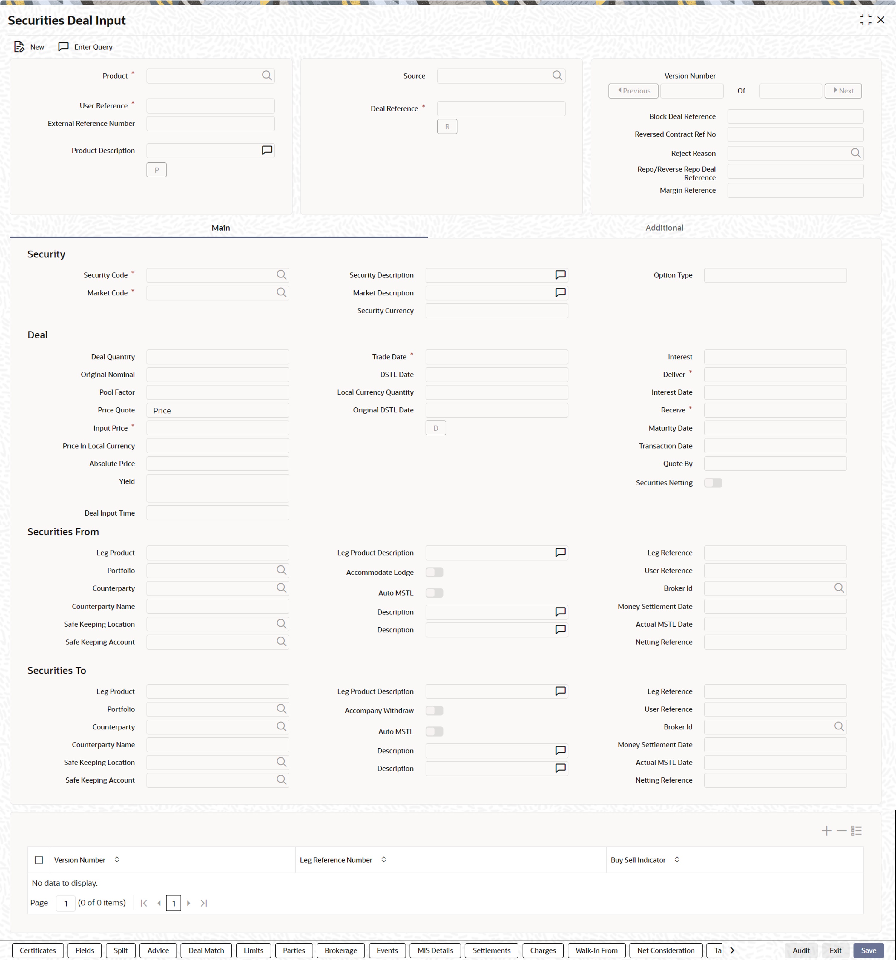

- On the Home page, specify SEDXDLNL in the text box, and click next arrow.
Securities Deal Input screen is displayed.
If you are calling a deal that has already been created, choose the Deal Input Summary option. The details of all the deals that you entered earlier will be displayed in a tabular form. From the summary screen, you can open an existing deal by double clicking it.
- On the Security Deal Input screen, specify the fields.
The securities deal input screen, as it appears contains a header and a footer containing fields that are specific to the deal you are entering. Besides these, you will also notice two tabs and an array of icons, along the lines of which you can enter details of a securities deal.

Security Code
While entering the details of a deal, you should indicate the security that the deal involves and the market in which it is traded. You can select a security code from the pick-list. The pick-list contains a list of all the securities that you maintained in the Securities Definition screen. The trading in the security should be allowed for the portfolios involved in the deal.
As you have already maintained details of the security, all the features of the security like its price, the quotation method, the corporate actions that it involves and several other details of the security will be processed based on these details. After you indicate the securities that are being traded in the deal, you can indicate the market in which they are traded. The market in which the security is traded is defaulted from the Security Definition screen. You can change the default and select a market code from the pick-list available. The pick-list contains valid market codes maintained in the Market Definition screen.
Market Code
Indicate the market in which the security involved in the deal is traded. Select a market code from the option list. The option list contains valid market codes maintained in the Market Definition screen. The market in which the security is traded is defaulted from the Security Definition screen. You can change the default.
Rules for amendment
The entries made in this field can be amended before the deal is authorized. However, if amendment is required after authorization, you should reverse the deal and enter it again.
Deal Type
Indicate the type of deal you are processing. Using the Securities module of Oracle Banking Treasury Management, you can enter spot or forward deals. You can choose the appropriate option from the option list. A spot deal is one that settles on or before the spot date of the deal. A forward deal is one that settles on a date after the spot date of the deal.
Deal Quantity
Securities that are traded can be quoted in terms of:
- Units (100 units of a security), or
- As a Nominal (securities worth USD 5000).
The system will automatically compute the Deal Quantity for instruments with ‘Asset Backed Security’ checkbox checked.
Deal Quantity = Original Nominal * Pool Factor
The system will validate whether ‘Deal Quantity’ is the product of ‘Original Nominal’ and ‘ Pool Factor’. Otherwise, it will display an error message.
The price quotation method defined for the security in the security definition screen is defaulted. You can change the quotation method that is defaulted. The deal quantity that you specify should be expressed in the security quotation method.
Original Nominal
Specify the Original Nominal value. It indicates the basis for deal quantity or nominal for deals involving Asset Backed Security instruments.
Pool Factor
Specify the pool factor. It should be less or equal to one and should be lesser than the previous redemption factor and greater than the following redemption factor.
If the ‘Pool Factor’ is not provided, then the system will default the ‘Redemption Quantity’ as the ‘Pool Factor’ in the deal. If either of ‘Deal Quantity’ or ‘Original Nominal’ is not provided, then the system will derive the same using the ‘Pool Factor’.

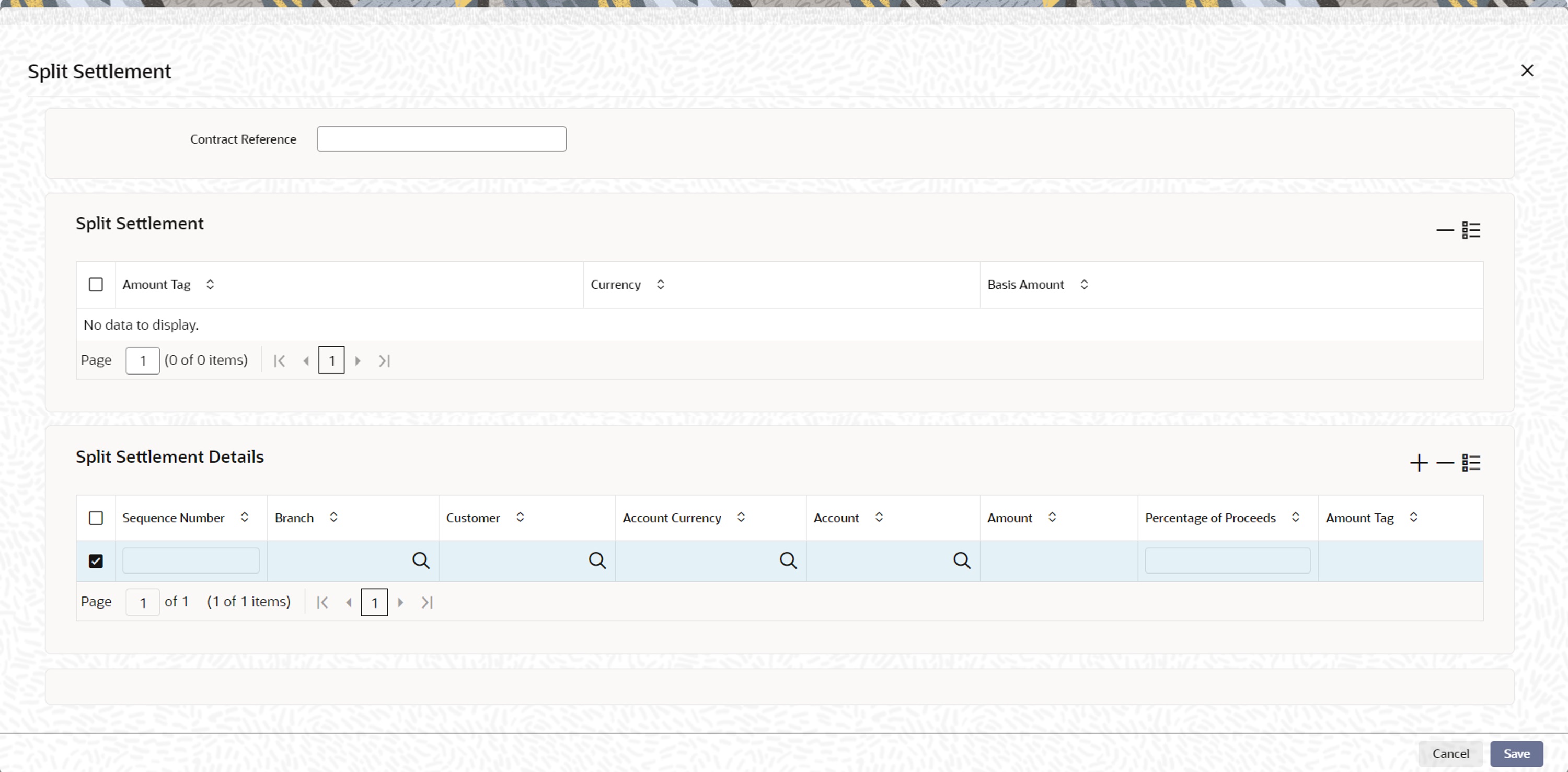

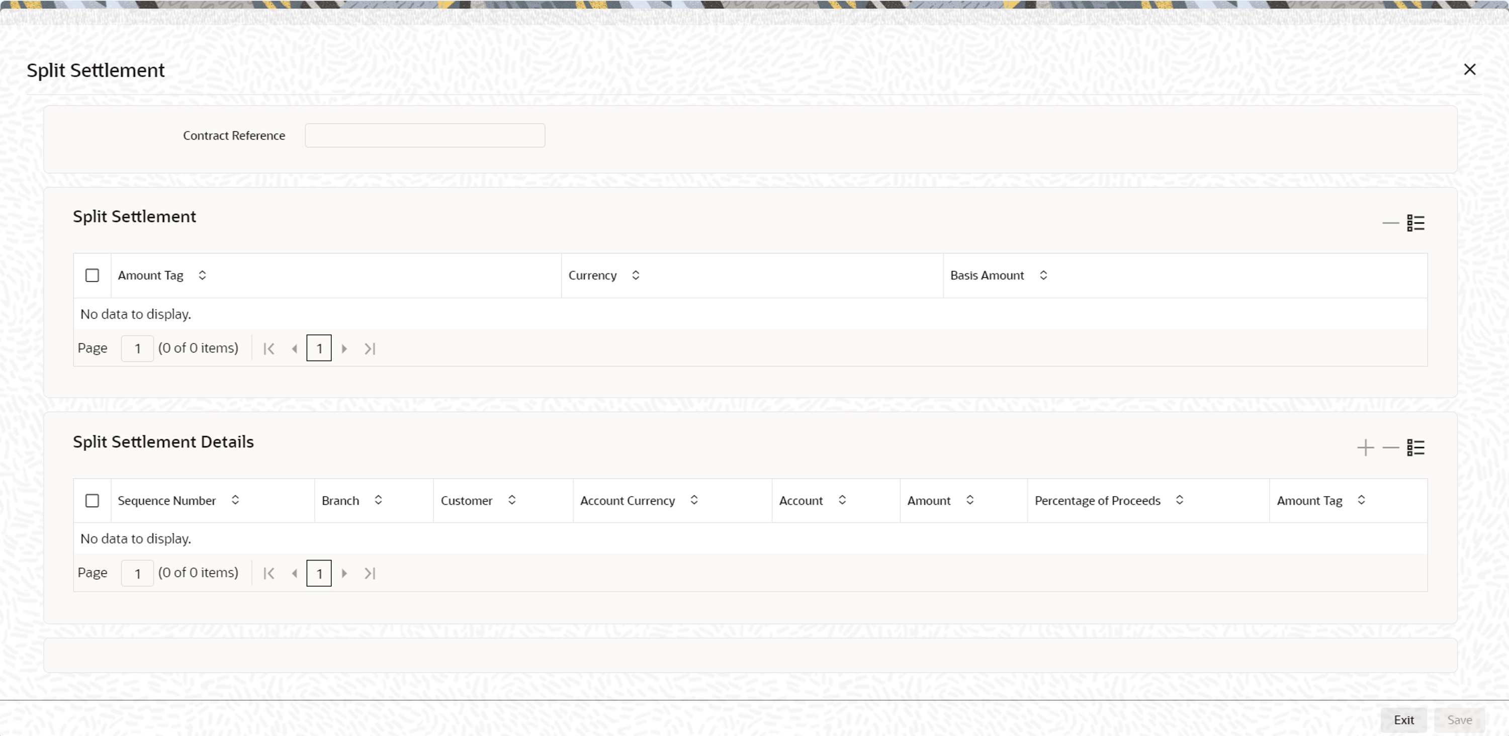

- On the Security Deal Input screen, click Split.
Split Settlement screen is displayed.
- On the Split Settlement screen, select a contract.
- On the Split Settlement screen, under the Split Settlement Details, click the + Icon.
Split Settlement screen with New Row added is displayed.
Figure 21-3 Split Settlement with a New Row
Description of the illustration splitsettlements_plus_symbol.jpgNote:
This process of splitting the settlements for a contract is allowed on the principal, Interest (Anticipated Interest for new contracts), and charges.
- On the Split Settlement screen, Select the Account Currency, Account, and, other necessary details as required to create a split.
- For every settlement contract the system allows a maximum of twelve splits.
- In case of auto-liquidation, you must unlock the contract and register the split, upfront, that is prior to auto-liquidation. You can update the split settlement for interest component after you save and authorize. SGEN is generated for each split amount. System will suffix the reference number in field 72 of MT202 and MT202COV with a hyphen followed by a running sequence number for each SGEN.
- Only if split settlement details are available, system will process the transaction accordingly, else the payment/settlement is treated as a single payment transaction
- If you are splitting the contract during the rollover, the application considers the latest available split details and process the liquidation amount, if any. If split settlement details are not available, the transaction (partial (liquidation as part of rollover) is treated as normal/regular/non-split liquidation. The split is allowed in manual rollover as well.
- For a single component, you can split the settlement amount and use the same settlement account more than once. There is no restriction on the repetition of split settlement amount for the same NOSTRO/settlement account.
- Cross currency split settlement is supported. The Amount field/column in the Split tab is, by default, in the contract currency (though not evident in the User Interface). The currency of the settlement account can be in a different currency. The converted amount has to be viewed in the accounting entries as part of Events tab only.
