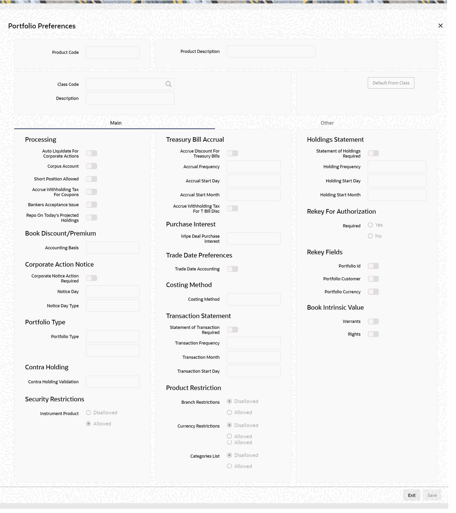

- On the Securities Portfolio Product Definition screen, click preference.
Product Preference screen is displayed.
- On the Product Preference screen, specify the fields.
Preferences are the options that are available to you for defining the attributes of a product. The following are examples of portfolio preferences.
- The Preferred Costing Method (Weighted Average, Deal Matching, FIFO, FILO)
- The Revaluation details (Basis, LOCOM Basis, Method, Frequency, and Start Date)
- The Forward Profit and Loss Accrual details
- The Premium/Discount Accrual details
- The Redemption Premium Accrual details
- Corporate Action Notice details
All portfolios maintained under a portfolio product will inherit the preferences that you define for the product.

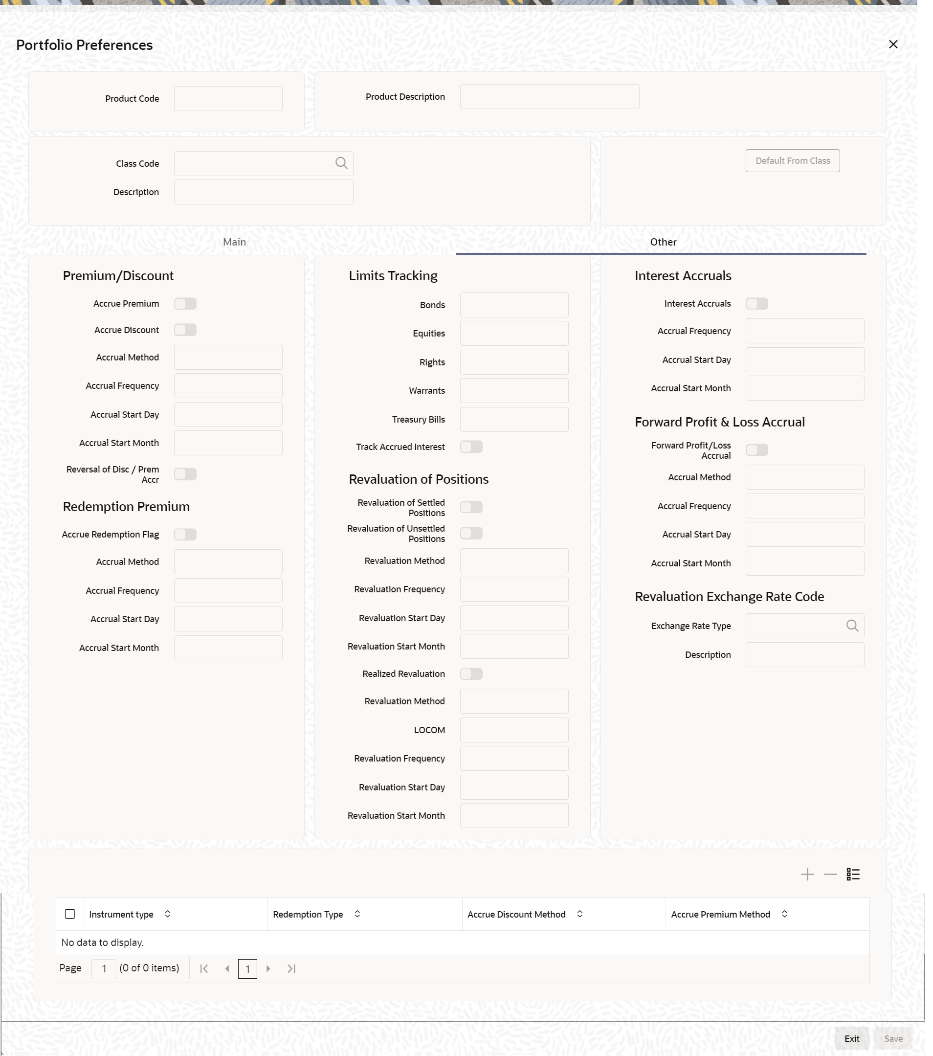

- On the Portfolio Preference screen, click Other.
Portfolio Preference screen is displayed.
- On the Portfolio Preference screen, specify the fields.
Table 15-3 Field Description
Field Description Accrue Discount Method Specify the accrue discount method. If you select the redemption type as bullet, then the system will allow you to select the discount method as constant yield /exponential / straight line/ weighted moving average. However, for any other type of redemption, you can select only the type as constant yield.
Accrue Premium Method Specify the accrue premium method. If you select the redemption type as bullet, then the system will allow you to select the discount method as constant yield /exponential / straight line/ weighted moving average. However, for any other type of redemption, you can select only the type as constant yield.
Reversal of Disc/Prem Accr Check this box to indicate that the premium or discount that has been accrued using the ‘Weighted Moving Average’ method should be reversed. If this is checked, the amortization accrual done using the ‘Weighted Moving Average’ method is reversed on the following BOD. During EOY, discount/premium accrual will be realized, that is, accrual will not be reversed as part of the same EOD/BOD batch (SEAUTDLY). This value is defaulted from the portfolio class level to the portfolio product level, where you can amend it. From the portfolio product level, it is defaulted to the portfolio definition level. Here too, you can amend it. The value at the portfolio definition level is considered as the final value and the reversal is determined by it.
