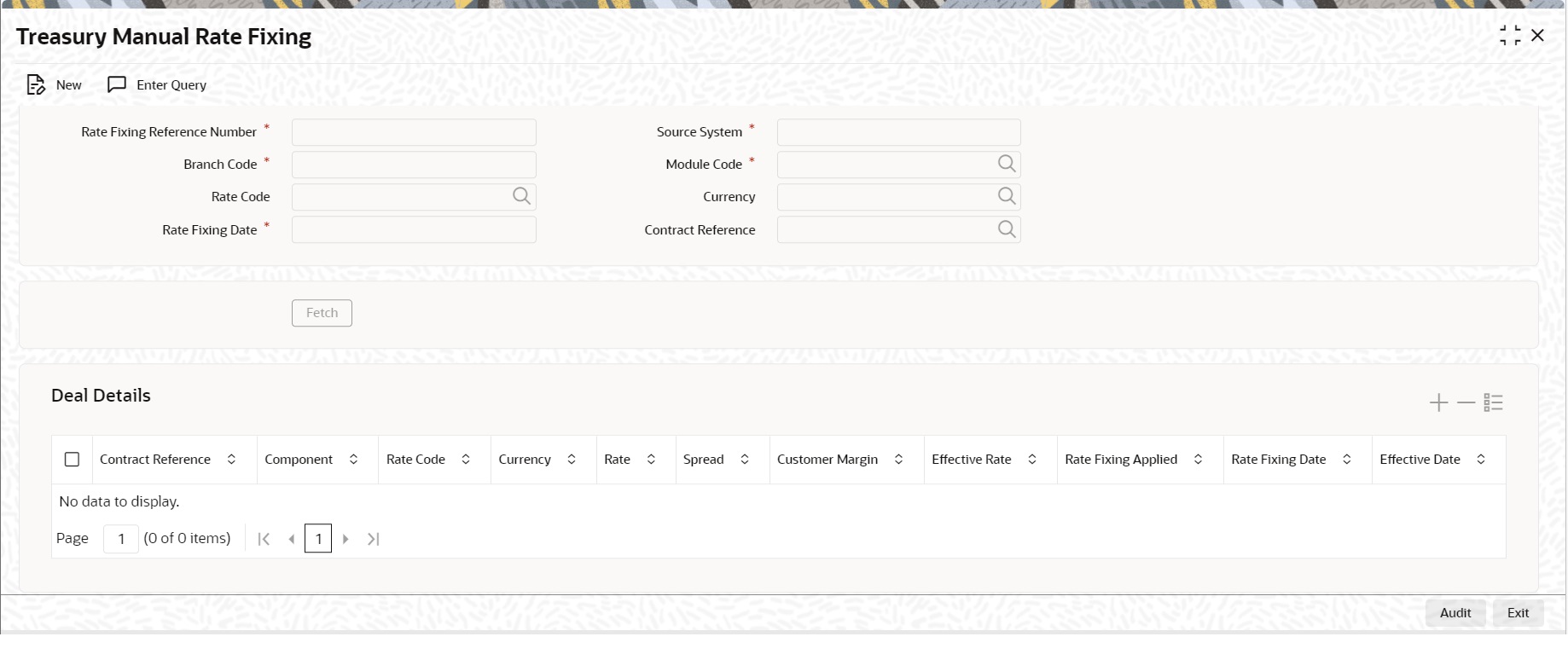

Use the Treasury Manual Rate Fixing to fetch the contracts which require rate fixing and also apply the rate fix on the selected float rate type contracts having the fixing date as the primary search criteria to query deals.
- On the homepage, type TRDMRTFX in the text box, and click the next arrow.
Treasury Manual Rate Fixing screen is displayed.
- On the Treasury Manual Rate Fixing screen, specify the details as required.
A scheduler job, TR_RTFX_UPLOAD is defined and scheduled to pick rate fixed records from the external system.For information on fields, see the below table

- The user has an option to process the rate fixing for the specific modules or specific rate code; all rate code; specific currency or all currency; specific branch or all branches.
- Rate fixing for the first interest period below the trade date of the transaction can be handled.
- Once all the details are provided the and the user click on Fetch, the contracts pending for rate fixing are fetched based on the conditions mentioned in the deal details field.
- For the contracts once rate fixing is applied, the same contract is not fetch again.
- The Final Effective rate is derived from the Rate, Spread, and Customer Margin.
- The Rate fixing event is triggered on authorization of the record.
- The confirmation message is generated for the contract (if applicable).
- The Rate fixing on back dated dates is supported from this screen, if rates are available.
- In case of a forward movement, rate is fixed after the effective date and interest catch up entries are posted during EOD processing.
- On Batch Processing, the Rate fixing event is processed on fixing date, only if the effective date floating rates are available. If rates are not available during processing, rate fixing event is skipped.
