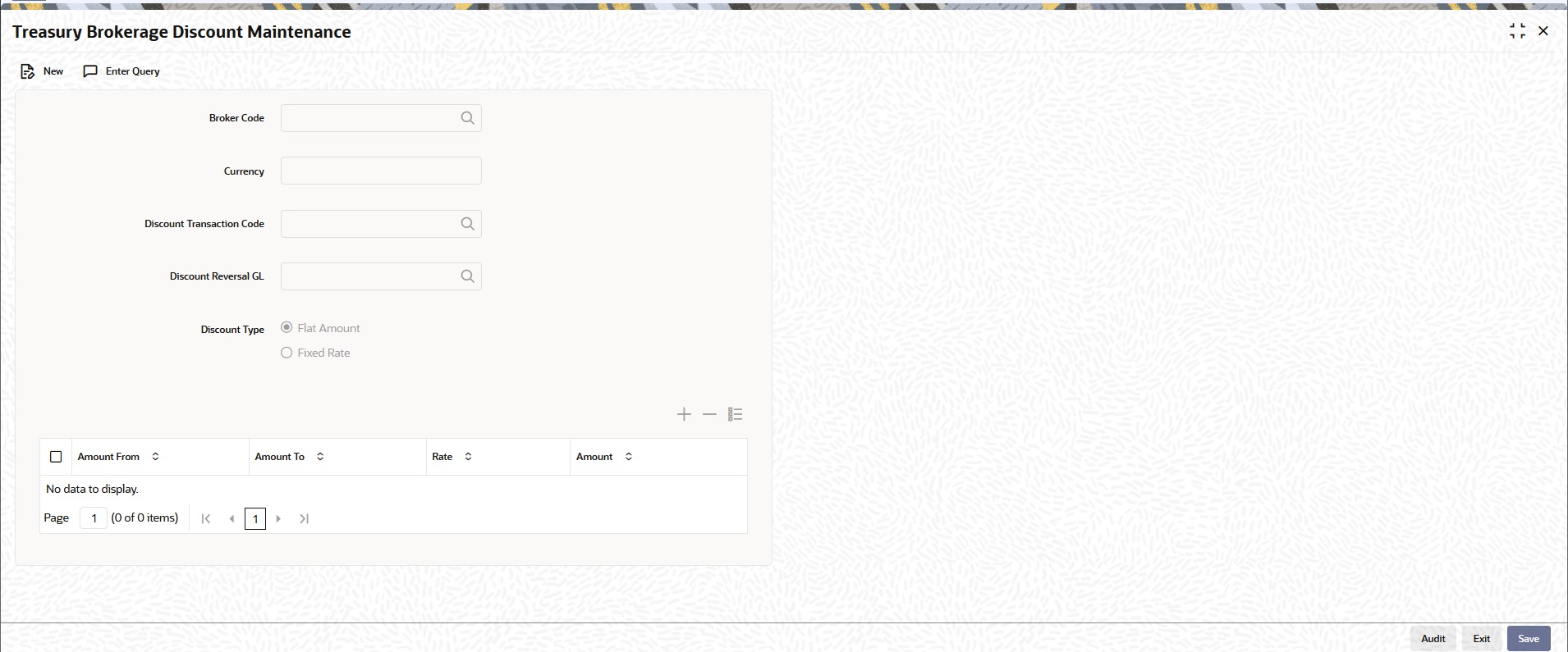

  1. On the Homepage, enter BRDDISCO in the text field and then click the next arrow.
    The Treasury Brokerage Discount Maintenance screen displays.
    Figure 1-6 Treasury Brokerage Discount Maintenance
    Description of Figure 1-6 follows
    Description of "Figure 1-6 Treasury Brokerage Discount Maintenance"
    All fields with (*) symbol are mandatory.
  2. On the Treasury Brokerage Discount Maintenance screen, specify the fields.
    Table 1-8 Treasury Brokerage Discount Maintenance- Field Description
    Field Description
    Broker Code
    Specify the broker for whom you are defining brokerage discounts. Click the option list and select a Broker Code from the option list.
    Currency
    Specify the currency code.
    Discount Transaction Code Select the transaction code that would be used to post volume discount entries, to the respective GL accounts.
    Discount Reversal GL Specify the code of the GL to which the discounted brokerage should be credited. Click on the option list and select a GL Code from the option list.
    Discount Type Select the discount type as Flat Amount or Fixed Rate
    Amount From Specify the lower limit of the amount slab.
    Amount TO Specify the upper limit of the amount slab. You can define brokerage discounts for several amount slabs. The range of the amount slab is determined by the entries you make in this field and the Amount To field. The amount of brokerage to be discounted is determined based on the slab into which the liquidated brokerage falls.
    Rate Specify the rate that should be applied if the liquidated brokerage amount falls within the amount slab you have defined. This field is applicable only if you selected Rate at the Discount Type field.
    Amount Specify the amount that should be discounted if the liquidated brokerage amount falls within the amount slab you have defined. This field is applicable only if you selected Amount at the Discount Type field.
