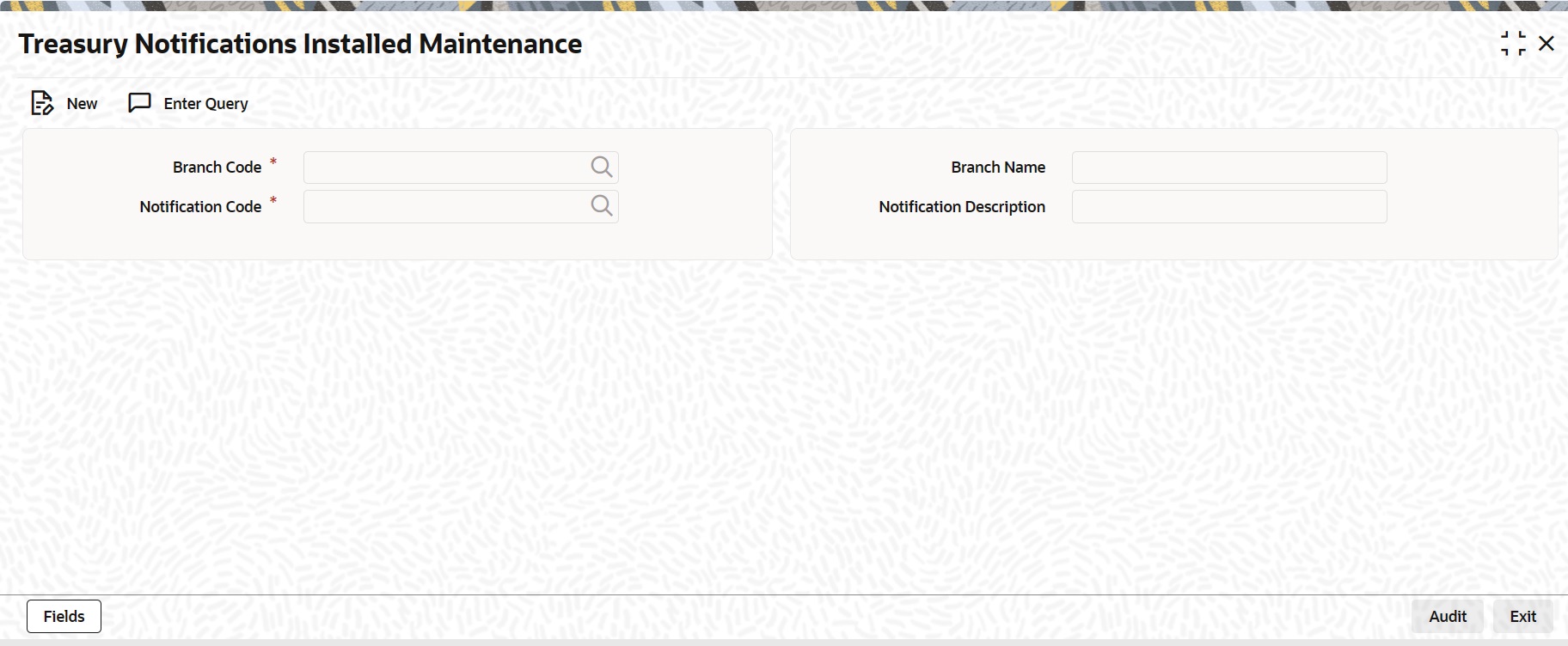

- On the Home page, specify TRDNTFIN in the text box, and click next arrow.The Treasury Notifications Installed Maintenance screen is displayed.
Figure 1-35 Treasury Notifications Installed Maintenance
Description of "Figure 1-35 Treasury Notifications Installed Maintenance" - On the Treasury Notifications Installed Maintenance screen, specify the fields.
For more information on fields, refer to the below table.
Table 1-33 Treasury Notifications Installed Maintenance - Field Description
Field Description Branch Code Select a branch code for which you wish to assign a notification code. Once you select the branch code, the corresponding description is displayed.
Branch Name Specify the name of the Branch.
Notification Code Select a notification code from the available list of values that you wish to link with the branch. This is used to generate notifications for the entire branch. Once you select the notification code, the corresponding description is displayed.
In addition to maintaining a notification code for a given branch, you can also specify a topic or a queue to which the notification messages should be sent. You can define a topic/queue for a given branch and notification code in the Treasury Notifications Enroute Maintenance screen.
Notification Description
Specify the notification description.
