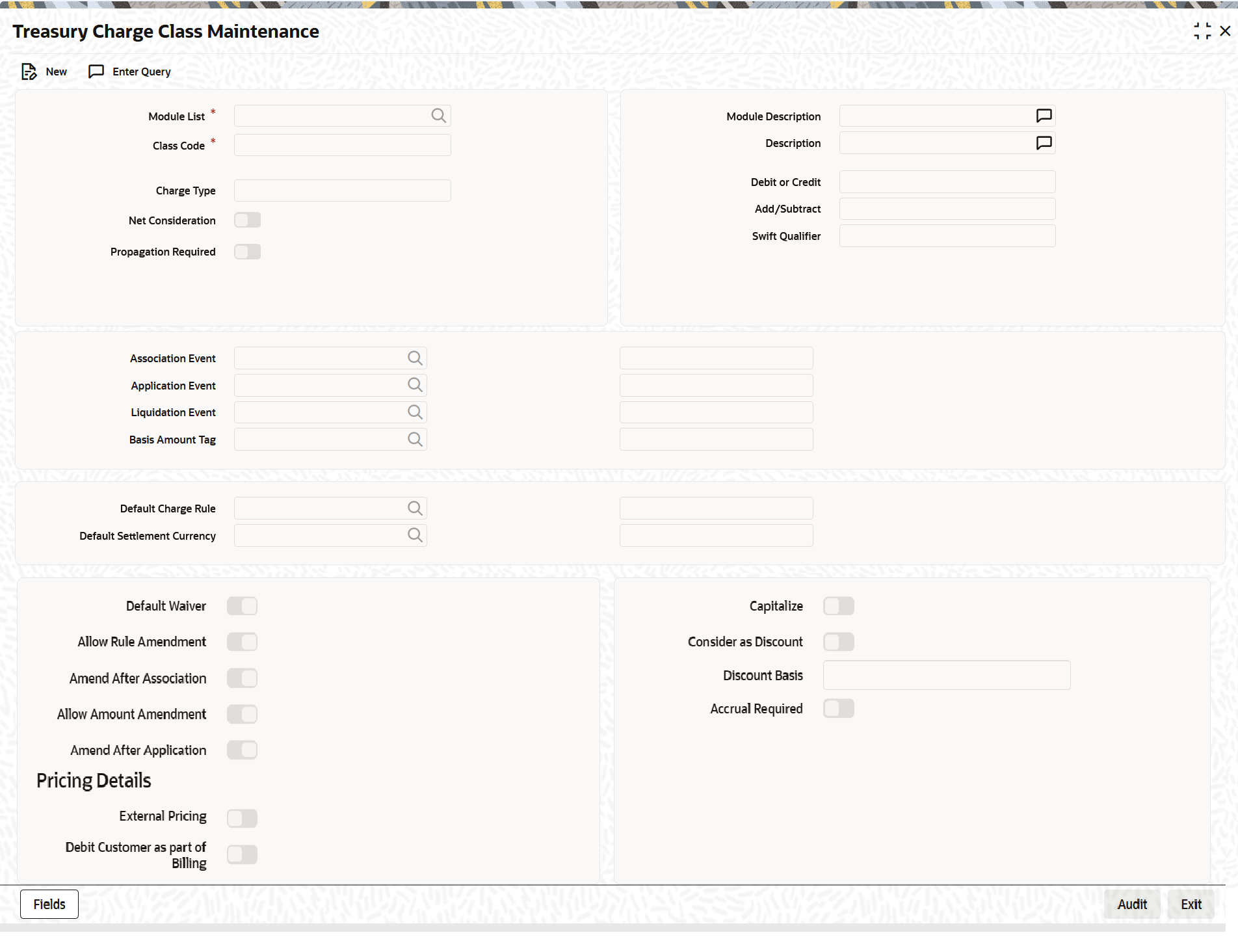

- On the Homepage, enter CFDTRCCM in the text field and then click the next arrow.The Treasury Charge Class Maintenance screen is displayed.
Figure 1-3 Treasury Charge Class Maintenance
Description of "Figure 1-3 Treasury Charge Class Maintenance" - On the Treasury Charge Class Maintenance screen, specify the fields.For field details and description, refer to the below table.
Table 1-4 Field Description
Field Description Module List A charge class is built for use in a specific module. As a charge component would be applied on different basis amounts, in different modules. In the Letters of Credit module, for instance, you would apply a flat processing charge or fee on all LCs. In the Securities module, you could levy a flat charge or fee on portfolios that you maintain on behalf of a customer. The basis on which the component is applied is different, in these two cases.Note:
The Basis Amount Tags available would depend on the module for which you build the class.Class Code Before defining the attributes of a charge class, you should assign the class a unique identifier, called the Class Code and briefly describe the class. A description would help you easily identify the class.
