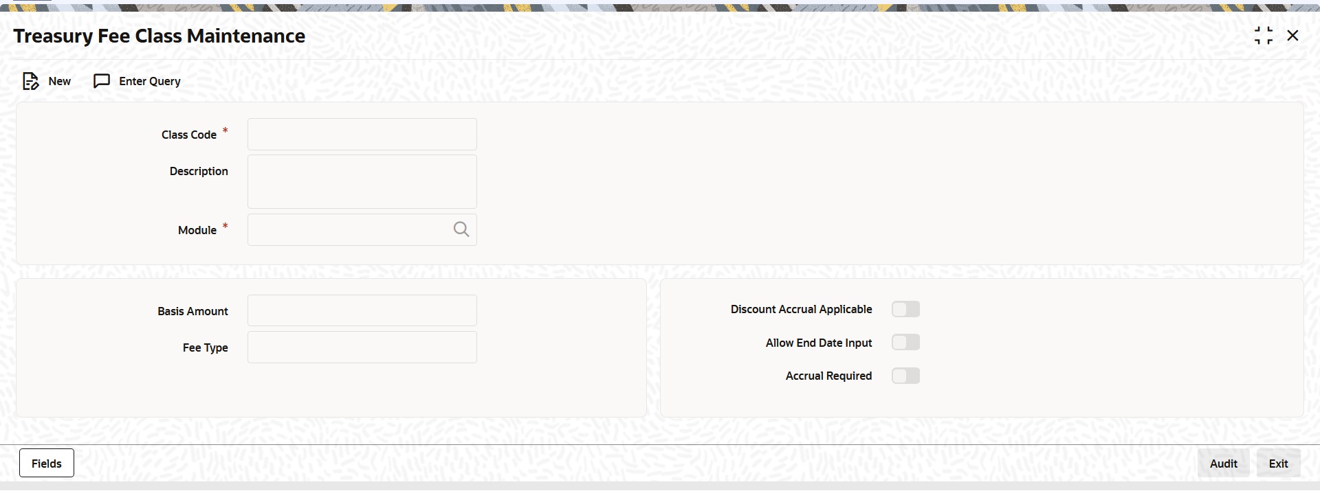

You need to define the attributes of an accrual fee class in the ‘Treasury Fee Class Maintenance’ screen, invoked from the Application Browser.
  1. On the Homepage, enter CFDTRAFC in the text field and then click the next arrow.
    The Treasury Fee Class Maintenance screen is displayed.
    Figure 1-4 Treasury Fee Class Maintenance
    Description of Figure 1-4 follows
    Description of "Figure 1-4 Treasury Fee Class Maintenance"
  2. On the Treasury Interest Class Definition screen, specify the fields.
