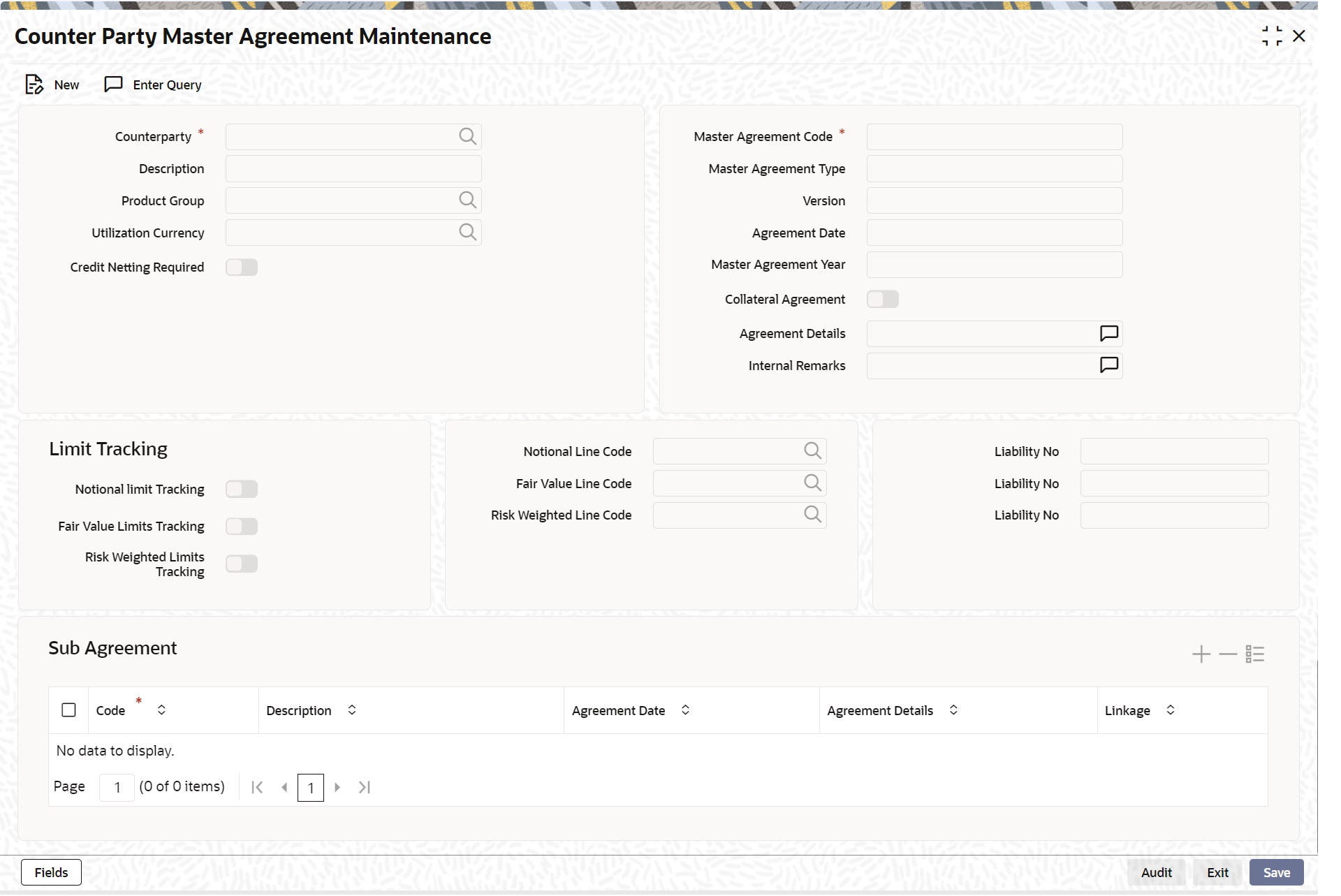

If you are maintaining details of a new master agreement, click the new icon. The Counterparty Master Agreement Maintenance screen will be displayed without any details.
If you are calling a master agreement record that has already been defined, choose the Summary option under Counterparty. From the Summary screen, double click a record of your choice to open it.
  1. On the Home page, type DVDCPMNT in the text box, and click next arrow.
    The Counter Party Master Agreement Maintenance screen is displayed.
    Figure 2-4 Counter Party Master Agreement Maintenance
    Description of Figure 2-4 follows
    Description of "Figure 2-4 Counter Party Master Agreement Maintenance"
  2. On Counter Party Master Agreement Maintenance, specify the fields, and click Ok. For more information on fields, refer to the below table.
