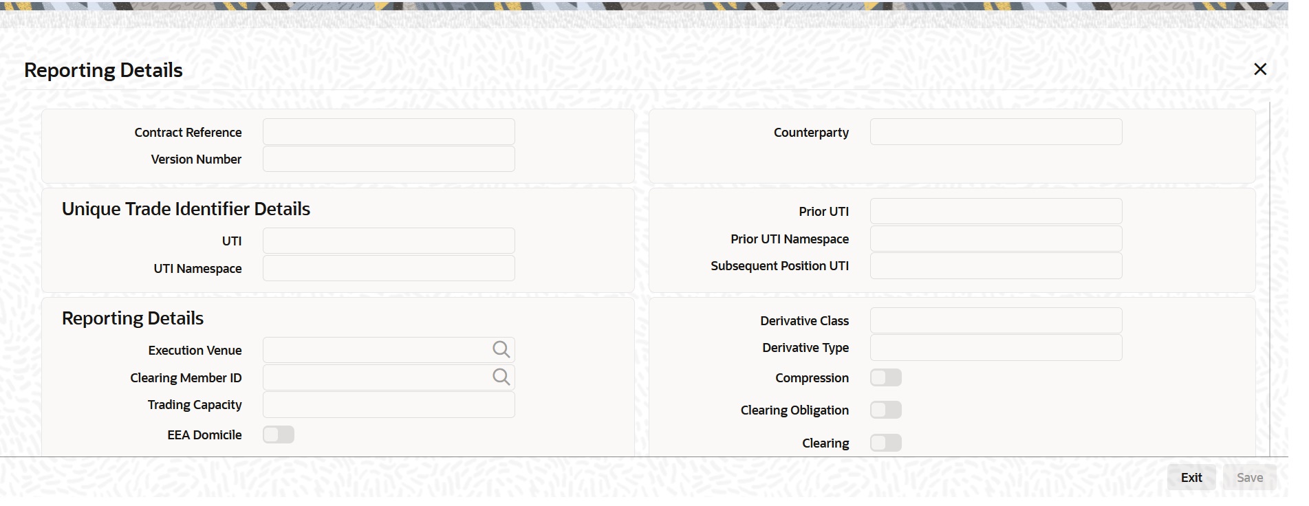

  1. On the Contract Input screen, click the Reporting Details tab.
    The Reporting Details screen is displayed.
  2. On the Reporting Details screen, specify the details as required, and click Ok.
    For more information on the fields, refer to the below table.
