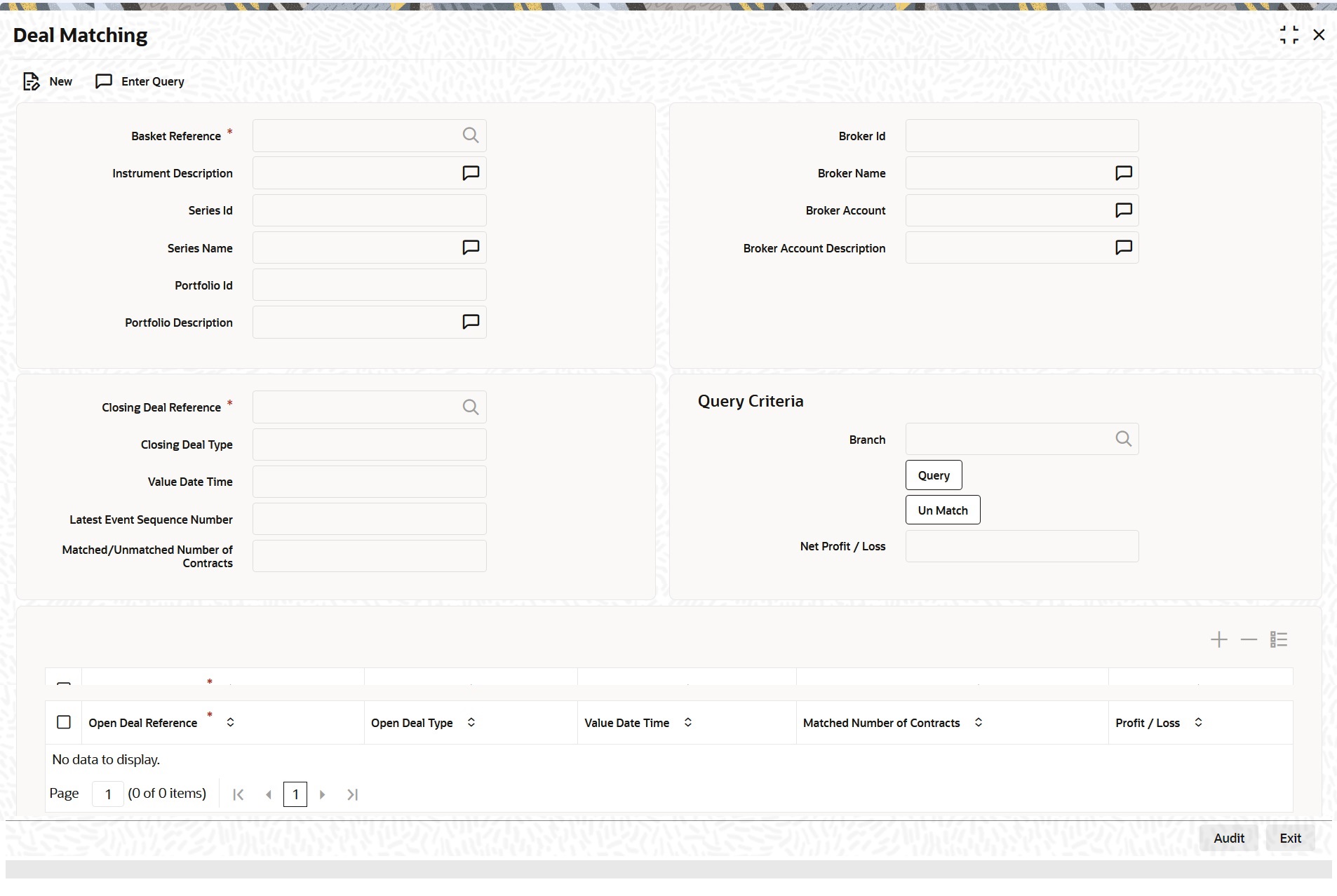

You can match deals for your bank’s own portfolios through the ETD module of Oracle Banking Treasury Management. If the portfolio from which you are buying or selling is priced using the Deal Matching methodology, you should identify the buy deal against which the sell/liquidation deal is to be matched. You can do this through the ‘Deal Matching’ screen of the ETD module.
- On the Home page, type EDDMATCH in the text box, and then click next arrow.
The Deal Matching is displayed.
- On the Deal Matching screen, click New.
- On the Deal Matching screen, specify the following Liquidation Deals, and then click Enter Query.
For more information on the fields, refer to the below Field Description table.

Field Description Basket Reference
In this screen, first you specify the Basket Reference for which you intend to do the Deal Matching. The Basket Reference number available in the option list is displayed based on the following criteria:
- The Portfolio involved in the basket should be your Bank’s own portfolio.
- The Baskets which are booked in the portfolios with either ‘Costing Method’ as DMAT or ‘Allow Deal Matching’ checkbox checked (toggled on) will be eligible for matching
- The Instrument involved in the Basket should be Futures, Future Style Options and Option Style Options deals.
You can select a valid Basket Reference Number from the available list. The other details involved in the Basket are displayed in the respective fields on saving your entries. These details include:
- Instrument ID
- Series ID
- Portfolio ID
- Broker ID
- Broker Account
Closing Deal Reference
After having specified the Basket Reference, you should indicate the closing deal reference number. The Closing Deal can either be a Long and Short type of a deal or can be an Exercise/Assignment Deal.
This closing deal has to be matched to one or more opening deals.
Also, the total number of contracts of the Closing Deal that should be matched should be equal to the number of contracts that you wish to close.
Open Deal Reference
Specify the number of deals for Opening Deals. The system will allow you to specify multiple Open Deal input against a single Closing Deal
Profit / Loss
The system will display the PL calculated for the matched pair of deals for each Open deal in the grid
Net Profit / Loss
The system will display the Net PL calculated across all open deals matched with the closing deal
