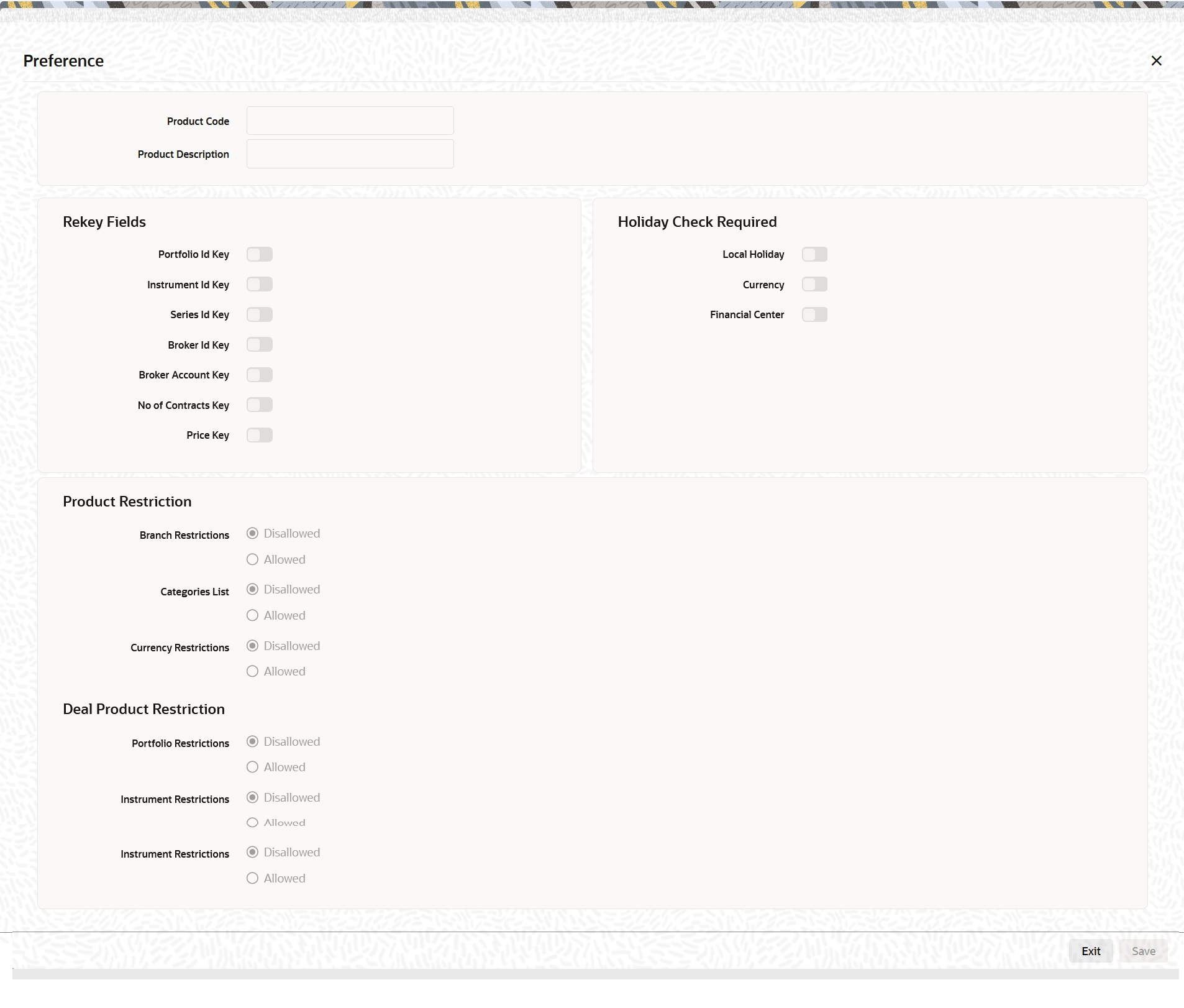

- On the Exchange Derivatives Deal Product Definition screen, click the Preferences tab.
The Preference screen is displayed.
- Specify the fields in the Preferences screen.
Table 6-2 Preference - Field Description
Field Description Product Code
System displays the product code.
Product Description
System displays the product code description.
Rey-key Fields
In Oracle Banking Treasury Management, all operations on a deal (input, amendment, modification, etc.) have to be authorized by a user other than the one who entered the deal details. These operations have to be carried out before the end-of-day activities have begun. Authorization is a way of checking the entries made by a user.
Indicate that details of certain fields should be re-entered when a deal is invoked for authorization. The complete details of the deal is displayed only after the values to these fields are entered. The fields for which the values have to be given are called the Re-key fields.
You can specify any or all of the following as re-key fields:
- Broker Account
- Instrument ID
- Portfolio ID
- Series ID
- Broker ID
- Number of Contracts
- Price
If no re-key fields are defined, the details of the deal involving the product will be displayed immediately when the authorizer calls the deal for authorization. The re-key option also serves as a means of ensuring the accuracy of inputs.
Currency Restrictions
Indicate whether you want to create a list of allowed currencies or disallowed currencies by selecting one of the following options:
- Allowed
- Disallowed
Categories List
Indicate whether you want to create a list of allowed customers or disallowed customers by choosing one of the following options:
- Allowed
- Disallowed
- Allowed
- Disallowed
You can specify the authorization re-key fields through the Deal Product Preferences screen.
Local Holiday
Select this check box, to execute the local holiday validation of the date and movement of schedules.
Currency
Select this check box, to execute the currency holiday calendar validation of the dates and movement of schedules.
Financial Center
Select this check box, to execute the financial center holiday calendar validation of the dates and movement of schedules.
