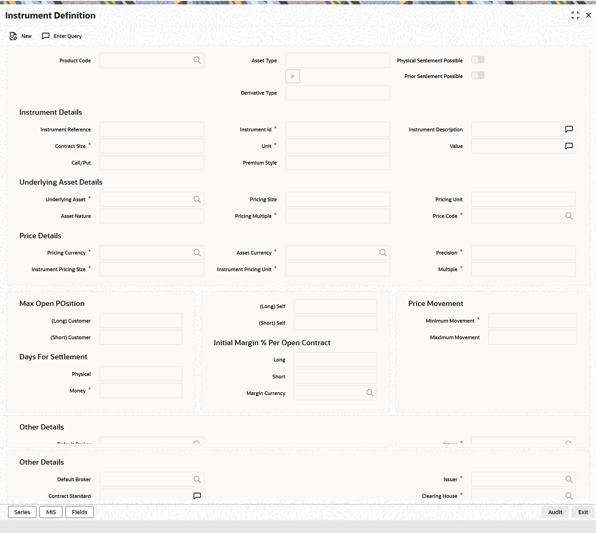

- On the Home page, type ENDUINST in the text box, and then click next arrow.
The Instrument Definition screen is displayed.
All ET instruments must be designated at inception either as Future or as Option instruments. At the time of product definition, you would have indicated whether the product being defined is meant for future instruments or options. When you associate an instrument with a product, the specifications you made for the instrument product default to the instrument. You will not be allowed to change the defaulted specifications.
- On the Instrument Definition screen, under Instrument Details section, specify the fields.
For more information on the fields, refer to the below table.

- On the Instrument Definition screen, under Underlying Asset details section, specify the fields.
For more information on the fields, refer to below Field Description table.

- On the Instrument Definition screen, under Price Details section, specify the fields.

- On the Instrument Definition screen, specify the following price movement details.

- On the Instrument Definition screen, under Maximum Open Positions Detailssection, specify the fields.

- On the Instrument Definition screen, under Day for Settlement section, specify the fields.

- On the Instrument Definition screen, under Other Details section, specify the fields.
For more information on the fields, refer to the below Field Description table.

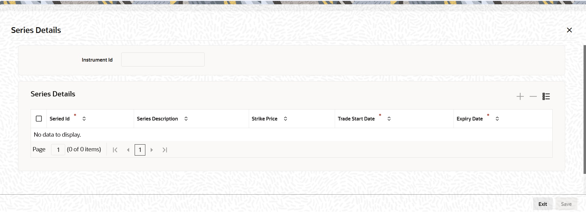

Each time the exchange introduces a new series for the instrument, the instrument maintenance record should be unlocked and the details of the new series captured.
- On the Series Details screen, specify the fields.
Table 4-11 Instrument Series - Field Description
Field Description Series ID To identify the series, you need to assign a unique 16 character code to the series. After you associate a code with the series, you have to capture a brief description of the series. This description will be associated with the series for information retrieval purposes.
Strike Price While capturing the details of an option instrument, you need to indicate the price at which the option buyer can purchase the asset for a call option or sell the asset in the case of a put option.
The Strike Price is specified in terms of the Pricing Size and Unit maintained for the Instrument. Therefore, it is multiplied by the instrument pricing multiple to arrive at the contract value.
Trade Start Date and Expiry Date You can indicate the time period for which the series can be traded in the market by specifying the following:
- Trade Start Date
- Expiry Date
The Trade Date is the first date on which the series can be traded in the market. The value dates of deals involving the particular series cannot be earlier than the Trade Date.
The Expiry Date is the date on which the series expires. The value dates of any of the deals involving the series cannot be later than the expiry date. The automatic Expiry/Exercise liquidation of all open positions for a series is done as part of the End of Day activities on the expiry date of the series.
A single instrument can have multiple series attached to it. At a given point in time multiple series of the same instrument can be traded simultaneously depending on the expiration months for each series.
