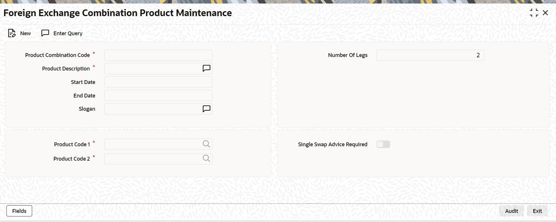

3.4.2 Foreign Exchange Combination Product Maintenance
- On the Home page, type FXDPRDCO in the text box, and click next arrow.
The Foreign Exchange Combination Product Maintenance screen is displayed.
Figure 3-5 Foreign Exchange Combination Product Maintenance
Description of "Figure 3-5 Foreign Exchange Combination Product Maintenance" - On the Foreign Exchange Combination Product Maintenance screen, click New
- On the New tab, specify the details as per requirement.
For more information on fields, refer to the below table.
Table 3-4 Foreign Exchange Combination Product Maintenance - Field Description
