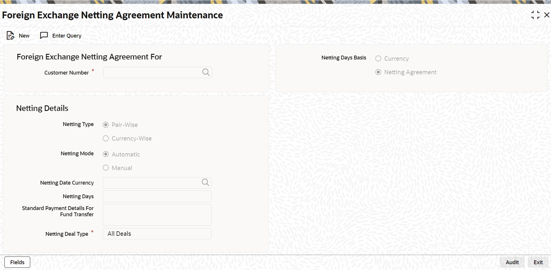

2.7.2 Maintain Netting Details
Enter the netting agreement with the counterparty concerned using the Foreign Exchange Netting Agreement Maintenance screen, to net the foreign exchange deals.
- On the Home page, type FXDNETMA in the text box, and click next arrow.
The Foreign Exchange Netting Agreement Maintenance screen is displayed.
Figure 2-8 Foreign Exchange Netting Agreement Maintenance
Description of "Figure 2-8 Foreign Exchange Netting Agreement Maintenance " - On the Foreign Exchange Netting Agreement Maintenance screen, click New.
- On the Foreign Exchange Netting Agreement Maintenance - New, specify the fields as per the requirement.
- Click Save to save the details or click Cancel.
For information on the fields, refer to the below table.
