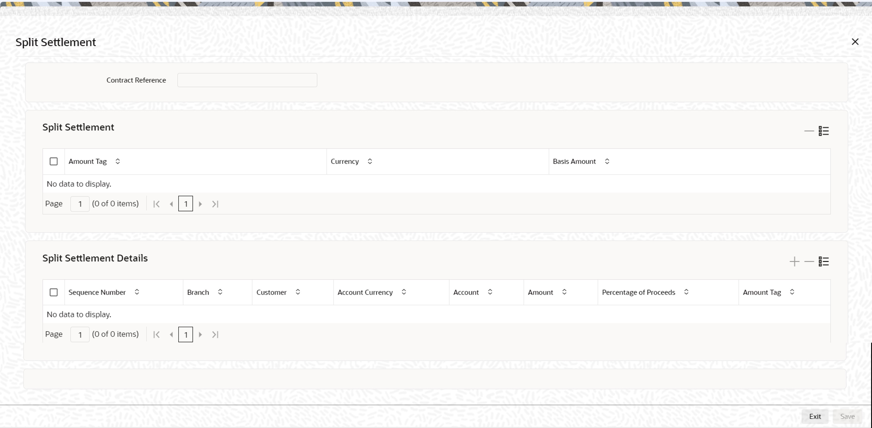

- On the Foreign Exchange Contract Input screen, click Split.
Split Settlement screen is displayed.
Figure 5-16 Split Settlement

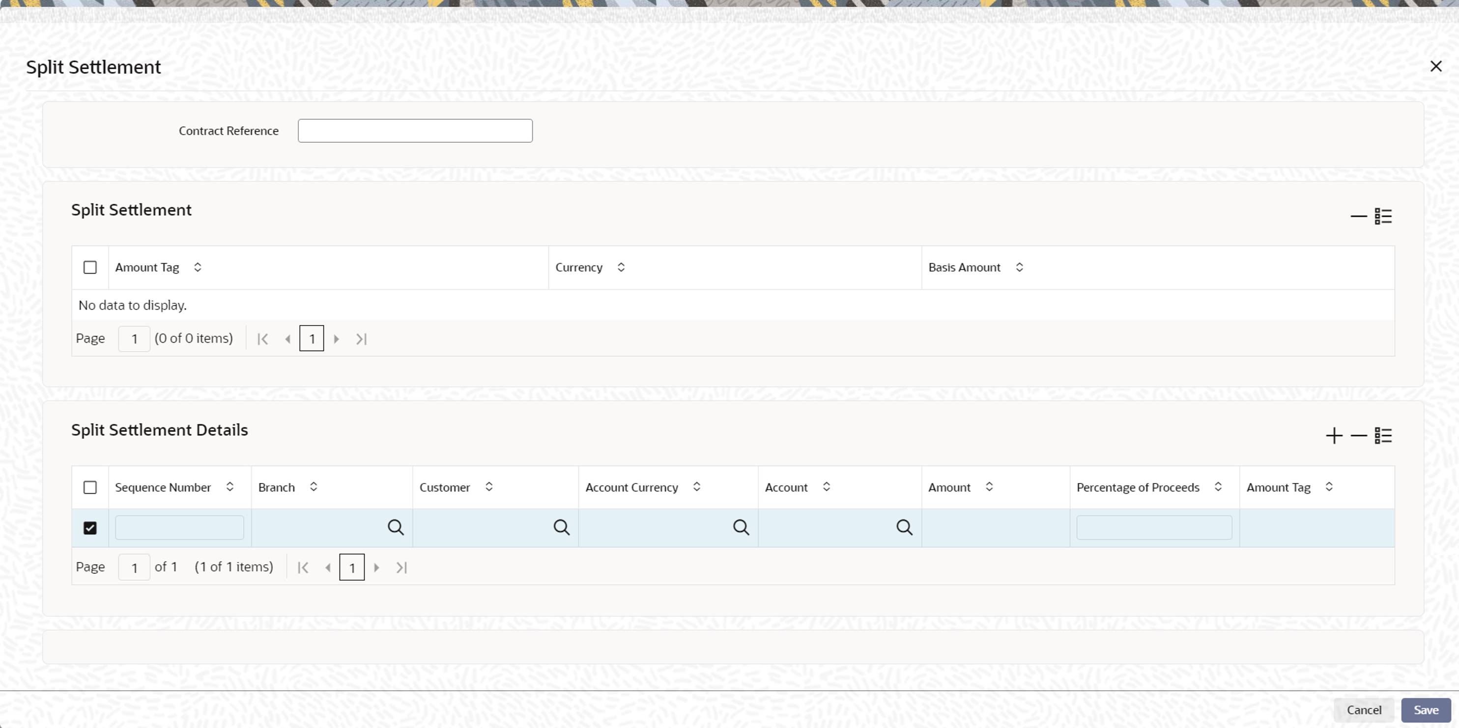

Description of the illustration splitsettlements.jpg - On the Split Settlement screen, under the Split Settlement Details, click the + Icon.Split Settlement with New Row is displayed.
Figure 5-17 Split Settlement with a new row
Description of "Figure 5-17 Split Settlement with a new row"Note:
This process of splitting the settlements for a contract is allowed on the principal, Interest (anticipated Interest for new contracts), and charges. - Select the Account Currency, Account, and other necessary details, to create a
split.
