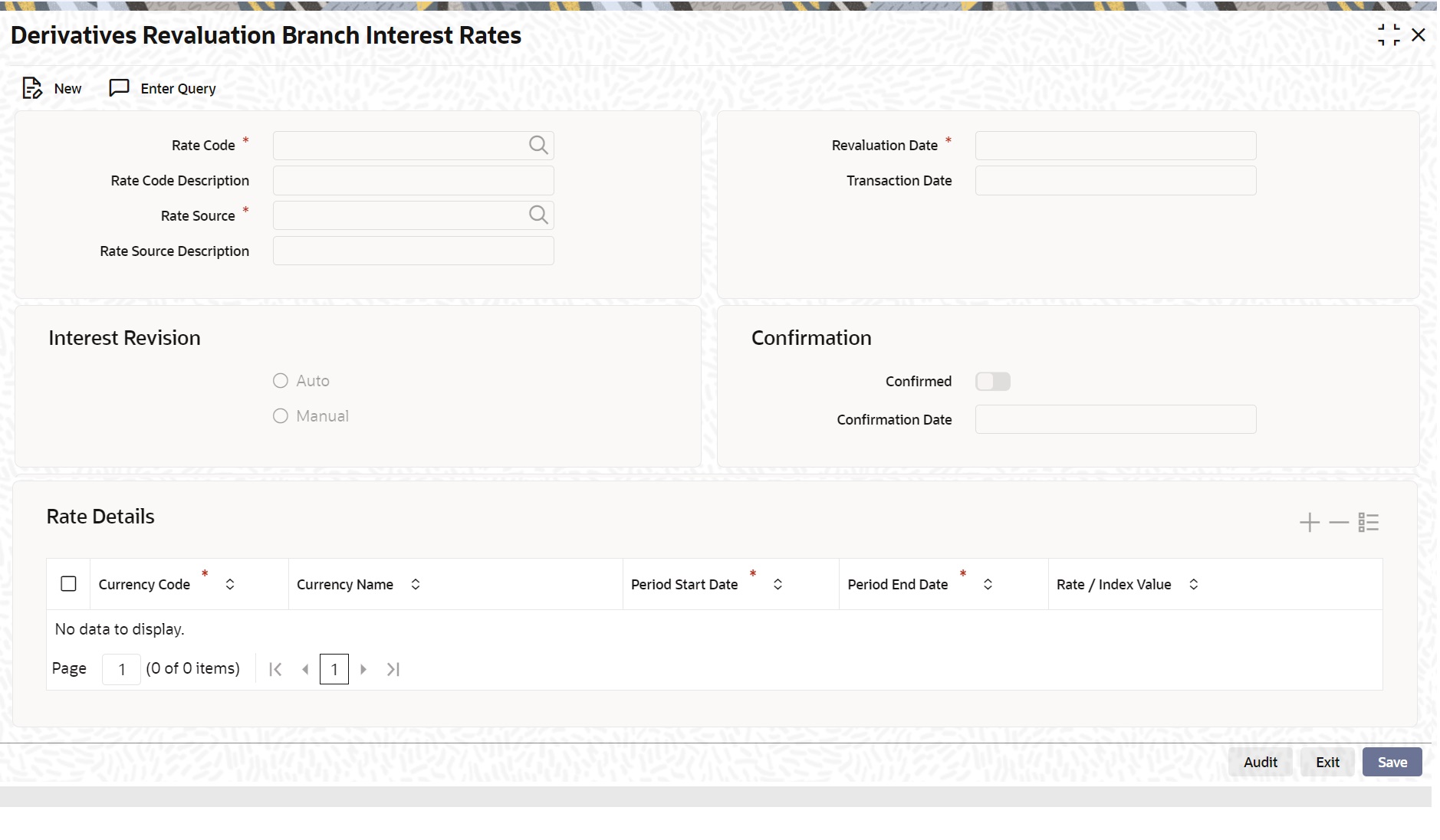

  1. On the Homepage, type DVDBRRAT in the text box, and click next arrow.
    The Derivatives Revaluation Branch Interest Rates screen is displayed.
    The advantage in maintaining branch-wise profit rates is that when there are multiple contracts which require the same rate(s) for processing revaluation (the tenor and currency combination should be the same) the BOD function identifies all the required rates and inserts a single record into this screen.
    Figure 3-3 Derivatives Revaluation Branch Interest Rates
    Branch interest rates
  2. On the Actions menu, click New icon.
    You can maintain details of new profit rate for your branch.
    The Branch Profit Rates Maintenance screen is displayed without any details.
    Table 3-2 Derivatives Revaluation Branch Interest Rates
    Field Description
    Rate Code and Rate Source
    If you are maintaining the details of a new profit rate for your branch you have to indicate the rate code that is to be associated with the profit rate. You can identify a valid code from the list of rate codes available. Subsequently you also have to indicate the source to which the rate code belongs.
    When you indicate the codes linked to the rate code and source the description assigned to them is defaulted in the adjacent fields.
    This field is mandatory.
    Revaluation Date
    Select the Revaluation Date by clicking the calendar icon.
    All those contracts, which should be revalued as per the profit rates maintained at the branch level, will be revalued as of the revaluation date. While maintaining details of a new profit rate you have to indicate the date based on which contracts should be revalued.
    Profit Revision
    Click either Auto or Manual. The system revises profit rates automatically when the daily batch for derivatives is run using the Branch specific Profit rate revaluation method.
    This field is optional.
    Confirmation
    Select the Confirmation check box to confirm that the profit rate entered is correct. The current system date is displayed in the Date field once you select the check box.
    Note: If you leave this box unchecked then this record will not be taken up for revaluation processing.
    Rate Details
    The system identifies the currency and tenor of forward rates required for each revaluation date, on the Revaluation Date only those contracts with the particular Rate Code, Rate Source and Currency combination will be considered for revaluation.
    Currency Code
    Choose the currency in which you want to maintain the Profit Rate.
    Note: Once you select the Currency Code, the currency description is displayed automatically in the Currency Description field.
    Period Start and End Date
    Specify the start and end dates for the interest rate you are defining.
    Profit Rate
    Specify the profit rate for the particular rate code. The profit rate that you specify here is meant for your branch and is used to determine the Fair Value of all those contracts for which you have indicated that branch level profit rates are to be used for revaluation.
    Revaluation is done for only those contracts with the particular Rate Code, Rate Source and Currency combination for the particular Revaluation Date.
    To define a new forward profit rate for a specific profit period, click add button from the screen and enter the relevant details. To delete an existing rate, highlight the rate and click on delete button from the screen.
