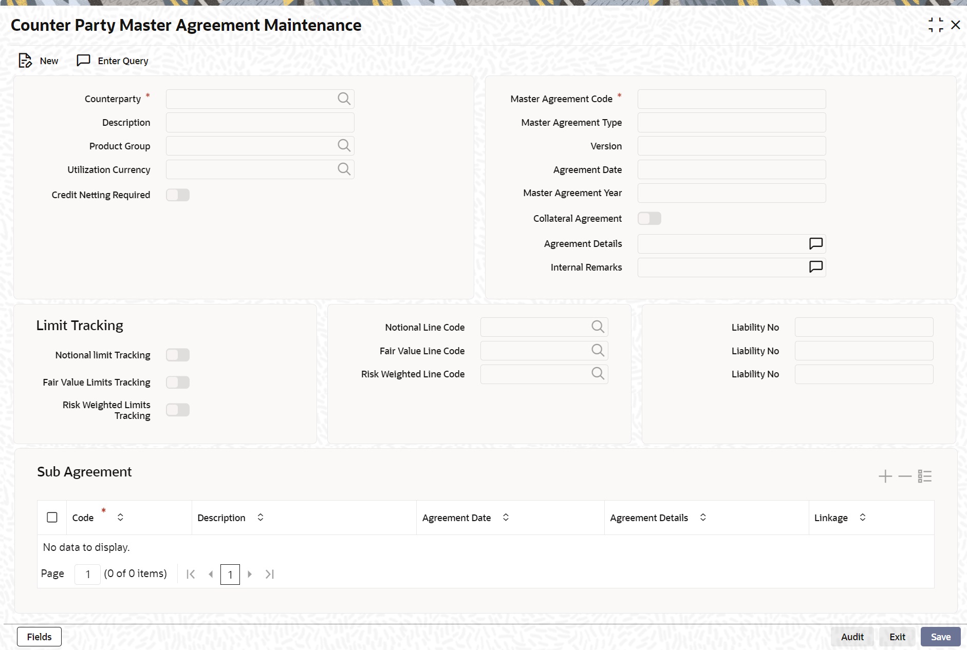

If you are maintaining details of a new master agreement, click the new icon. The Counterparty Master Agreement Maintenance screen will be displayed without any details.
If you are calling a master agreement record that has already been defined, choose the Summary option under Counterparty. From the Summary screen, double click a record of your choice to open it.
- On the Home page, type DVDCPMNT in the text box, and click next arrow.
The Counter Party Master Agreement Maintenance screen is displayed.
Figure 1-4 Counter Party Master Agreement Maintenance
Description of "Figure 1-4 Counter Party Master Agreement Maintenance" - On Counter Party Master Agreement Maintenance, specify the fields, and click Ok. For more information on fields, refer to the below table.
