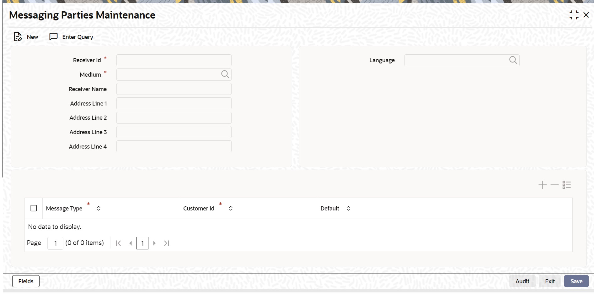

  1. On the Home page, type DVDMGMNT in the text box, and click next arrow.
    The Messaging Parties Maintenance is displayed.
    Figure 1-6 Messaging Parties Maintenance
    Description of Figure 1-6 follows
    Description of "Figure 1-6 Messaging Parties Maintenance"
  2. Select New from the Actions menu in the Application toolbar or click the new icon to maintain details of a new receiver on behalf of the counterparty,
  3. On the Messaging Parties Maintenance screen, specify the fields. For more information of fields, refer to field description table.

    Receiver Id
    This is the code assigned to the receiver of the message. Specify a unique code to identify the receiver of the message.
    Medium
    Choose the medium through which you wish to send the message. This can be any of the following:
    • Mail
    • Telex
    • Fax
    • SWIFT
    Receiver Name
    Indicates the name of the receiver of the message. Specify the name of the party who will receive the message on behalf of the customer.
    Address
    While maintaining the messaging party details, it is required to indicate the mailing address of the receiver of the message. All the messages addressed to the counterparty is directed to the receiver address that you specify.
    During contract input, when you indicate the ID of the receiver, the default address specified for the receiver is displayed.
    Note: If you specify that the message should be sent through SWIFT, then you have to indicate the SWIFT address of the receiver in the first line of the address box before you specify the mailing address.
    Language
    The message can be sent to the receiver in the language of the receiver. This adjoining option list displays a list of language codes. You can choose the appropriate one available in this field.
    Note: Remember that to send a message to a receiver in a particular language, you must have also maintained a message format for the language in the Advice Format Maintenance screen.
